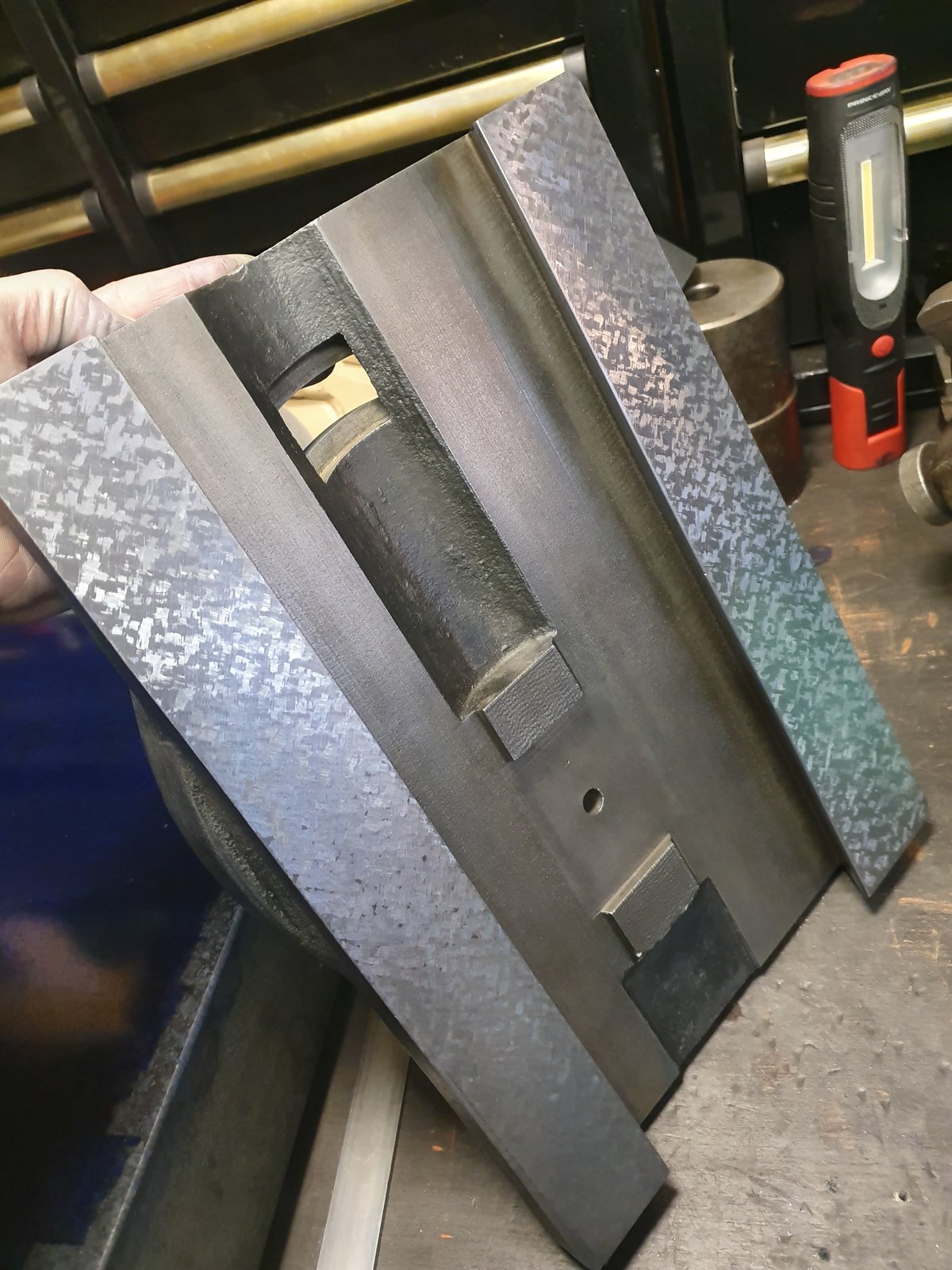

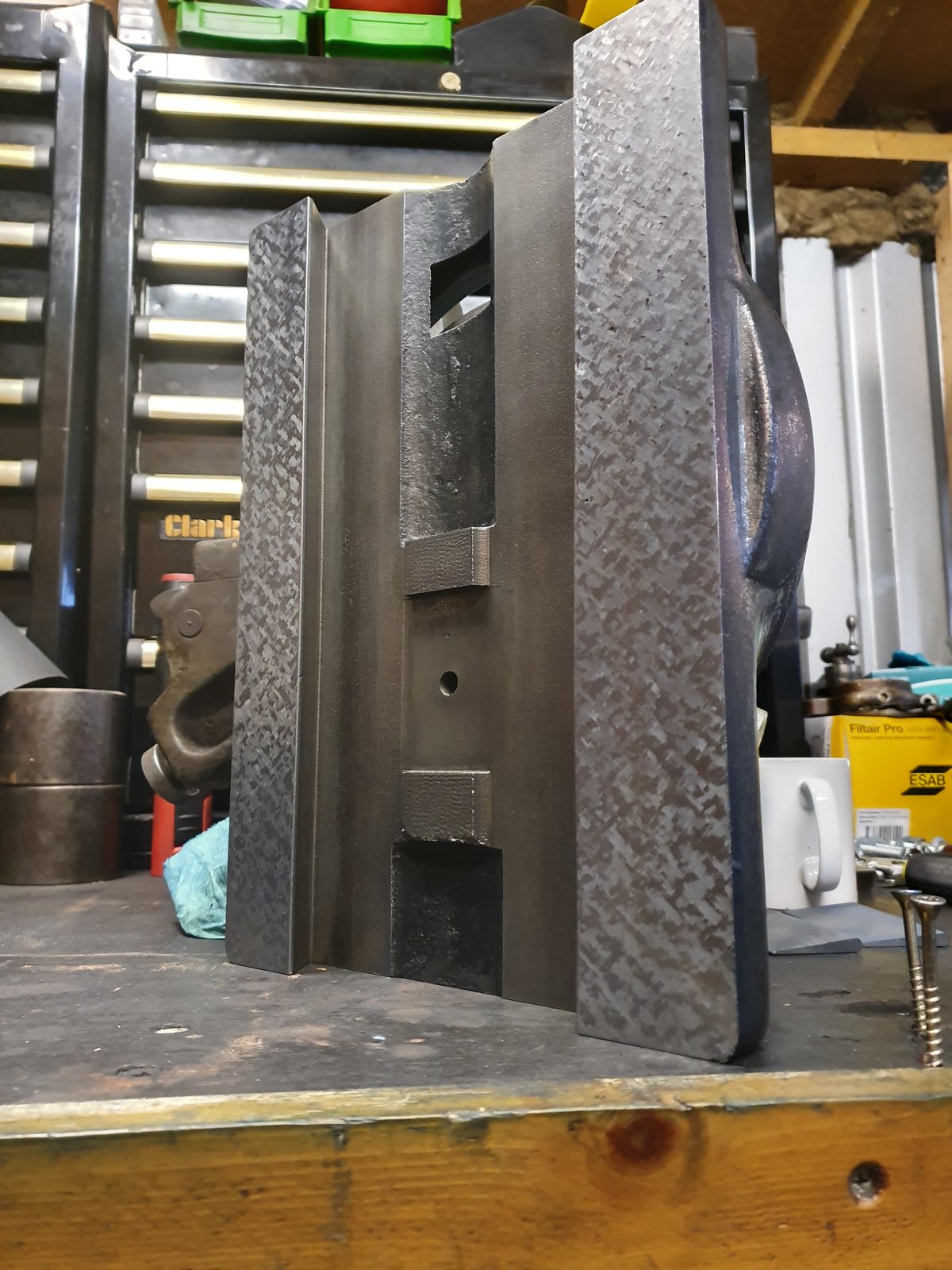

Its 11 inches across. It's a hard drop of iron for sure. It's a lot better than it was definitely.

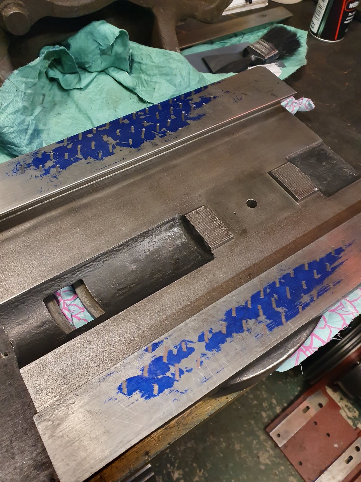

Well it won't wobble that's for sure. What is it 7" diameter? Usually you'd like to see a bit more contact especially on a 'static' part but it'll do the job just fine and it's a lot better than the usual 'touches in 3 places' you normally get. Looks like hard iron I bet that wasn't much fun to scrape.
. Scrappers that is
