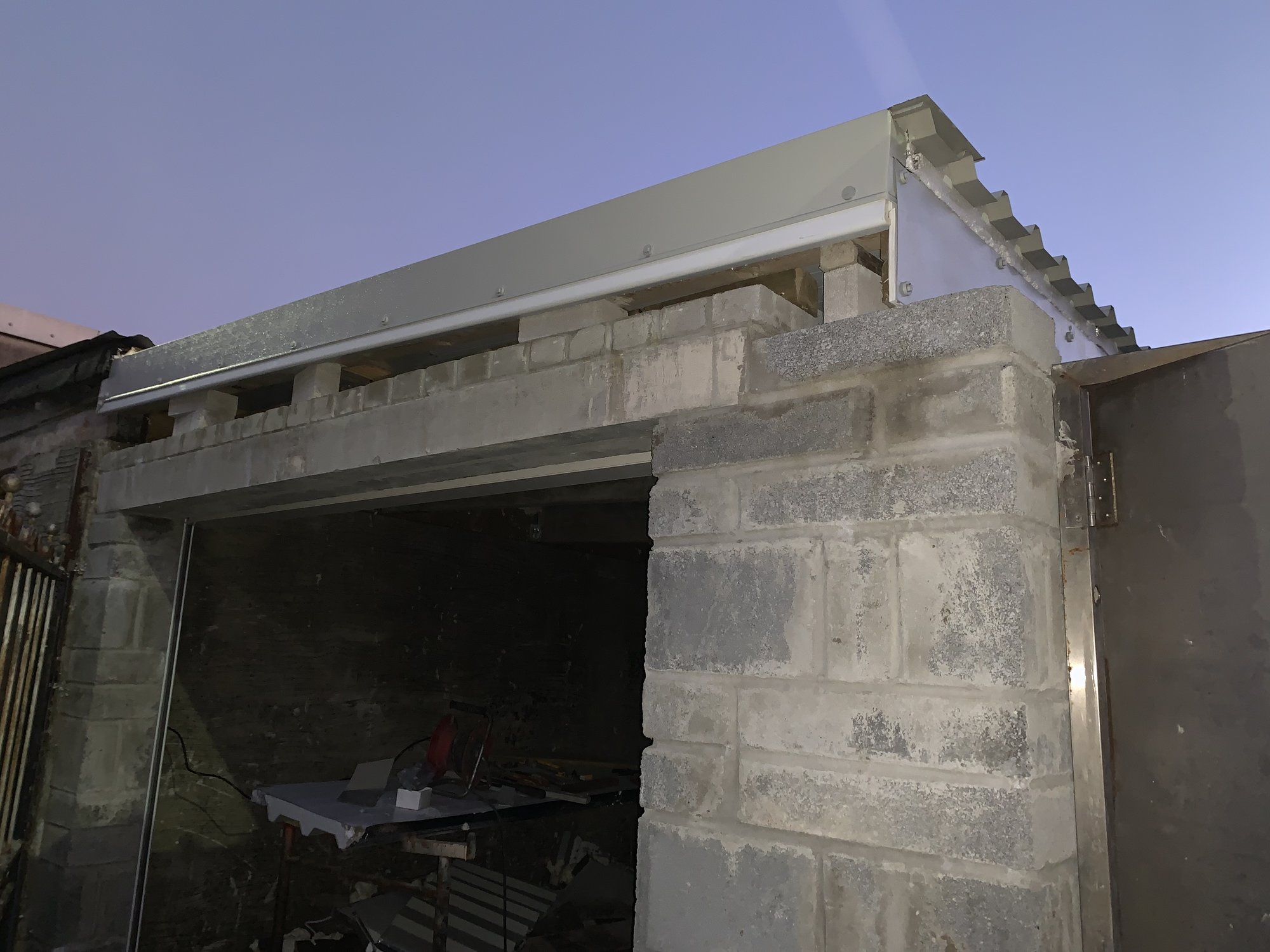

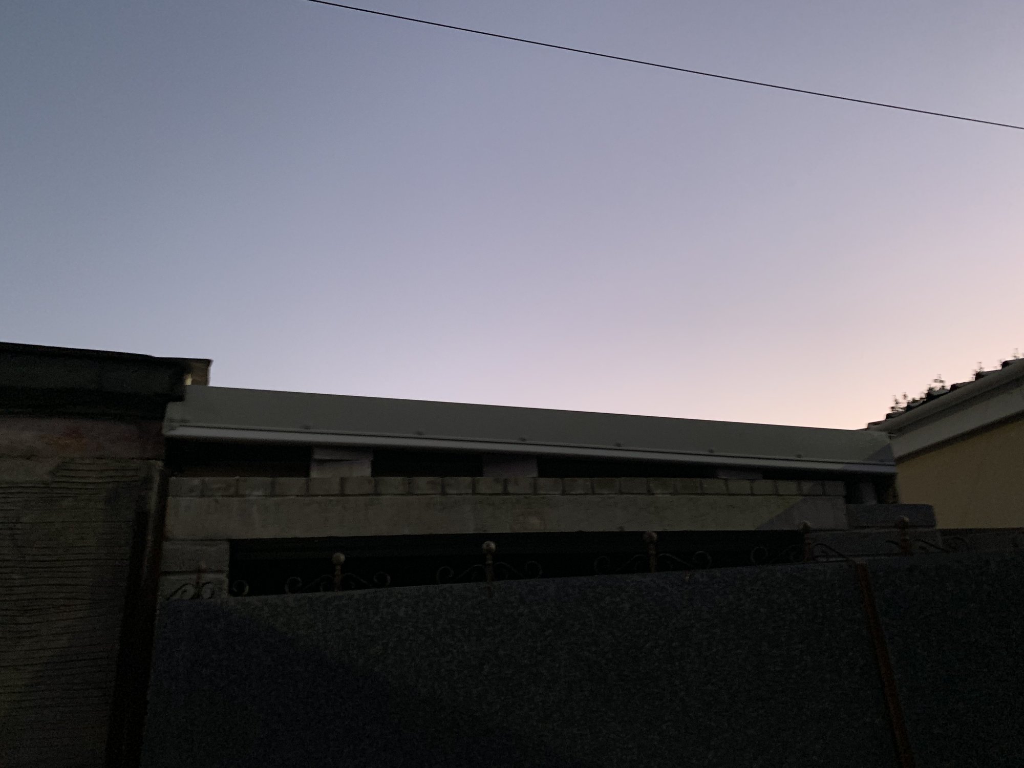

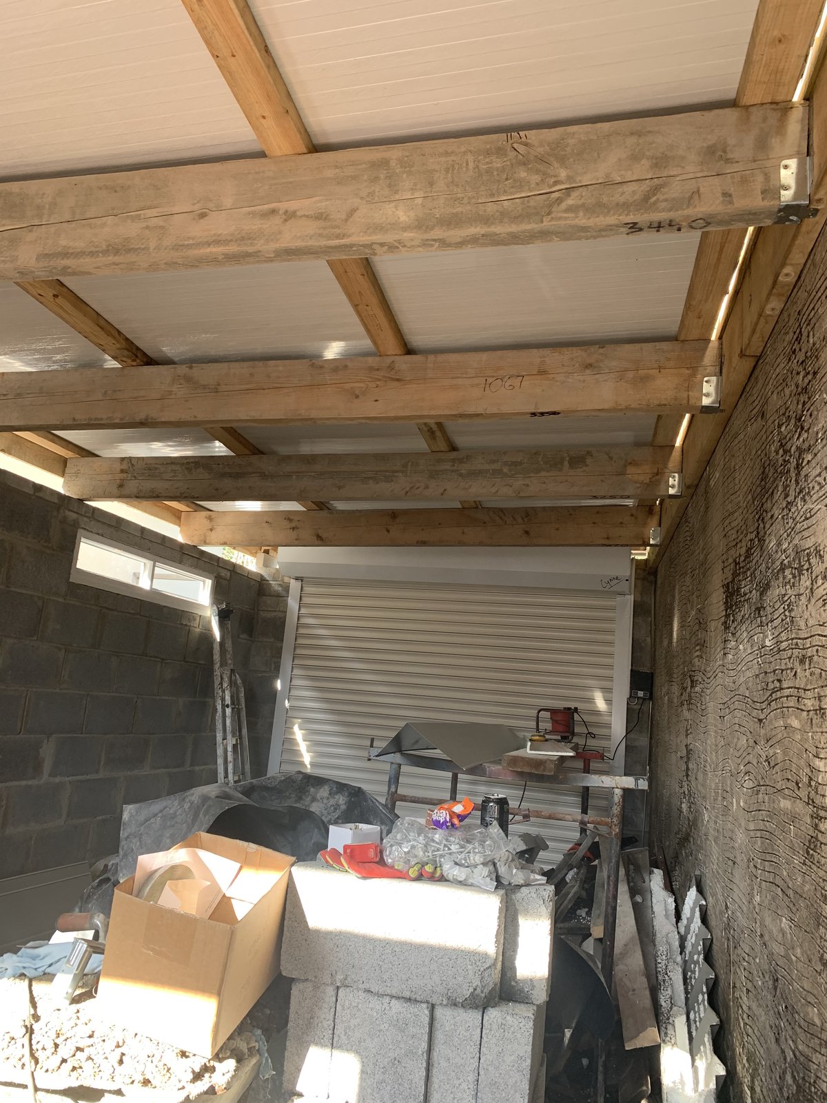

Are you planning on getting it wind & water tight after your next trip away?
also to note you have cut your beams level with your wall when you shouldnt have done
your going to need to put a spacer in, on each beam so when you fit the facia board it goes under the beams and drips off below the wood beams if you fit a plastic fascia board as it stands now it can rot your beam ends
note 1" below your beam
are you putting on cement render up the wall ?
