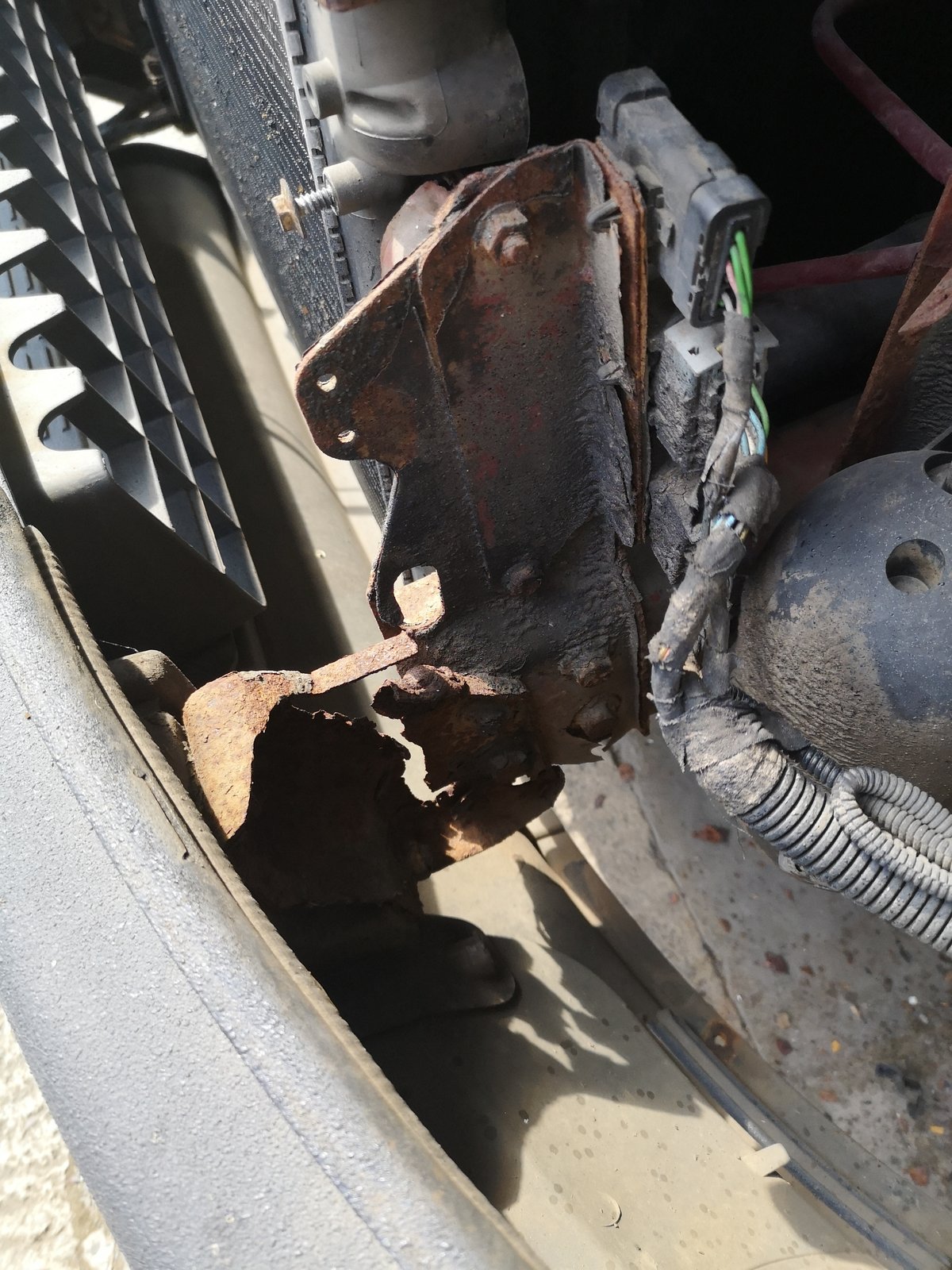

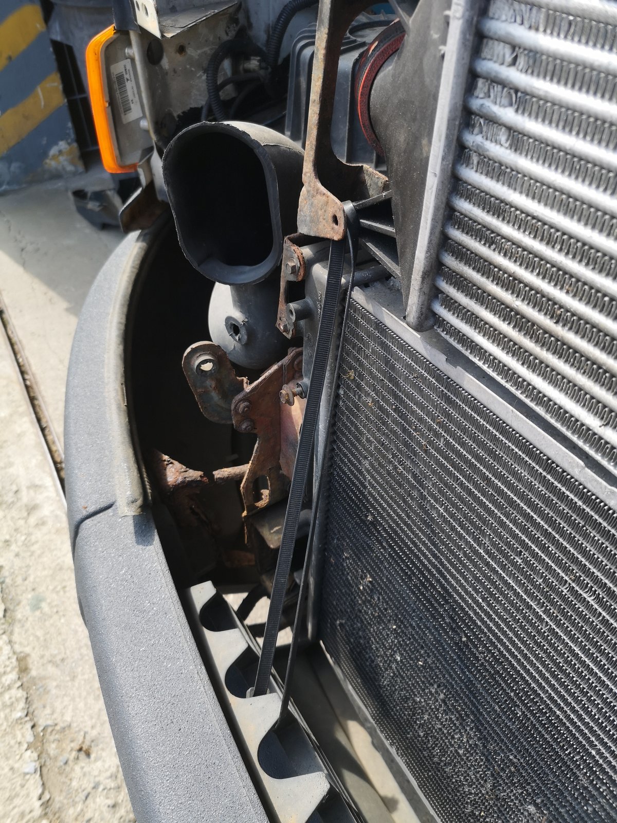

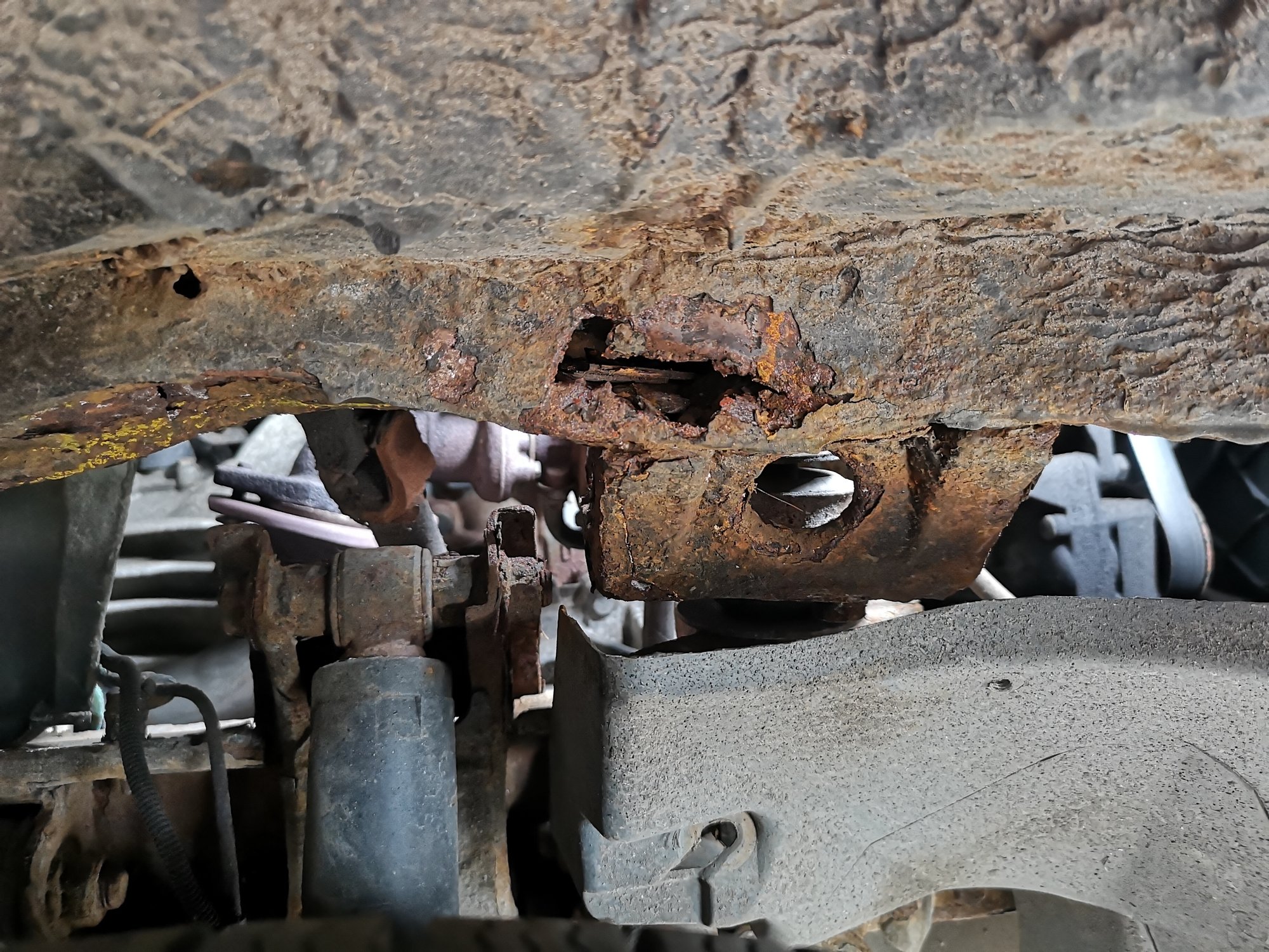

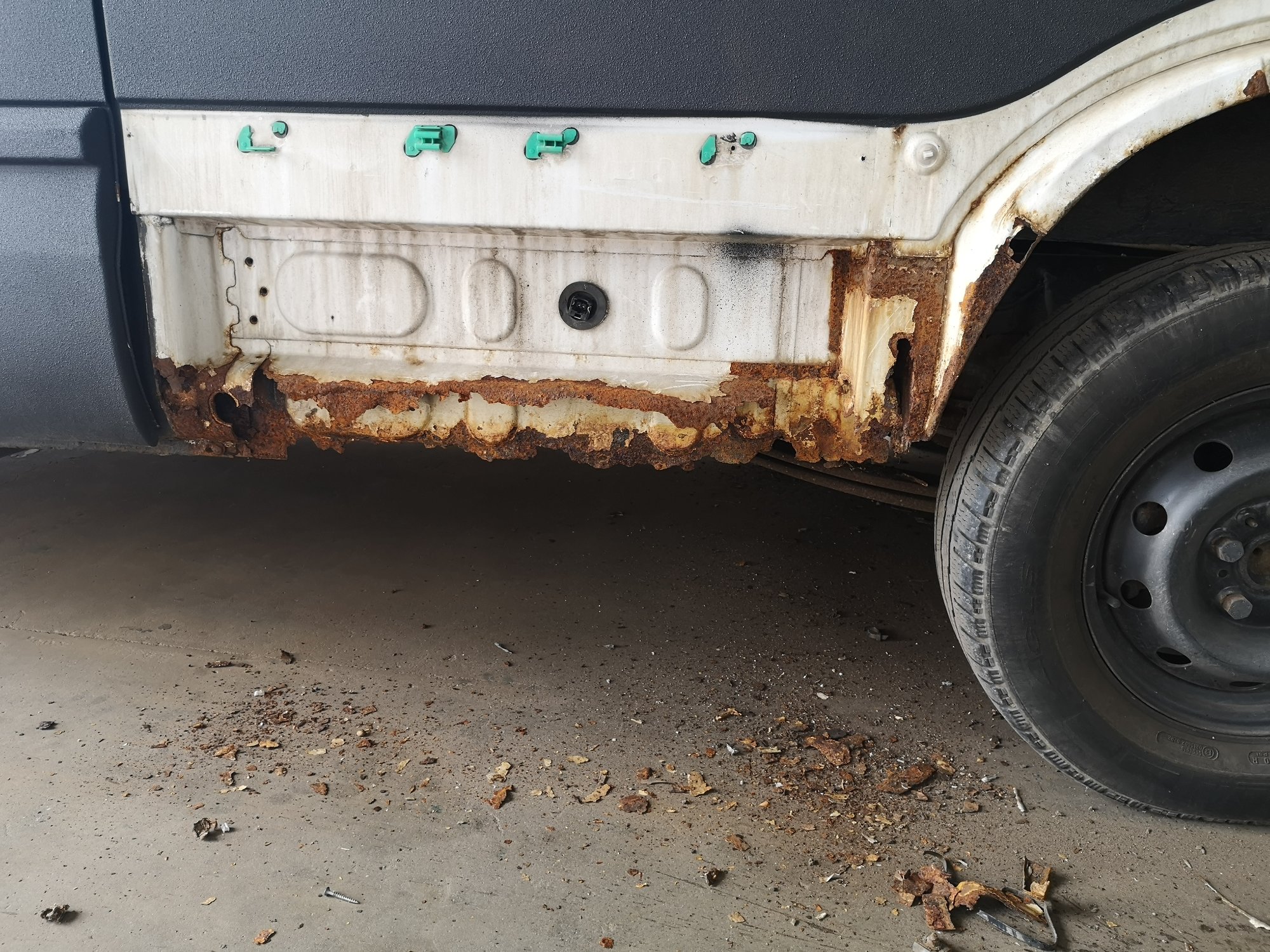

Do cable ties with a dash of hopes and dreams count as a bumper mounting?Take the front bumper off too, I did an escort van a few years back and when the bumper was removed there was hardly any good metal left
Engine is on 123k and I drive it back from Glasgow, aside from being a thirsty and a slight whine from the rear diff, she drives lovely.

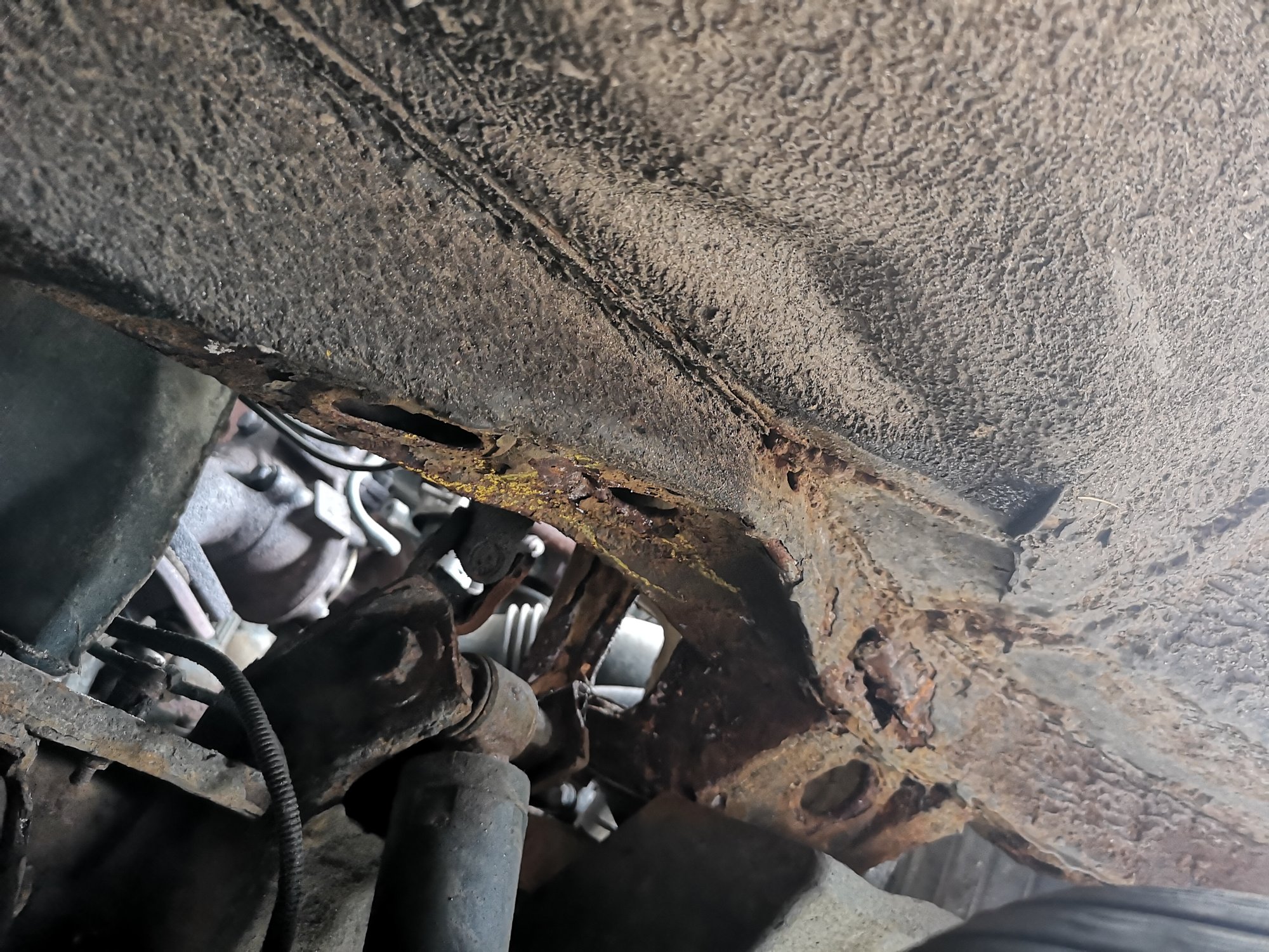

I'm guessing I need to check for stuff like this
View attachment 227816 View attachment 227817
Do cable ties with a dash of hopes and dreams count as a bumper mounting? View attachment 227844 View attachment 227845

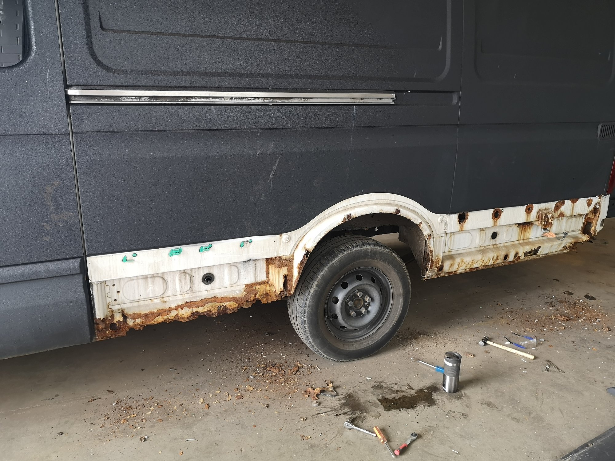

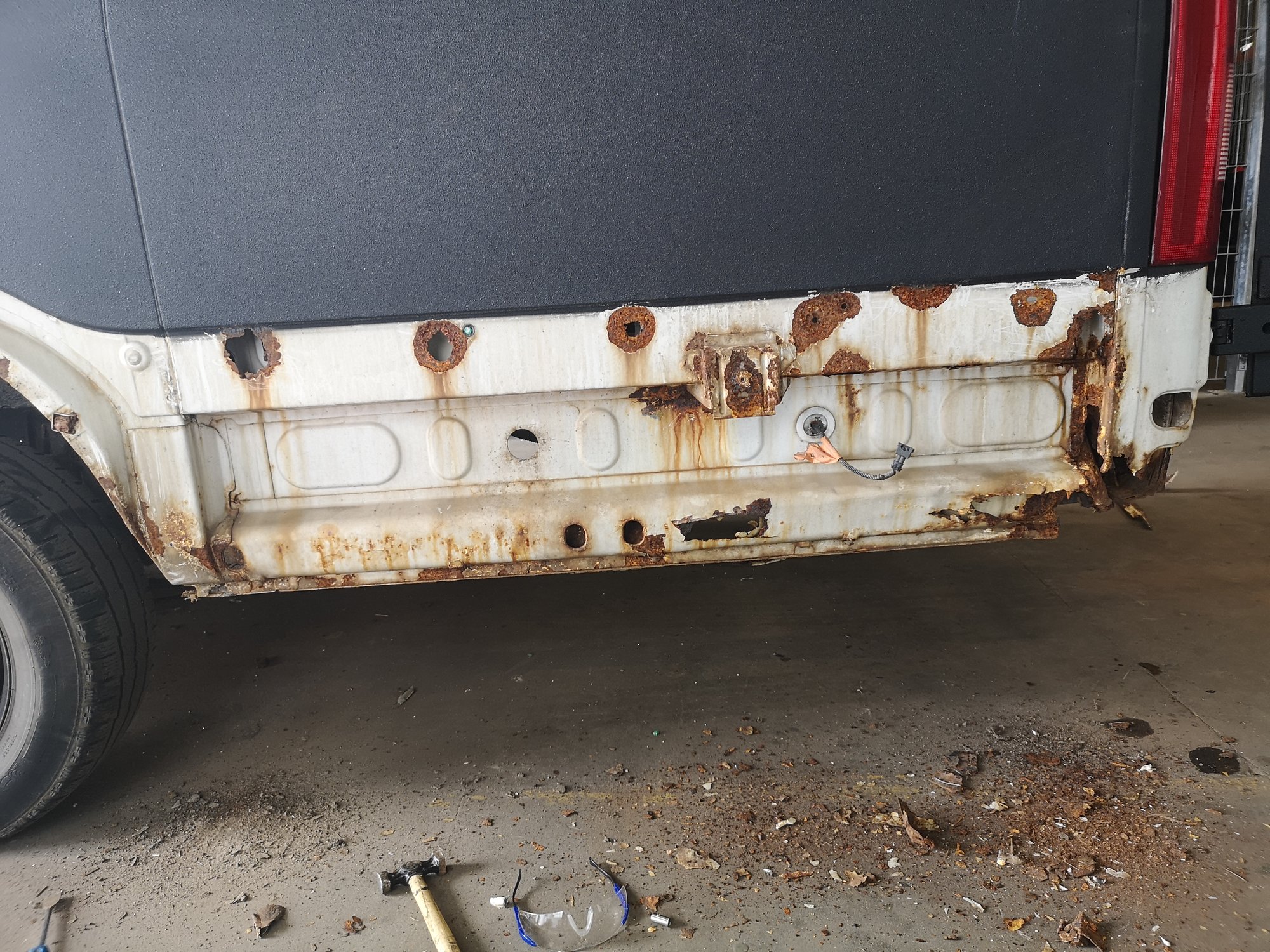

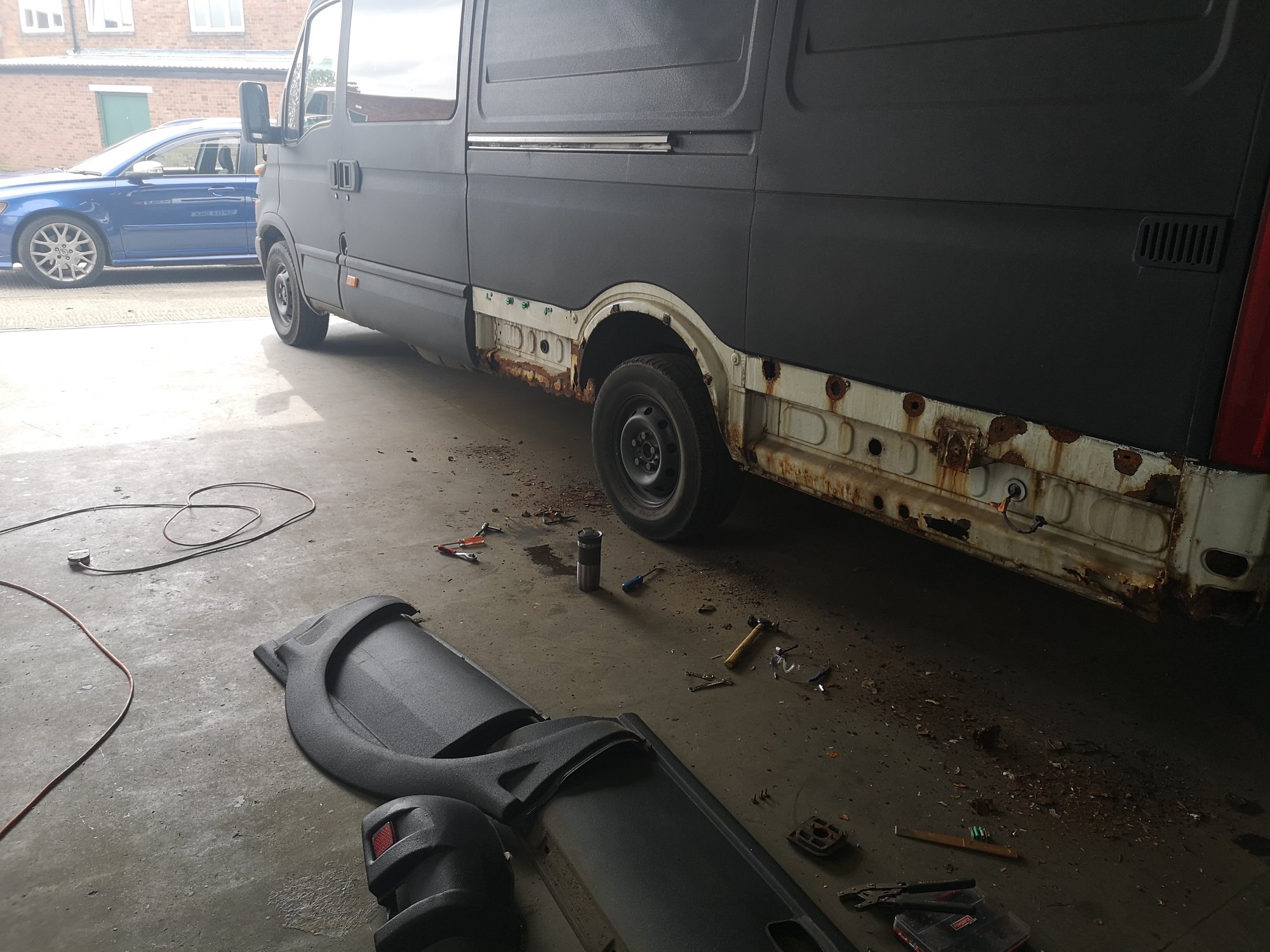

This rabbit hole gets deeper and deeper, I enjoy working and learning on the bodywork side of things but good lord is this bitch fighting me View attachment 227812 View attachment 227813 View attachment 227814 View attachment 227815
It seems unanimous, no one here would take this on?
To tell the truth guys, I can't afford another van. The money I put up for this was a good chunk of my budget as I had hoped it was a good base to work off, I'm dreading telling my missus that it needs scrapping
