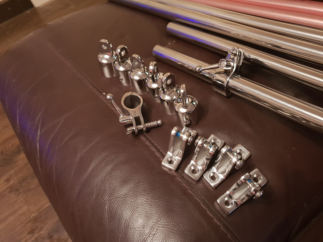

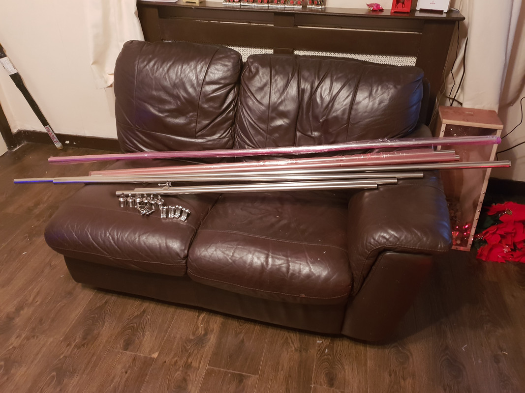

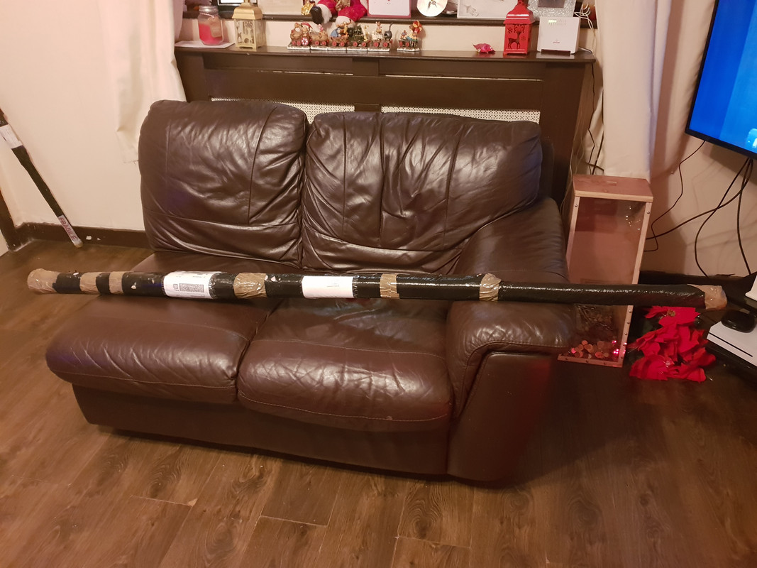

Got home tonight and some of the canopy has arrived. I used Seascrew for the bits for the frame. This is the first in a while i have bought something for the boat and feel good, although the price and what i am looking does not not look much for the money, hey but thats project boating
I will be ordering the Top Gun this week with all the rest of the fittings from Point north and Kyospruce.

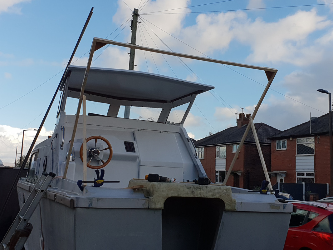

So top frame hoop is 25mm OD and that slides nicely ( 1.2mm wall ) over the lower frame legs of 22mmOD with a a pair of 22mm tube clamps to slide up the top hoop into position.
I have ordered a pair of preformed mandrel bent 25mm OD tubes and should be here this week. I will weld these up for the hoop corners.

A rough pic of whats to be done

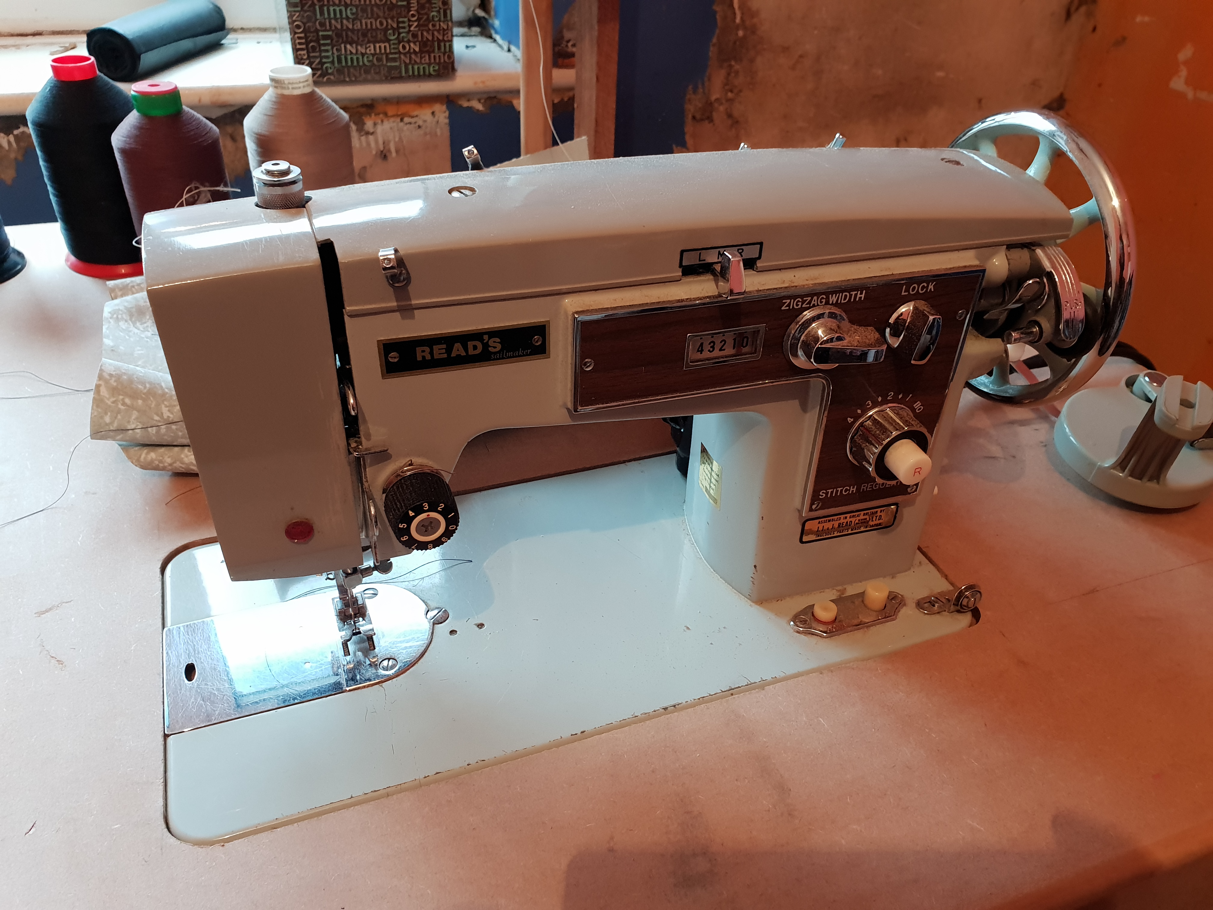

Off now to practice sewing a bit more i think, wish me luck![]()

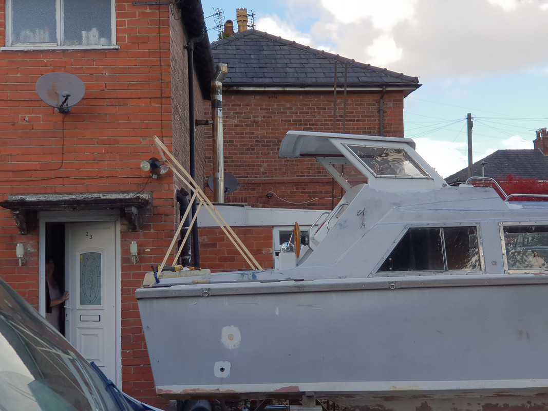

@W.olly I'm seriously impressed by your work, when do you hope to schedule the 'launch'?

)Wow, that Read's Sailmaker was a steal. I use an old US domestic machine for sails, but would really like one like that. Give me a buzz when you are finished and it is going spare
Nice SS bits too.
KF
( Oh, and get a move on, I need to make a set of sails before May...)
