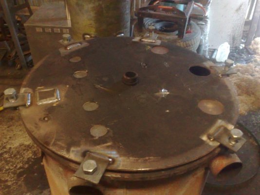

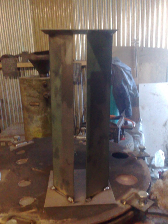

Looks like you may want a few baffles inside your heater to stop just the one side getting red hot.

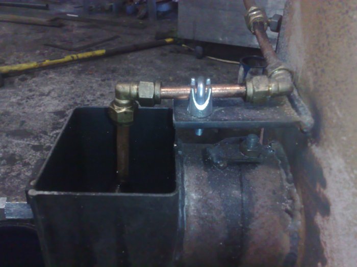

I'm already thinking of a steam engine and running my workshop from it.I'm going to fit solenoids to the oil and air lines connected to an optical sensor and controller I have from a home heating burner so if it goes out everything shuts off, just need to mount the sensor somewhere it won't melt.
