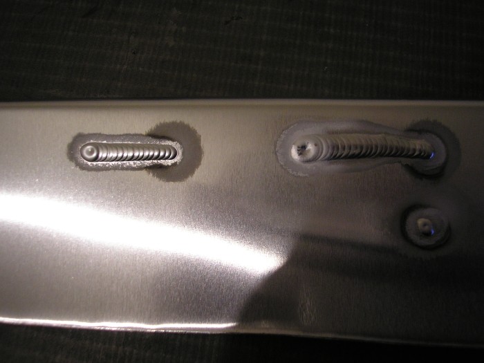

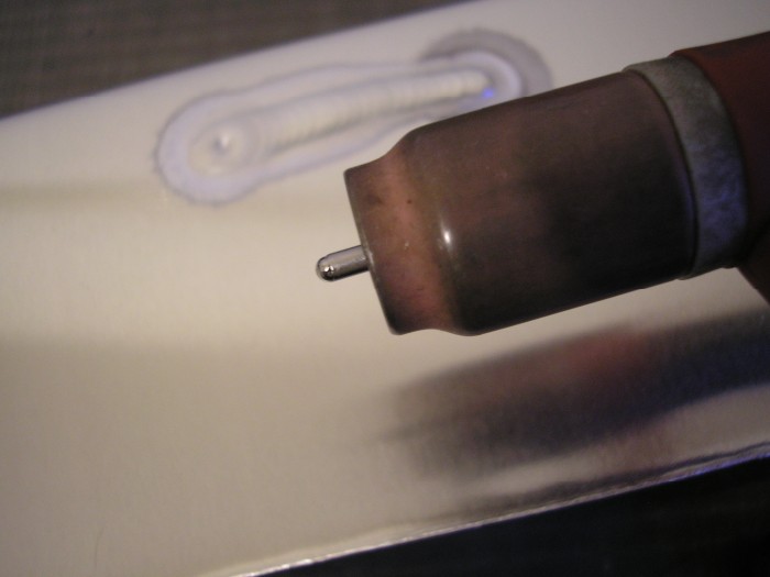

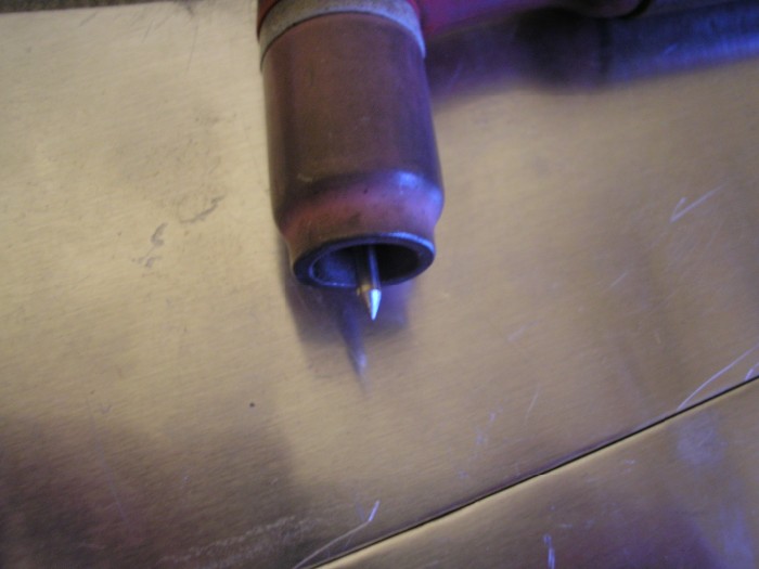

first two pics are tungsten before and after at 35% EN. Started counting after striking an arc, first 5 or 6 secs it was going nuts while the tungsten sorted itself out before stabilising enough to weld. Got to 13 before i had a weldpool that was stable and ready for some wire.

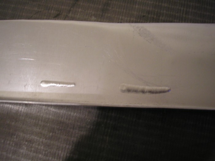

Front and back of beads. One on the left was @ 71%EN (i let the offcut cool back to ambient as it was a good excuse for a cuppa). Initially i tried to use the same tungsten but it wouldn't restrike, probably as the HF is set to min. You can see where the HF was going nuts. Changing HF settings is a bit of a ball ache so i swapped in another 2.4 prepped as in the first post. Weldpool took a couple secs to get going, much nicer and faster as you'd expect. Measuring across the toes the bead on the left ranges from 4-5mm while the one on the right is 7-9mm wide.

). Me managing to cast a shadow over part of the pic didn't help things but the bead on left is cleaner/brighter. I put that down to the time taken for the weld with lots of EP. Weld ally with too long of an arc length or too slowly and welds typically come out duller just as with stainless etc
