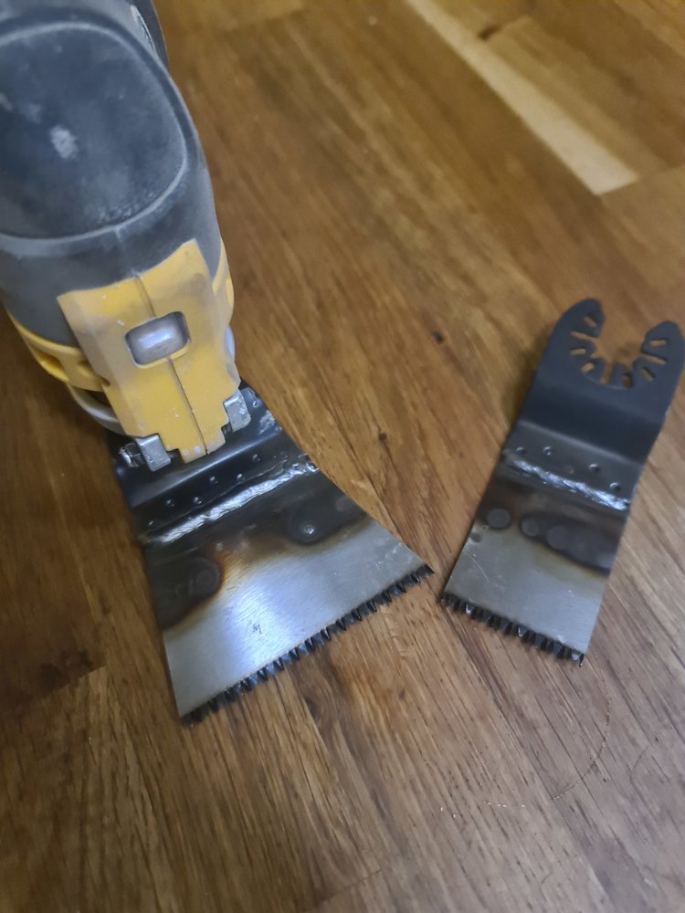

2nd attempt at this.
Sorted.
A seven quid panel saw from Wickes and knackered cheapo multi tool blades, two cuts with the grinder and a few seconds of welding.
Lap welded, full weld across the top tacks on the bottom ground flush.

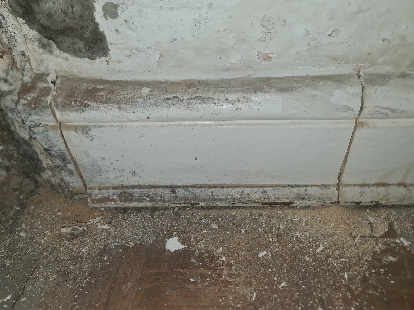

Skirting boards are done for.
