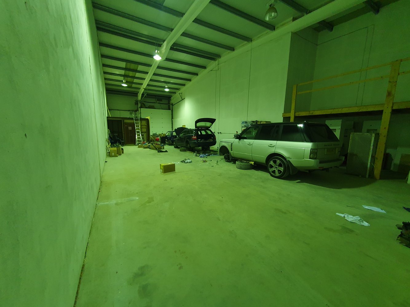

So today I received a 90 litre cabinet and tried out some shot on a couple of parts. The setup was simply just my 200 litre 3hp motor compressor with about 9-10CFM FAD. I used a 5mm tip.
It wasn't bad to be honest. Obviously the compressor cut in early and remained on unless I gave the blasting a break.
I would be happy that by adding extra capacity and the other 3HP motor that I would happily blast parts in the cabinet... keeping the duty cycle etc in mind.
Now, for the chassis / ladder frame chassis I was thinking of doing. I have concluded that it's probably most economical to rent out a large >100CFM unit.

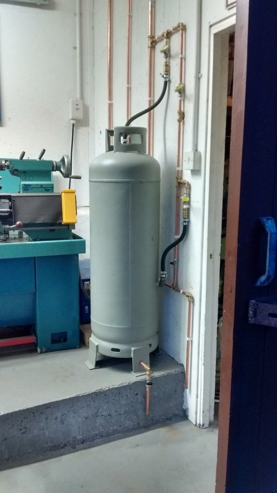

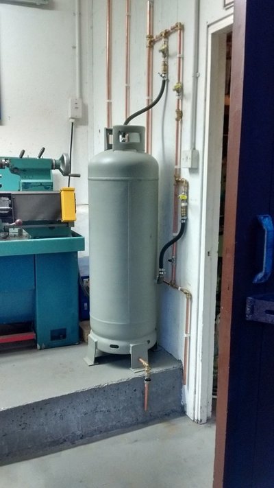

Ideally your line running to your filters should also be 1.5 times or more larger than the line out that feed the pressure pot or spray gun etc. Minimise restrictions in your airline. Pic of how I made my propane cylinder.

Sorry if its already been mentioned. Not sure if you still intend to use gas bottles, but if you are and don't want to weld fittings it is possible to set them up with a small tube to the bottom of the tank and have it come out through the centre of your fitting on the top to drain them.
Sorry don't remember specifics as it was a while ago, but sure I saw the idea on this forum.
I used 15 copper with a 10mm airline from the filter to spray gun but I really only spray paint. You should be looking at 22mm at least or larger I would think. Or large hose.Interesting yes. I was only thinking the other day that I will try and use something decent for the "ring main".. what size did you run?

I do intend on using and rather not weld the pressure vessel itself. I need to investigate what fittings I can use. To be honest, I would probably turn it upside down and support it by welding to the collars on top and bottom, and not the vessel itself.
If the guy can’t Tig weld just get someone to Tig weld on a couple of bosses. It‘s a 5min job so won’t cost much and the best solution. I washed and washed my bottle out with soapy water and bi-carb as I use it for my air fed mask, there was no smell so it can be flushed out.Here is a thread with a bit of info and photo of what I was trying to describe.
