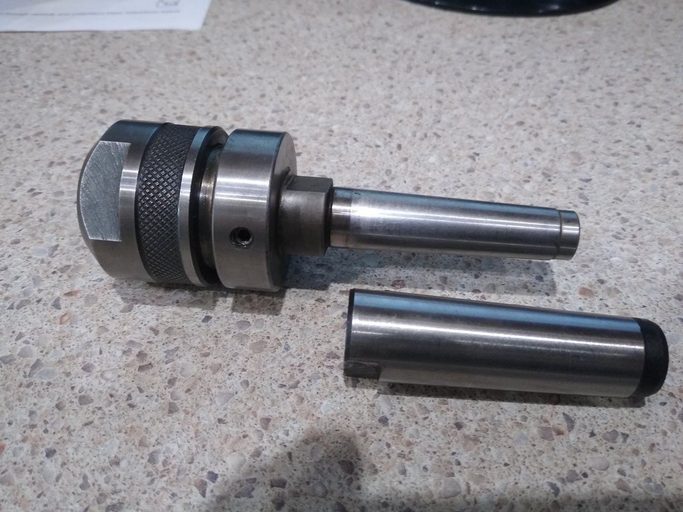

I bought an used milling machine last weekend, I have never used one before, messing about with it today I fitted the collet chuck in the spindle but it is a MT2 and the spindle is MT3. The machine came with lots of bits including the collet chuck and a MT2 to MT3 taper adapter which I used.
I know you can already see what's coming next
After making some chips I loosened the drawbar and the chuck came out fine but the 2 to 3 adaptor didn't. first I thought a thicker bar down the spindle hole to drift it out but the spindle bore is smaller than the adaptor, then I thought about a tapered wedge in the spindle side hole but the adaptor doesn't come up that far. Luckily I slid a round headed bolt up through the adapter to sit on its top edge and slid another bolt up alongside it to stop it slipping off then drifted out the adaptor. How is the adapter supposed to be removed from the spindle?
