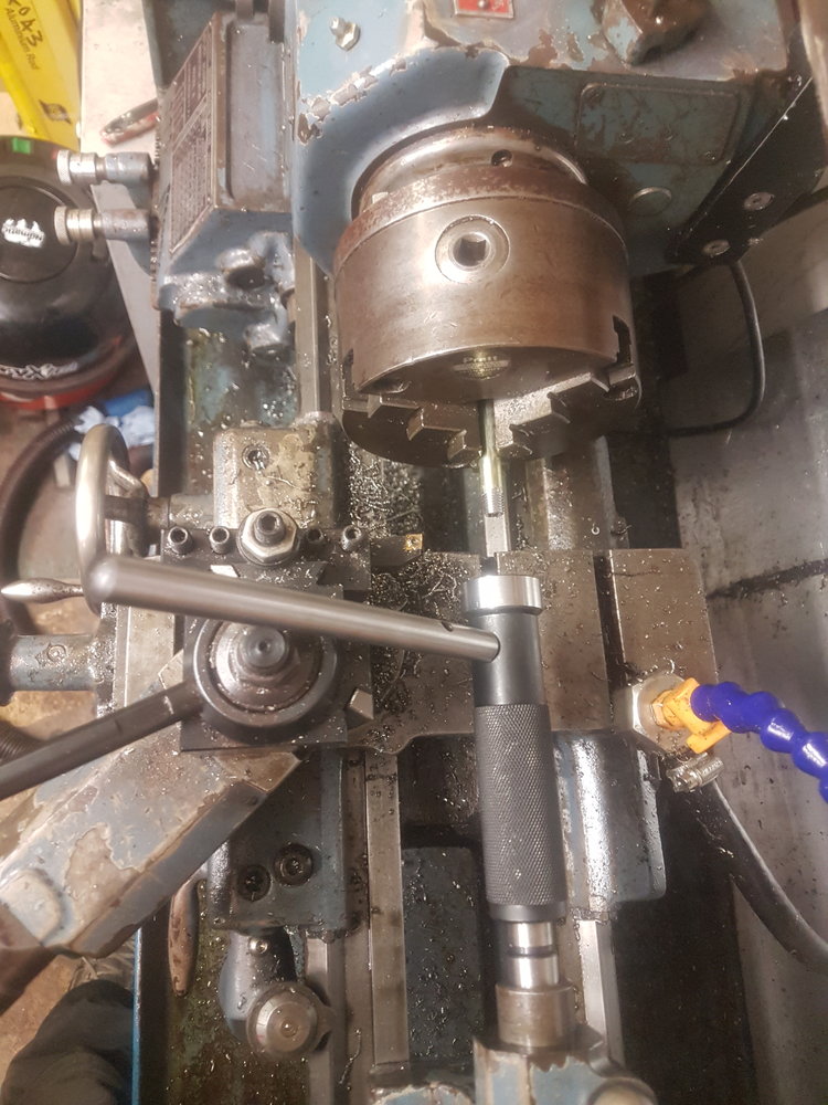

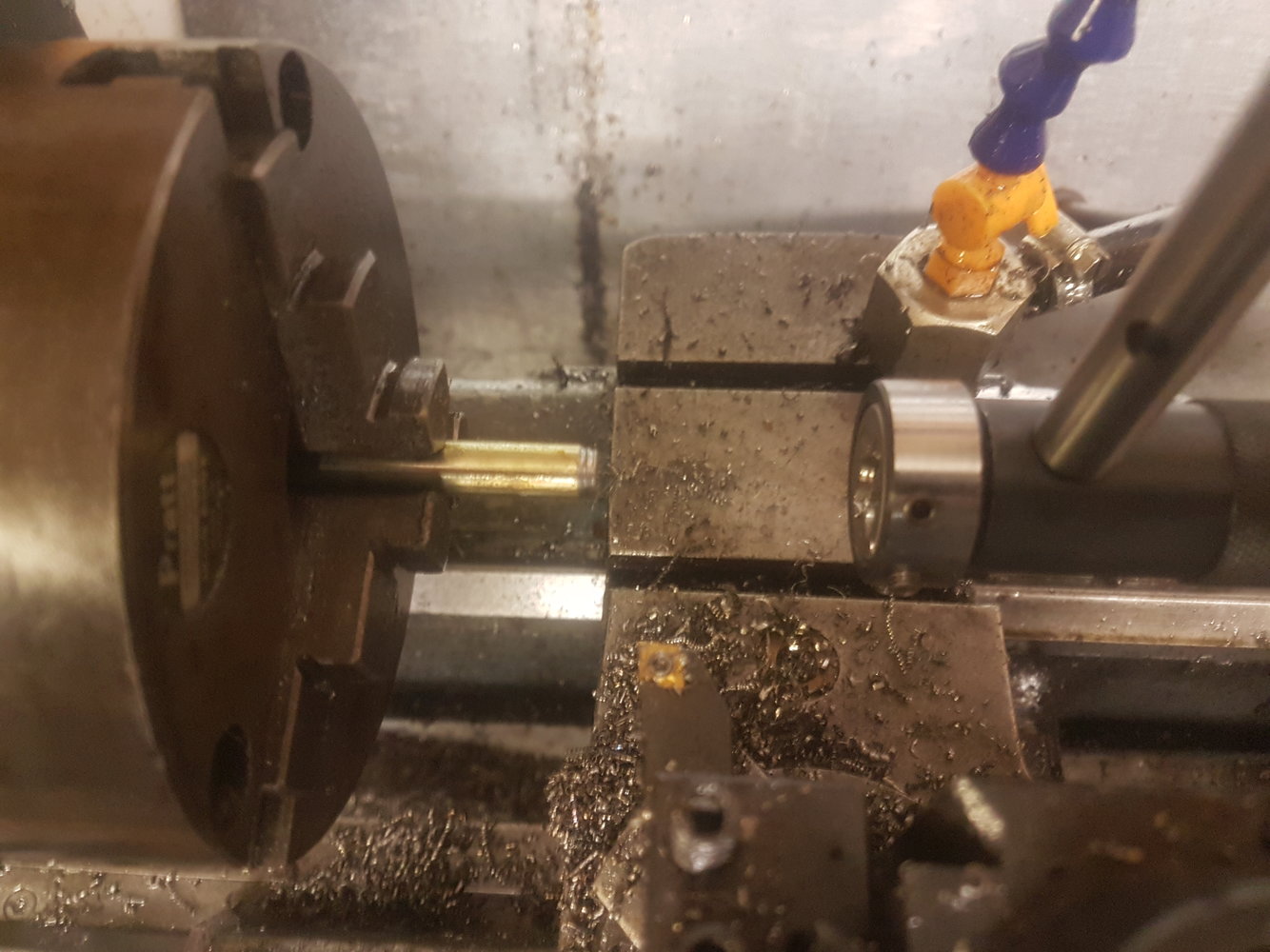

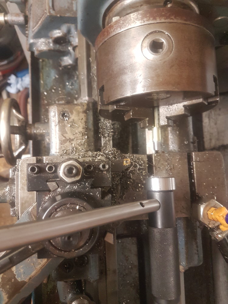

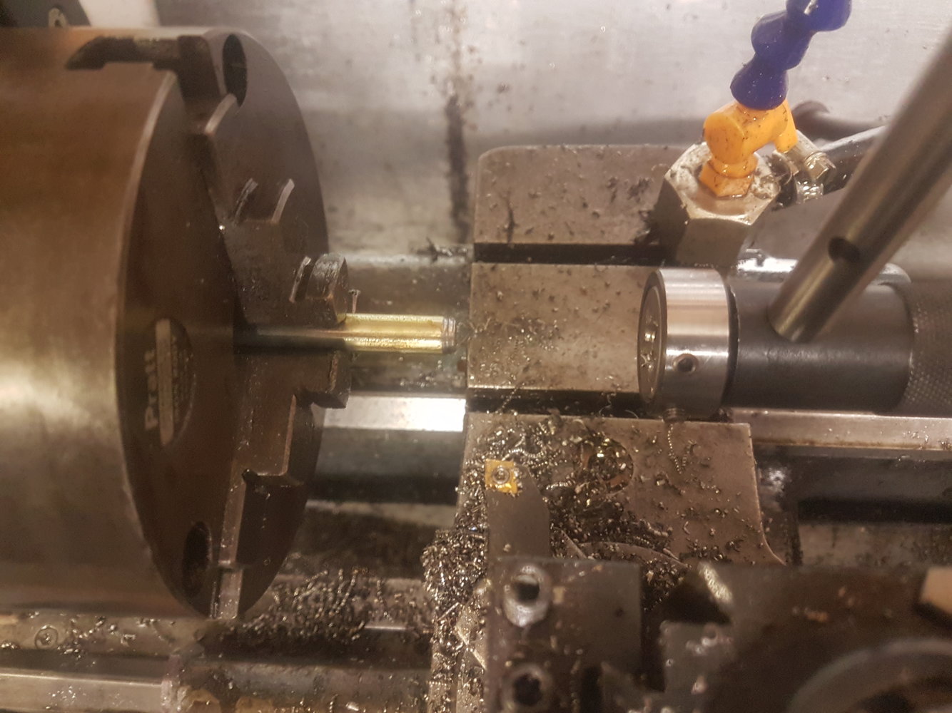

I shall have a play with it some more at the weekend then, i did try a fair few timesJust checked mine and its ok, I can get the tap squiffy in the jaws buts its easy to get it straight if you take the tailstock to hole to be tapped to align before tightening the tap chuck.
