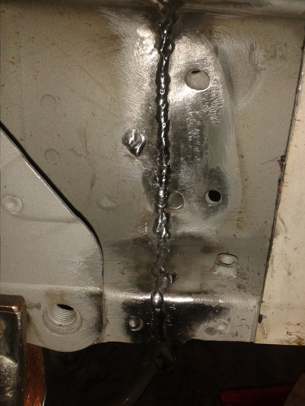

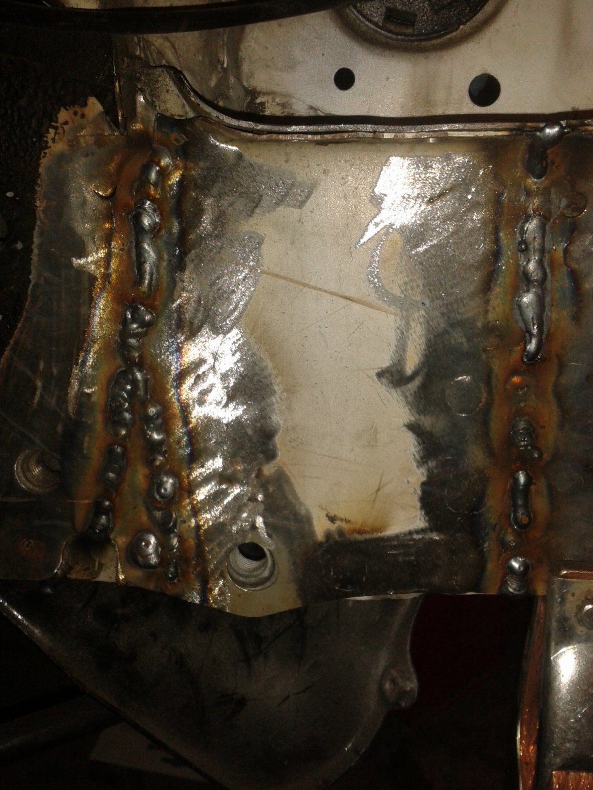

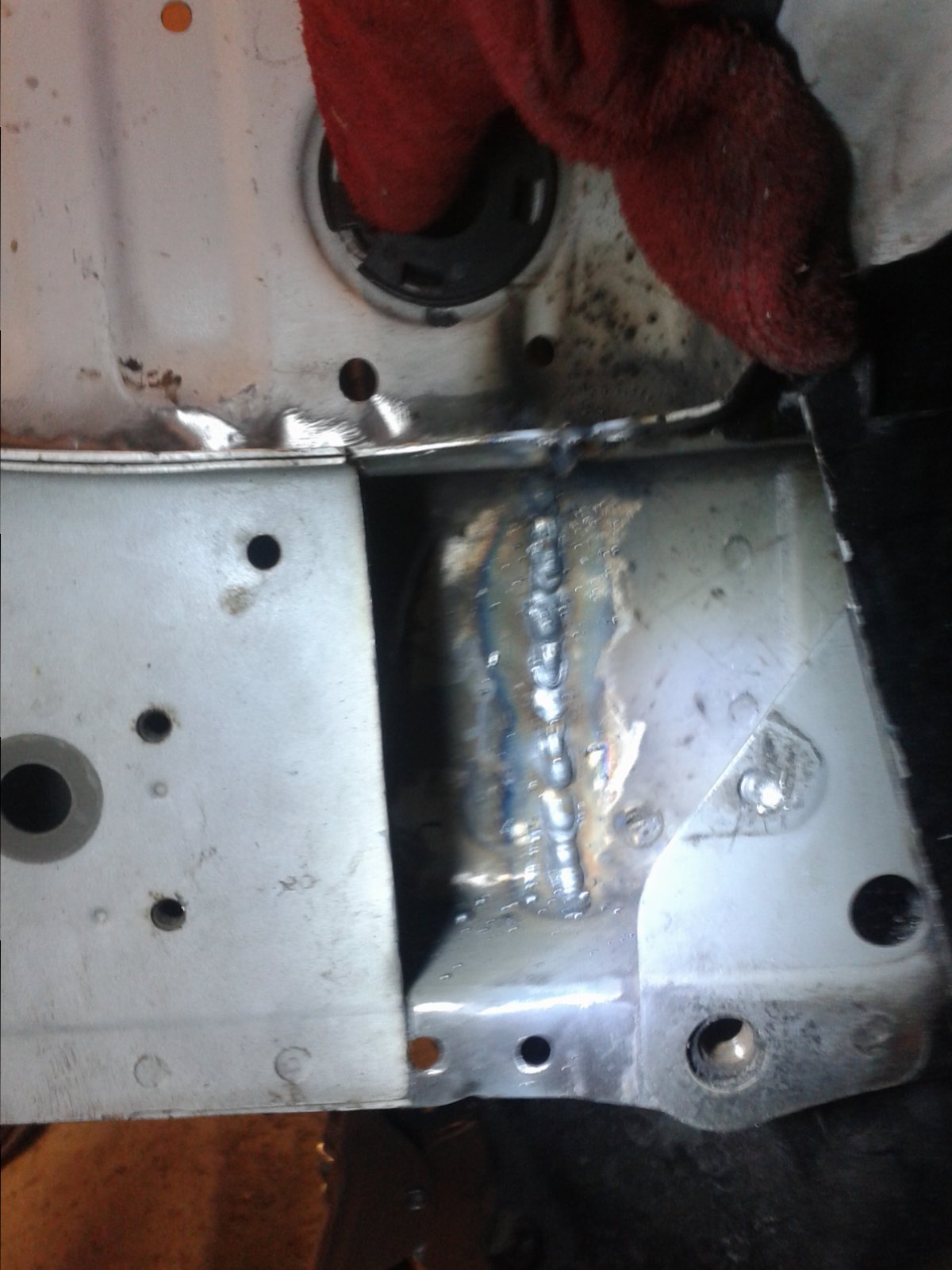

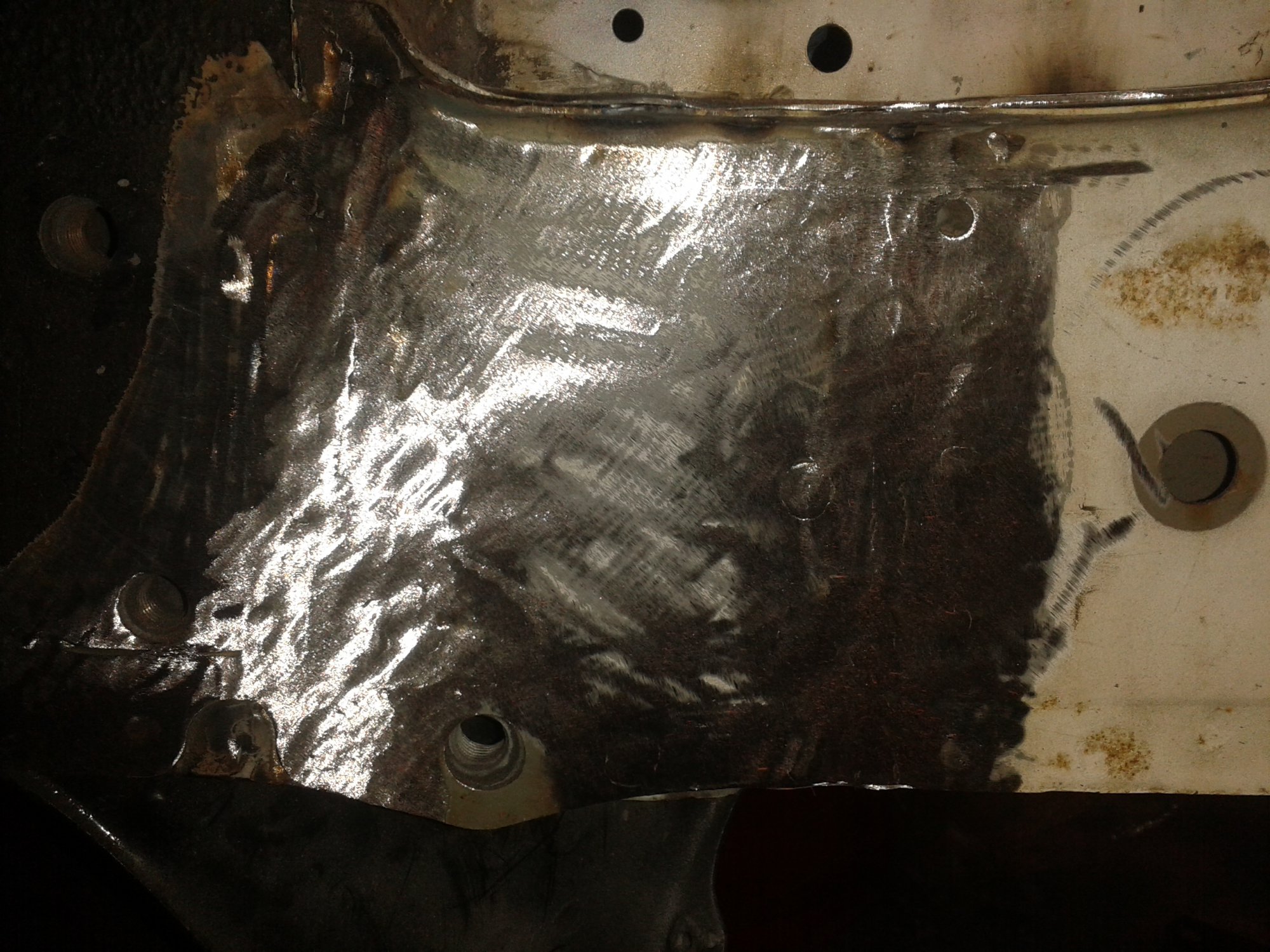

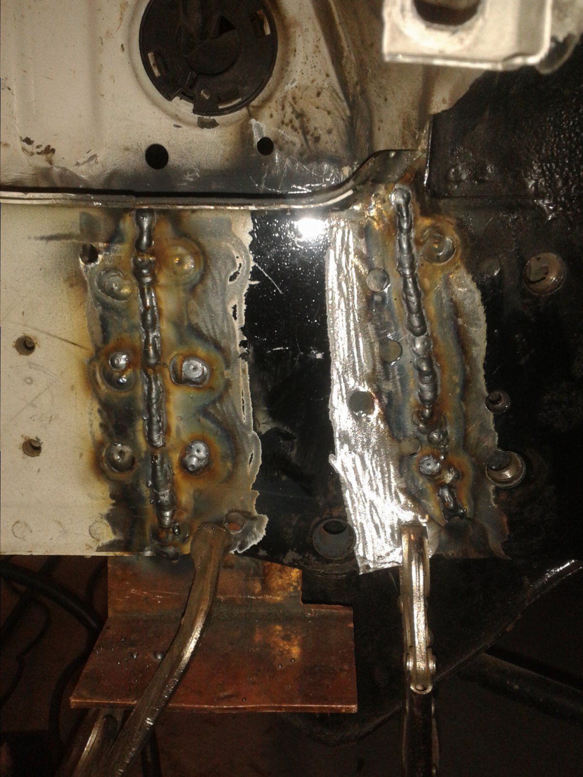

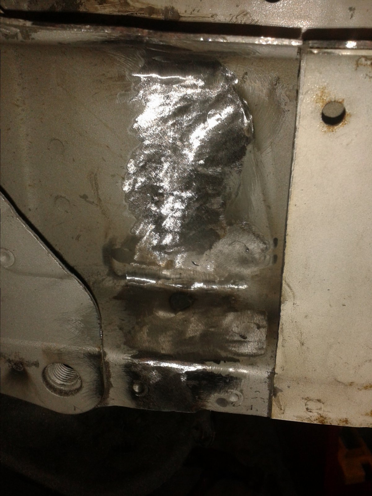

I decided to back the joint behind so I didn't have to worry about blowing holes everywhere...still managed a few holes!..the welding was "ok"...that weld thro primer kind of makes a mess of everything. I cleaned it up with a wire brush...main concern is that the weld is sitting a bit high but might be because I backed it? It was definitely a lot harder to weld on the car. Now I can't decide whether I should grind the welds back and sleeve/plate the front of it so it's reinforced...decisions decisions...any opinions please shout? I still have a few spot welds to fill in of course.
