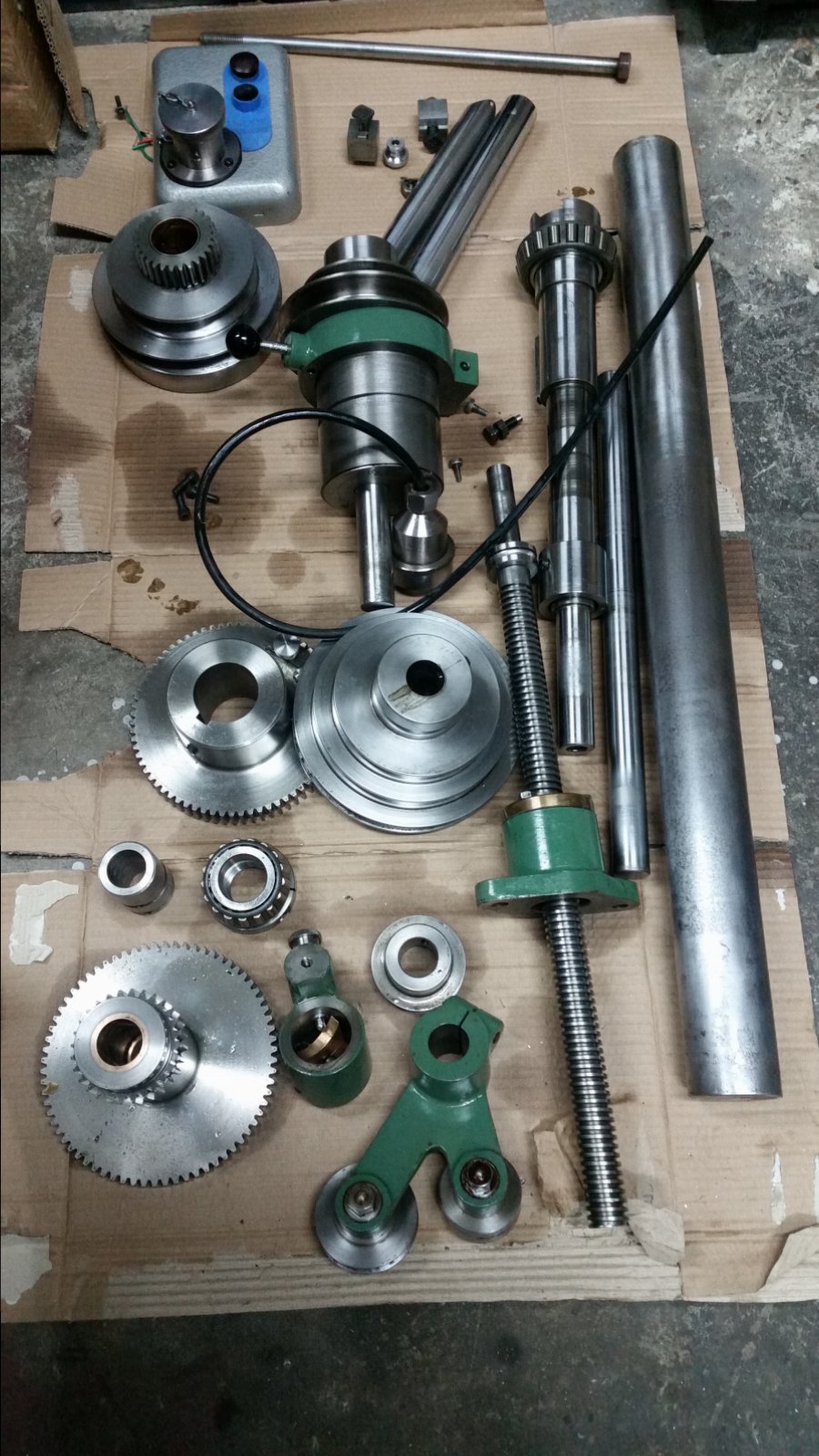

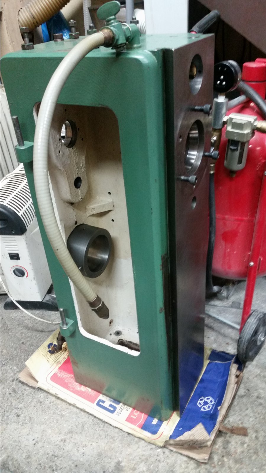

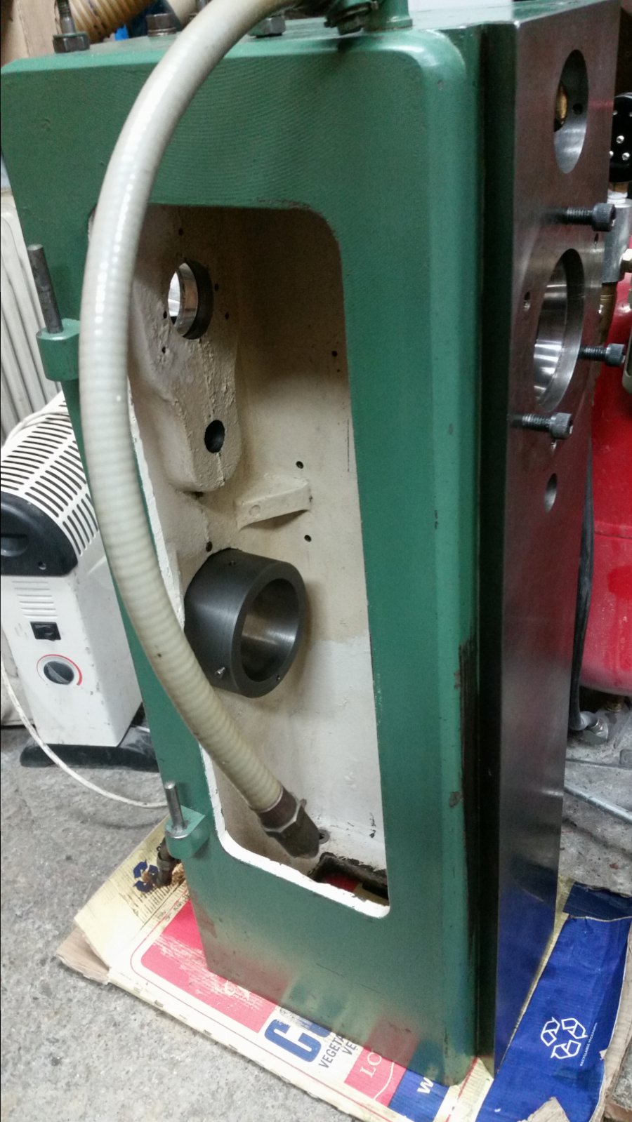

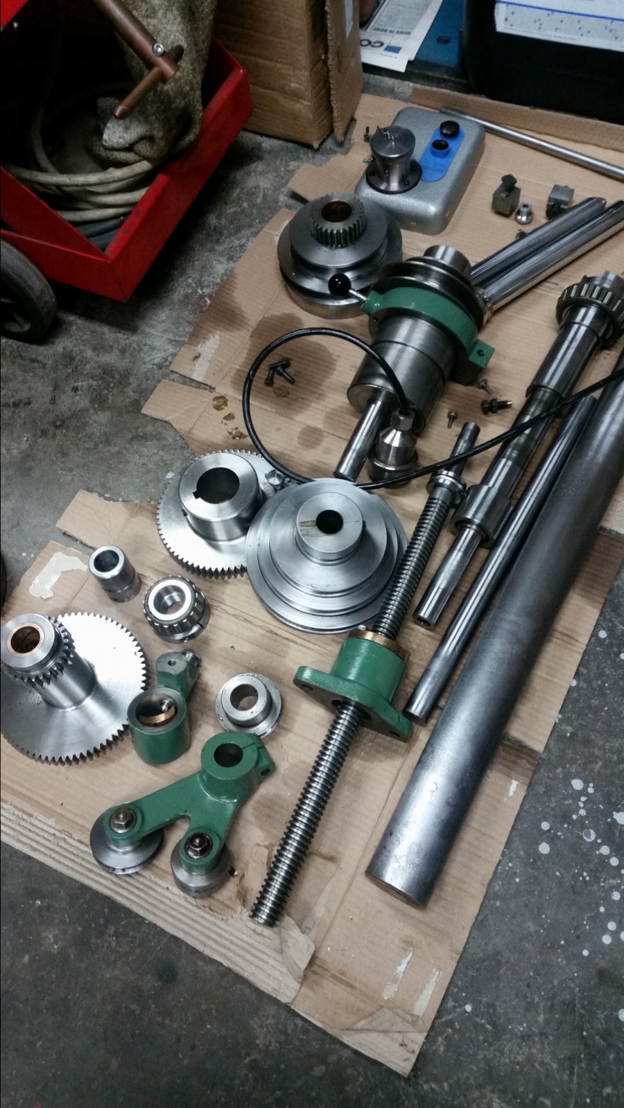

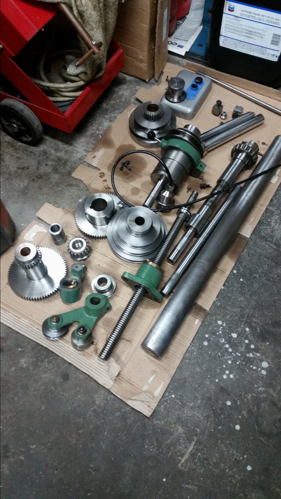

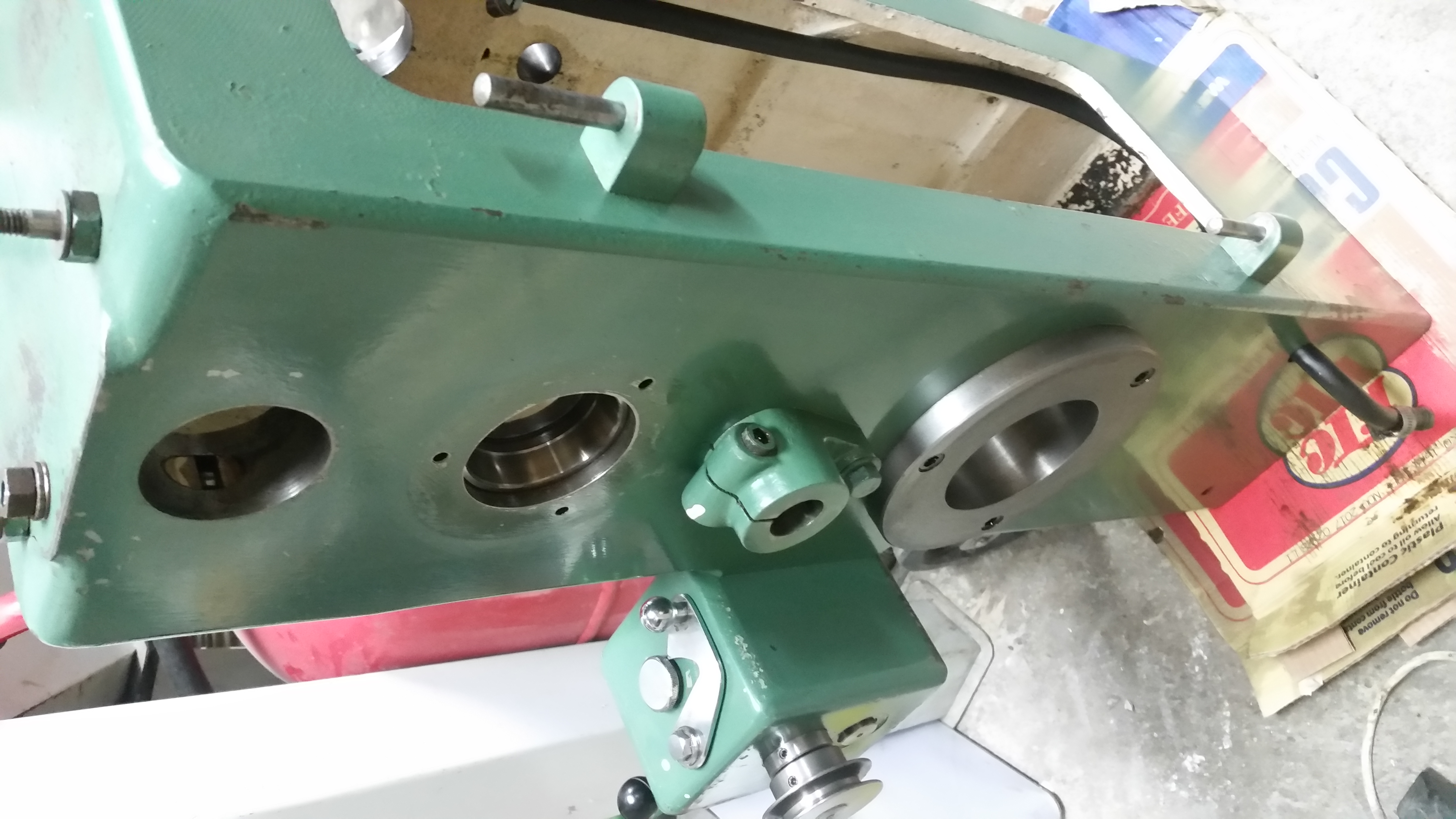

Piero Member Messages 1,411 Location Uk Oct 7, 2016 #26 Spent a few days taking apart and cleaning the tom senior major Some photos so far. Got a question if anyone can help. The oil level sight glass. How is it held in place. I am guessing the outer ring is a tight push fit. But I need to remove it and am fearful of braking the glass 20161007_152941.jpg 270.5 KB · Views: 64 20161007_152948.jpg 259 KB · Views: 61 20161007_152954.jpg 264.6 KB · Views: 66 20161007_153007.jpg 216.4 KB · Views: 64 20161007_153012.jpg 225.5 KB · Views: 64 20161007_153023.jpg 20161007_153023.jpg 2.8 MB · Views: 59 20161007_152918.jpg 20161007_152918.jpg 3.1 MB · Views: 62

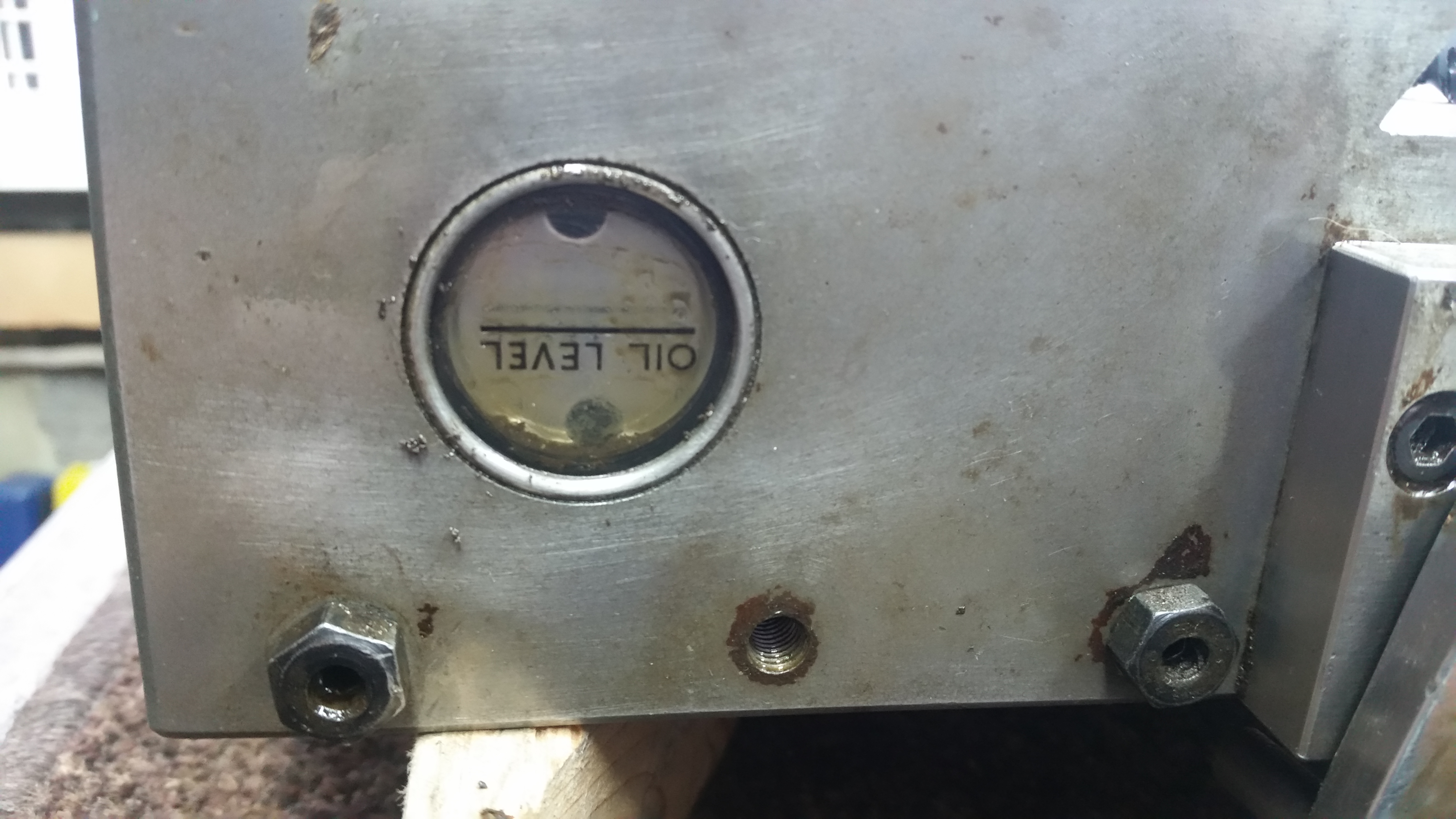

Piero Member Messages 1,411 Location Uk Oct 7, 2016 #27 Last two photos do open up if you press on the link. In the last photo it shows the oil level sight glass I am on about
Shox Dr Chief Engineer to Carlos Fandango Messages 17,986 Location East Yorkshire Oct 7, 2016 #28 They just knock out, some not easily as access from the rear can be difficult. Cheap enough to replace, if you break it.
Piero Member Messages 1,411 Location Uk Oct 7, 2016 #29 Ill give that a good next time I am at my unit As everything is apart, I was going to replace all the V belts (dont want the clip together type) Are machine belts any more heavy duty than standard V belts
