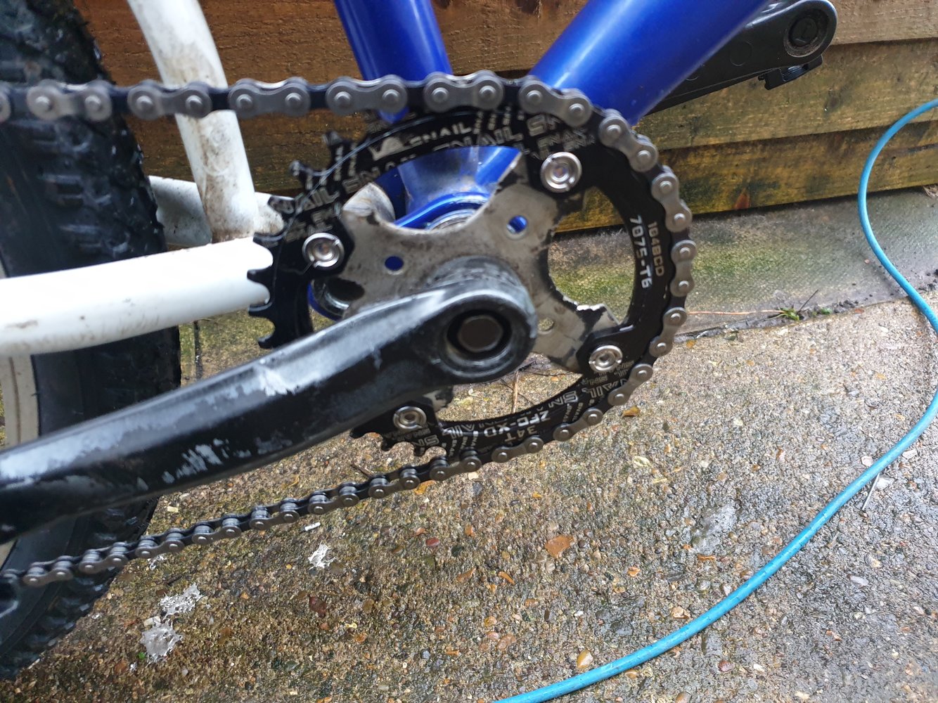

As has been mentioned in a roundabout way, you'll still need something to keep the chain on at the front. Modern bikes use thick/thin chainrings, but I doubt you'll get those suitable for 7 speed, so you'll either have to fit some kind of chain guide, or just fit an old front mech with limit screws wound in to hold it in the required place to keep the chain on.

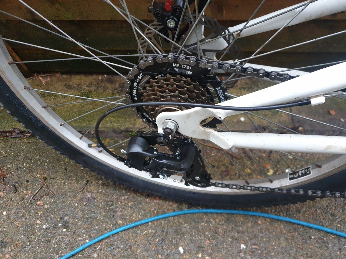

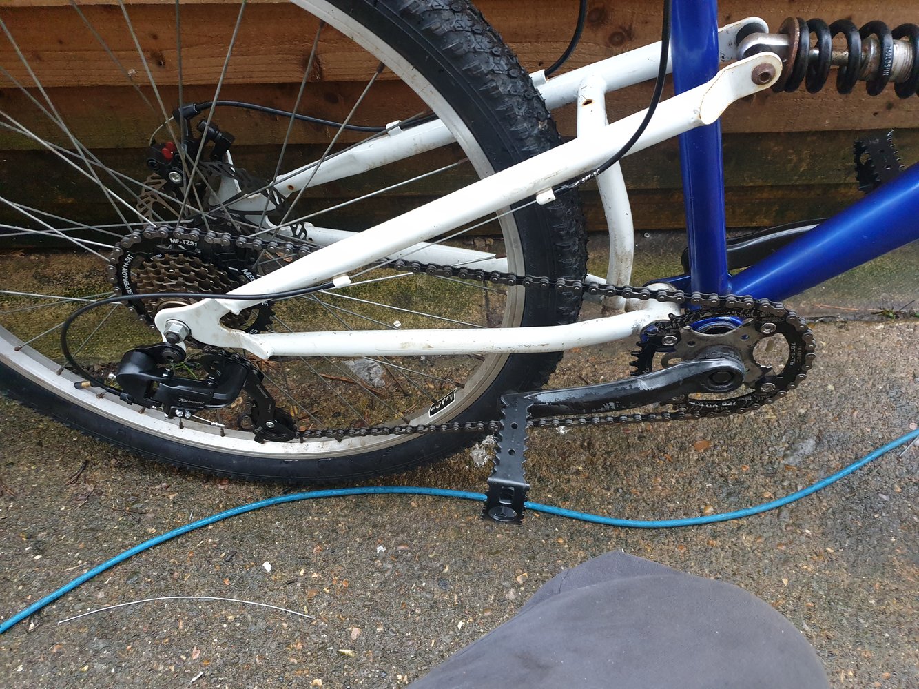

A lot of the time I leave mine on the centre cog on the back and use the front as a 3 speed.Did a bit on this today, needed some shed time to clear my head while other stuff going on.
Managed to achieve everything I wanted for very little cost, the only thing I actually paid for was £10 for the thick/thin chain ring.
Could do with a crank that would let me mount the chainring the other side, this will improve the chainline in 1st but its not a huge concern right now
I also stripped, cleaned and greased the bottom bracket, was going to replace but its good as new now.
One small point, this is not the bike I was talking about when I started the thread, I had stuck some tyres and cheap forks on this and it was sold, the chap came to pick it up and got all misty eyed over the bike I was about to modify so I sold him that for double what I paid for it, saving me having to buy more tyres
Few pics, didnt take many as I was just enjoying shed time
View attachment 272962View attachment 272963View attachment 272964

If you have cycled up to the Humber bridge you will know it makes sense, but the majority of my use will be 2-7.
I also like the clean look of the front cog

Same number of teeth as the old middle cog, for £10 I thought it was a good starting point and 4 bolts if I want to try something else
just zoomed in: 34T?
it must be the picture which is deceptive - because it looks nearer a 24T.
