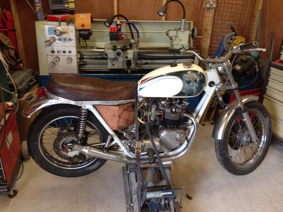

There's many potential solutions that could work and I think it's a question of finding the balance between what suits each person, how deep their pockets are, what bike needs lifted and how much space is availableid rather use a genie lift easier to roll a bike onto it and can be adjusted to any height required
as for access well to a degree its one side only but the rear side can be access just not as easily as the front facing side
Hmm...I have a coffee table, but I think it's a little short, a little low and a little new. Plus where would I put my coffee!I used an old chunky coffee table for a while, and a ramp to push the bike up. It worked ok, but too much space.

.... and I hope to be placing an order for one of these shortly https://on-bike.com/motorcycle-lifts/sports-superbike-lift
No experience of that particular lift but having visited m/c dealer workshops ,at least 10,000 over a period of 20 years , I have to say I wouldn't get within 10 yards of any bike on that. Remember if it can go wrong it will ie fall over. EG . It would only need a tight rear wheel nut and a good heave and it would be on top of you. Added to which anything that gets dropped will hit the floor and either be damaged or never seen again. Also where do you put the oil tray or any small items /tools . Also by looking at the photo's it appears to have at least 5 points of contact with the floor which would require a perfectly flat floor or multiple adjustment points to ensure stability OR the the facility to bolt directly to the floor which sort of negates the idea of portability. As for the showroom idea I doubt if any dealer would trust it with punters poking it .aboutVery impressed with that rate of recovery; I'll keep my fingers crossed that I'm equally speedy when/if my turn rolls round.
As far as my bike lift plans go, my plans/vague thoughts have been solidified (many thanks to @addjunkie) and I hope to be placing an order for one of these shortly https://on-bike.com/motorcycle-lifts/sports-superbike-lift
If anyone has any experience with them, feel free to pipe up!
Doesn't sound that easy, the front support underneath has me wondering as well. It would mean the skid plate would need removed before hand if wanting to do any work under the engine and no chance of taking foot peg brackets off if required. Sky Lift seems a better option for me personally especially with the stoppie, wheelie or complete lifting options.They say,

All lifts and work benches have pros and cons and benefit from a flat floor. There is no perfect lift. When I had the MM one it wobbled a fair bit especially with rusty old junk. How stable is the abba lift once the bikes up.Doesn't sound that easy, the front support underneath has me wondering as well. It would mean the skid plate would need removed before hand if wanting to do any work under the engine and no chance of taking foot peg brackets off if required. Sky Lift seems a better option for me personally especially with the stoppie, wheelie or complete lifting options.
