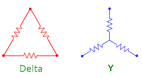

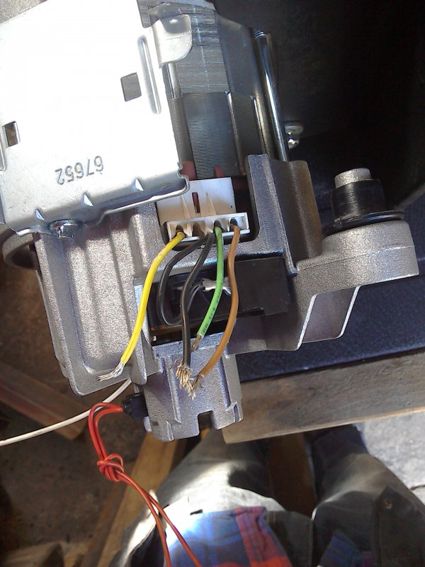

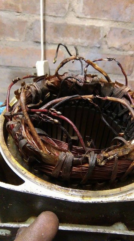

Three connections are red-red wires, three are black-black, three are yellow-yellow, three are red/black/yellow-mains supply and 1 is red-black-yellow.
ignore the Rd/Rd Bk/Bk and Yl/Yl
Rd/Bk/Yl is the star point.
disconnect this.
then wire these 3 ends to different mains supply ends
Rd -> Bk
Bk -> Yl
Yl -> Rd
this should then work 220V 3Ph. you'll get a cheap inverter for this. (£80 for a 1.5kW to convert it to run off 1ph)
I suspect the Washing machine motor will be too fast for the lathe or just not suitable, otherwise lots of people would have done it before.
What you can't do is run the old motor of 1ph.
