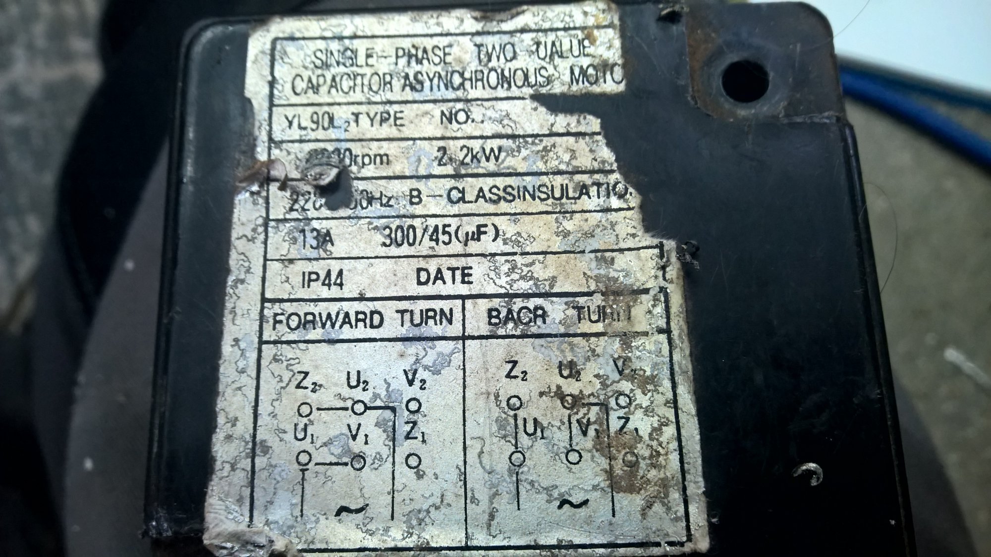

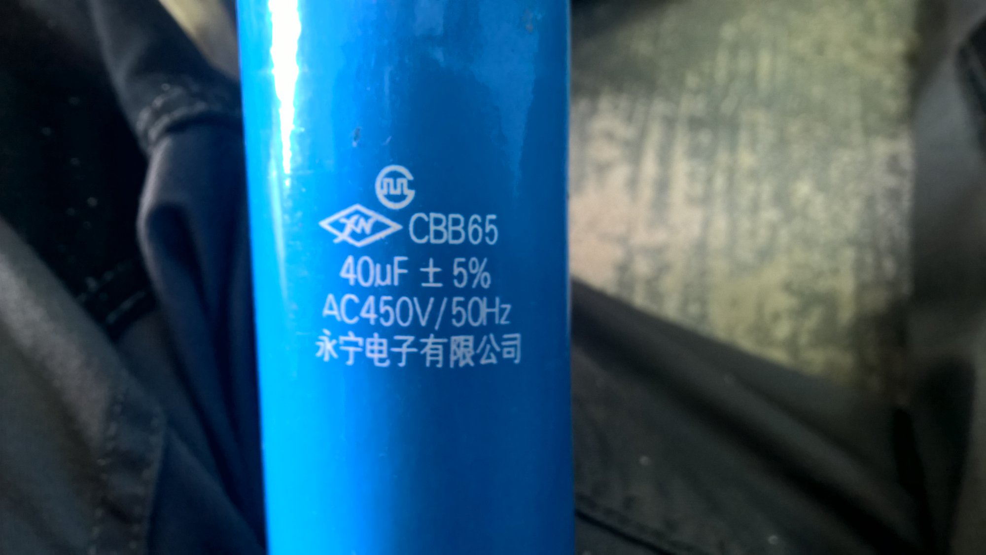

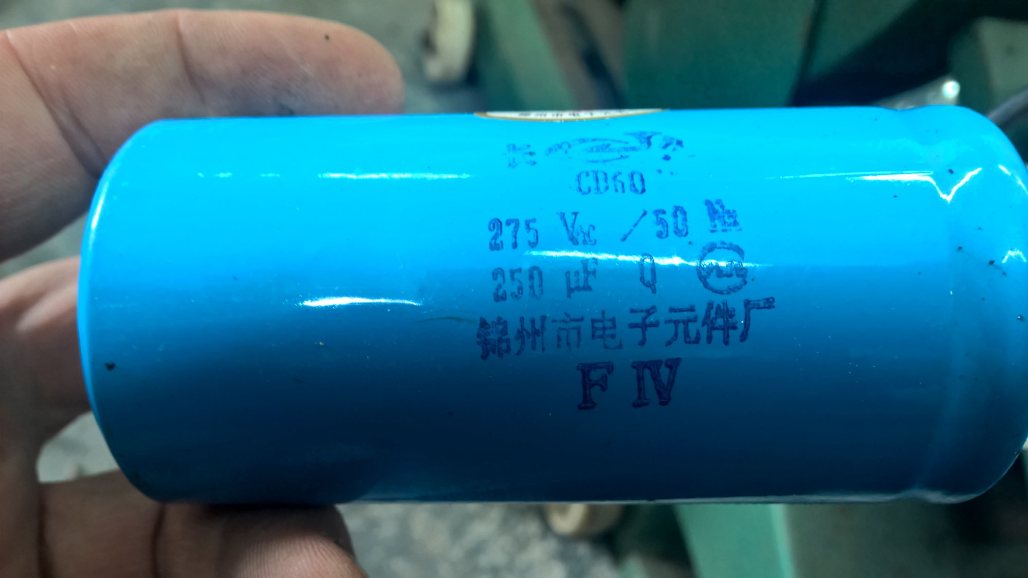

Also does it matter the the run cap (40uF) is a 450v not 240v?

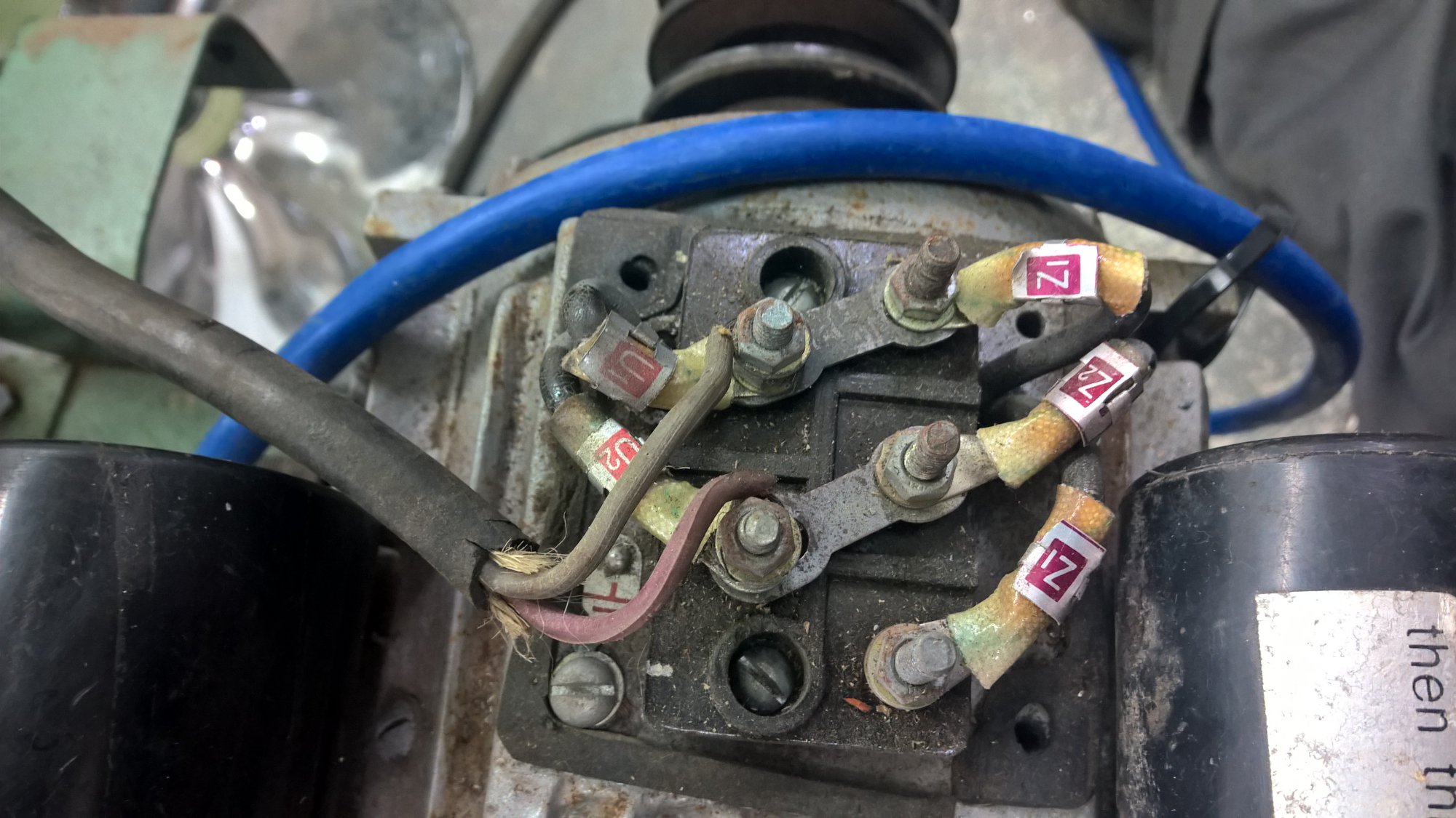

See what you mean, where are terminals V1, V2 and where do the capacitors connect or are they the Z and U connectionsI can't get the labels on the wiring diagram and the actual wires to tally at all...
