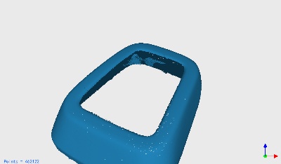

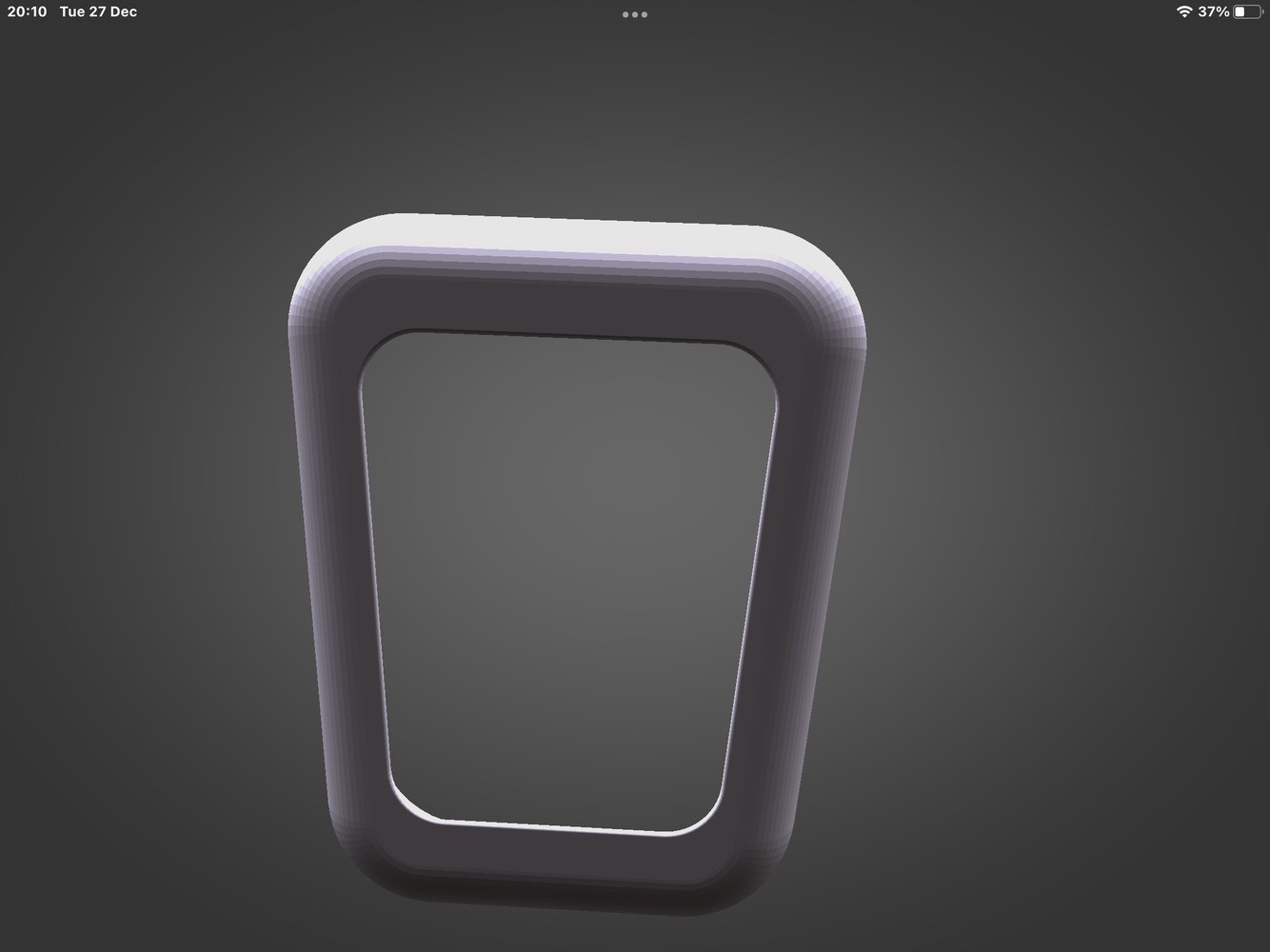

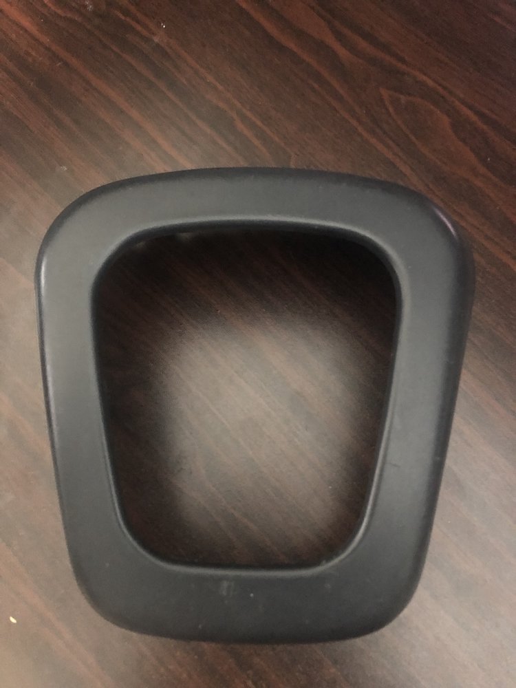

From what I can read in your scanner manual, it outputs a .ply file (it will be about 2440 x 1220 x 18).
There is a mesh workbench in FreeCAD: https://wiki.freecadweb.org/Mesh_Workbench
It looks like you import your ply there, trim off what you do not want (see 'cutting' in link above), and resave. If the corners stay the same and it just needs to be narrower or shorter or both, you'd need to create two halves (four quarters) as separate files, then boolean them back together into one piece.
