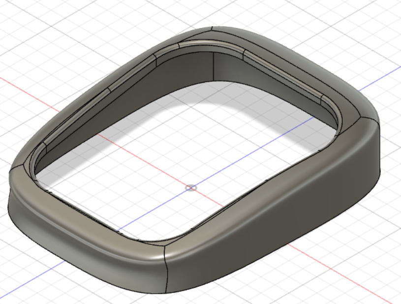

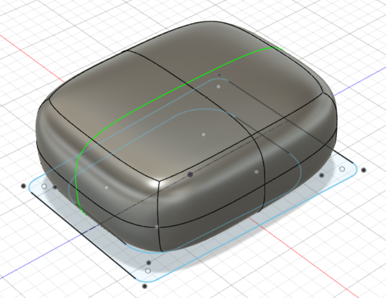

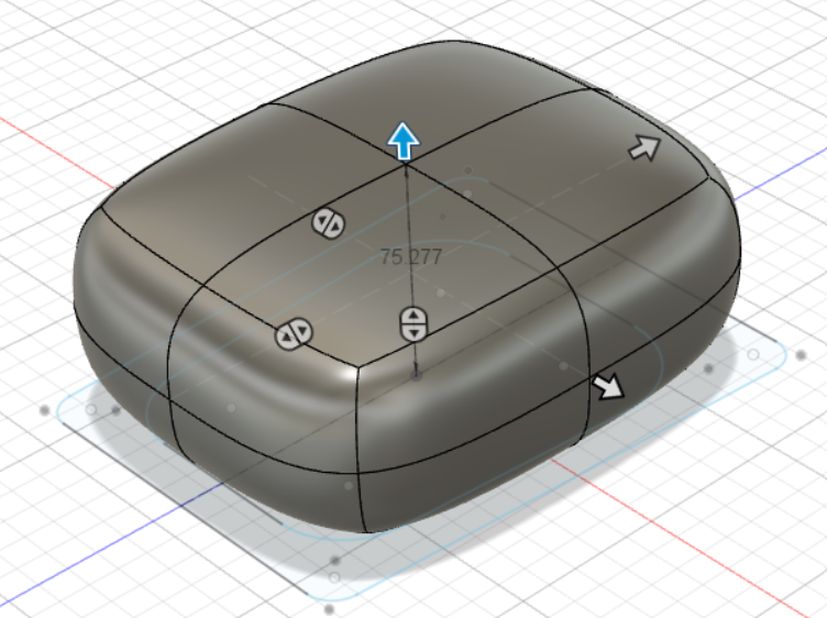

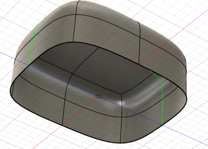

Now for the third method and If we need even more organic shapes we can use forms - a form can be considered a solid controlled by splines. We're going to use the same trapezium sketch as a guide and to generate the centre cutout. Being organic the sculpting is generally not so precise. we start by placing a form box - it's like a smooth edged box. We set symmetry so changes to one side are automatically reflected on the other and we also want the bottom flat so we delete the bottom faces which turns it from solid to open surface
Now we start manipulating faces and edges to bring the shape to what we want and cut out the central section and it's complete:
