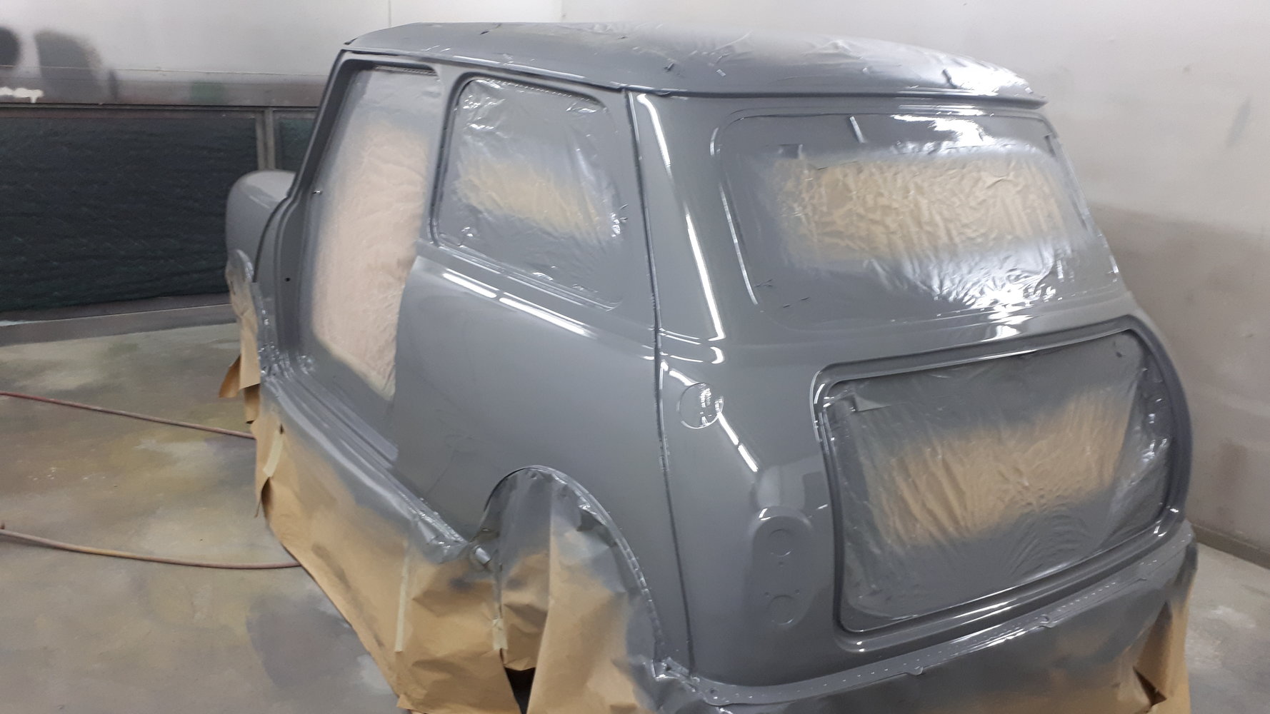

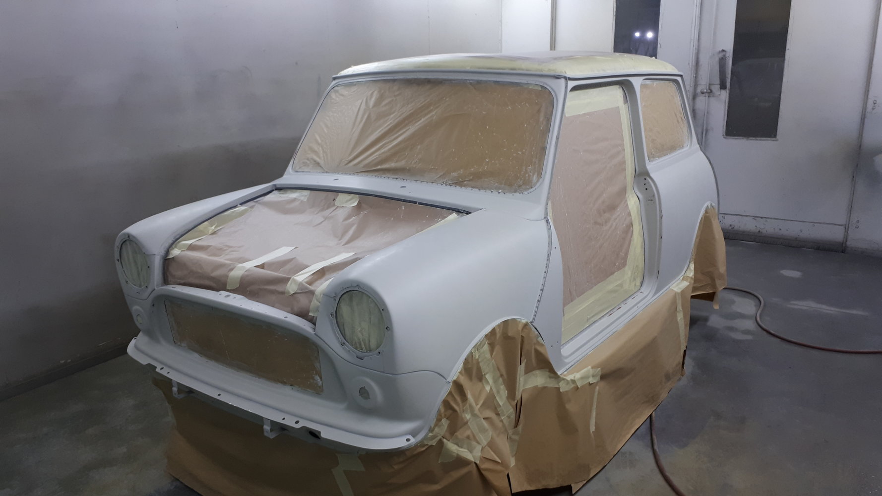

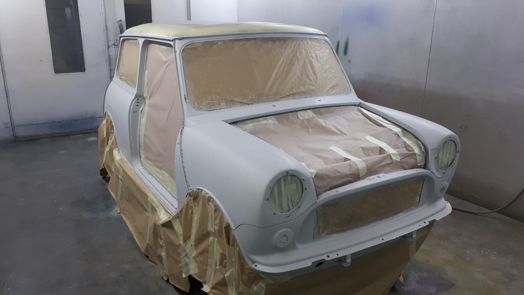

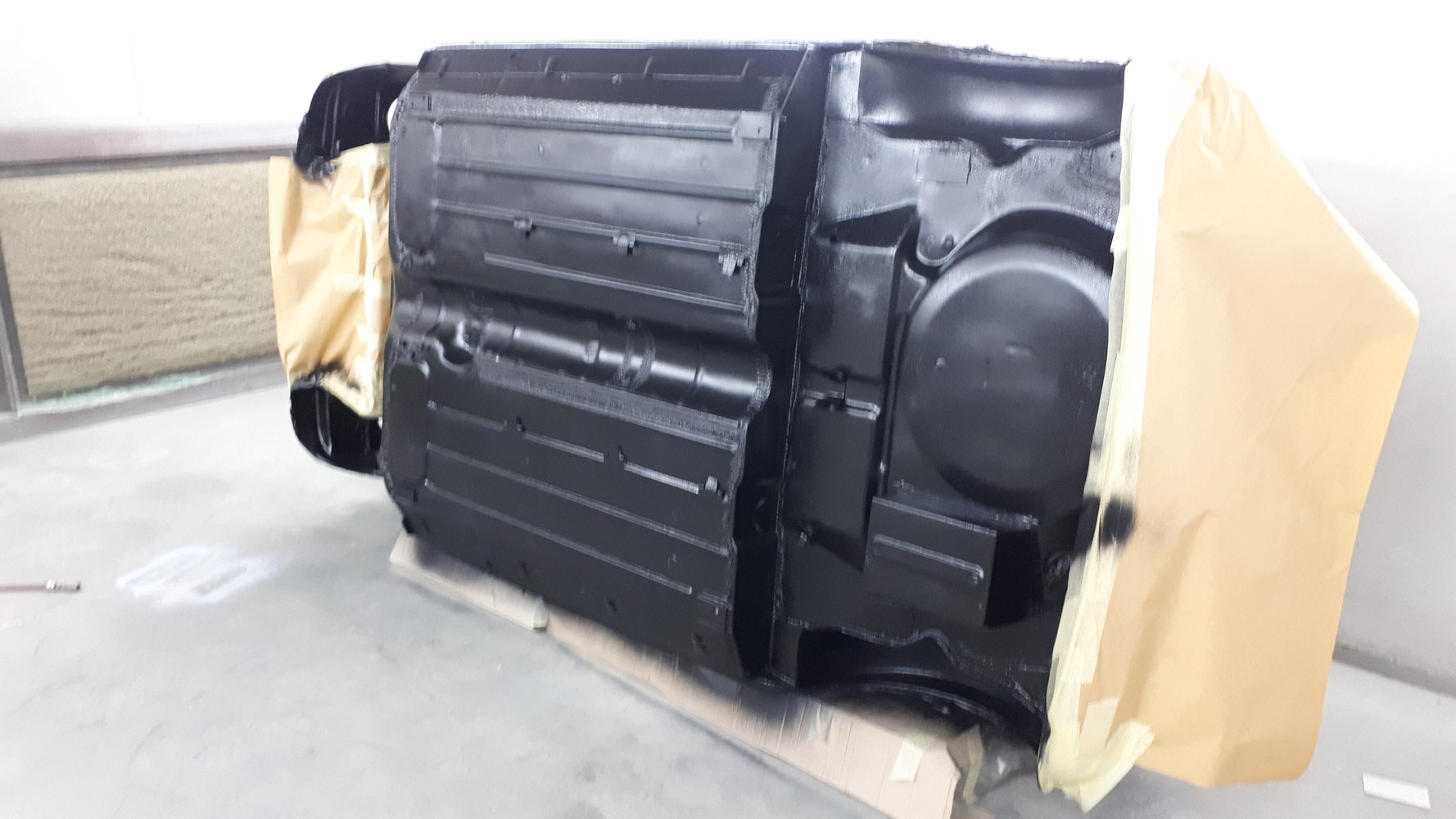

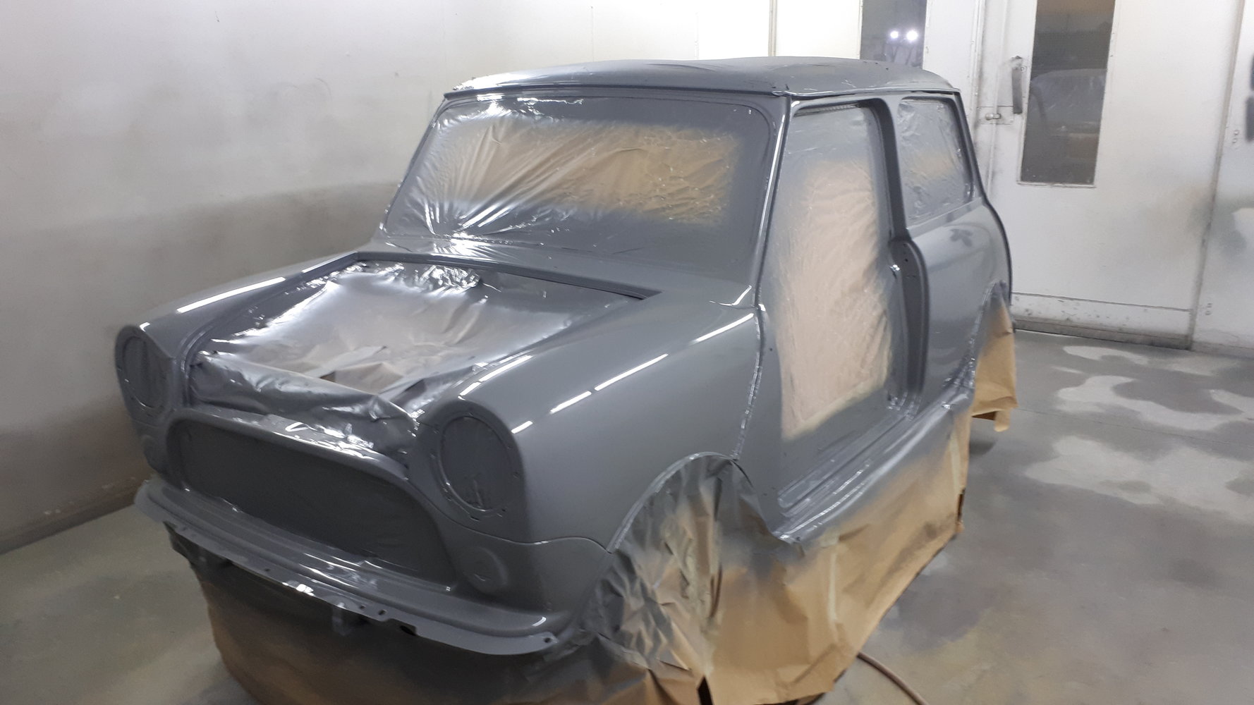

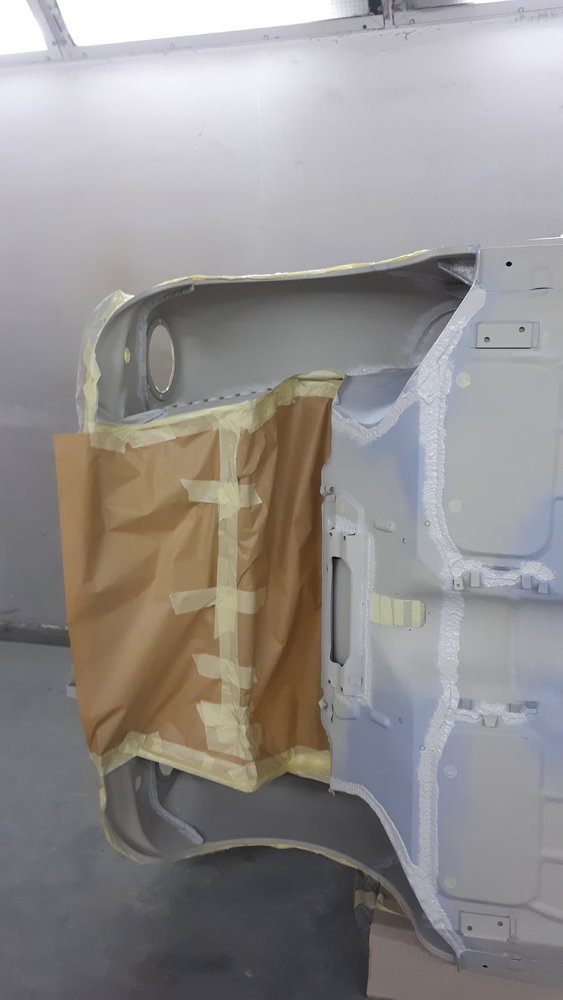

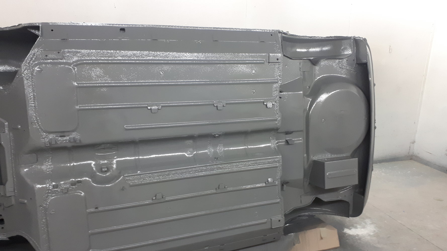

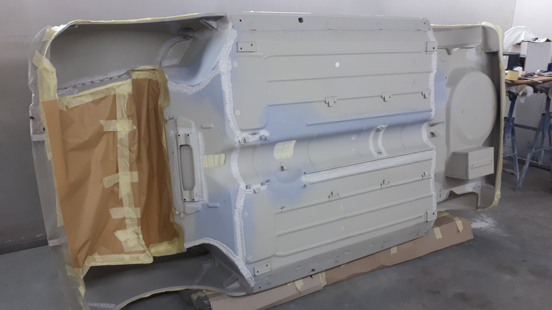

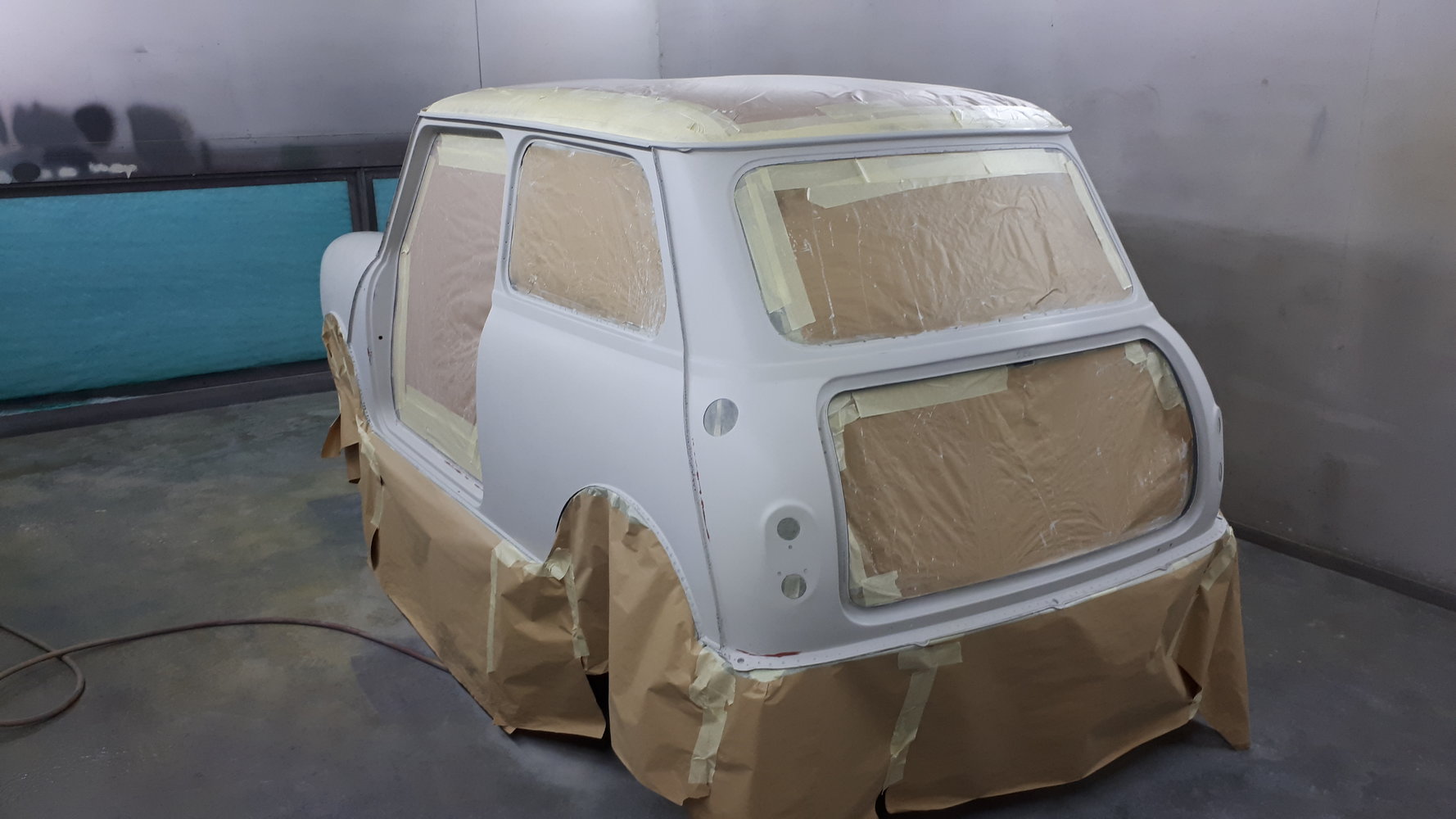

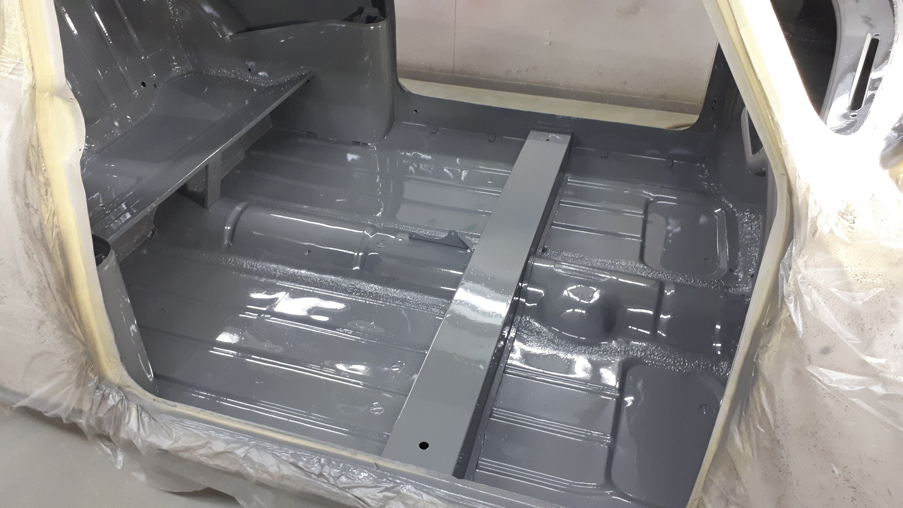

Took a week off for a holiday but still progressed.

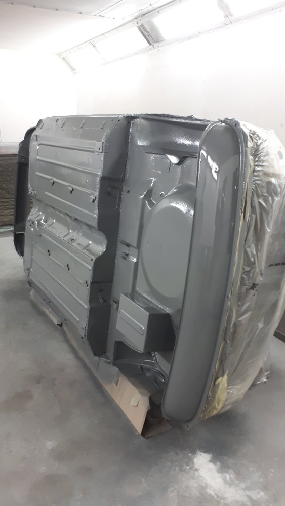

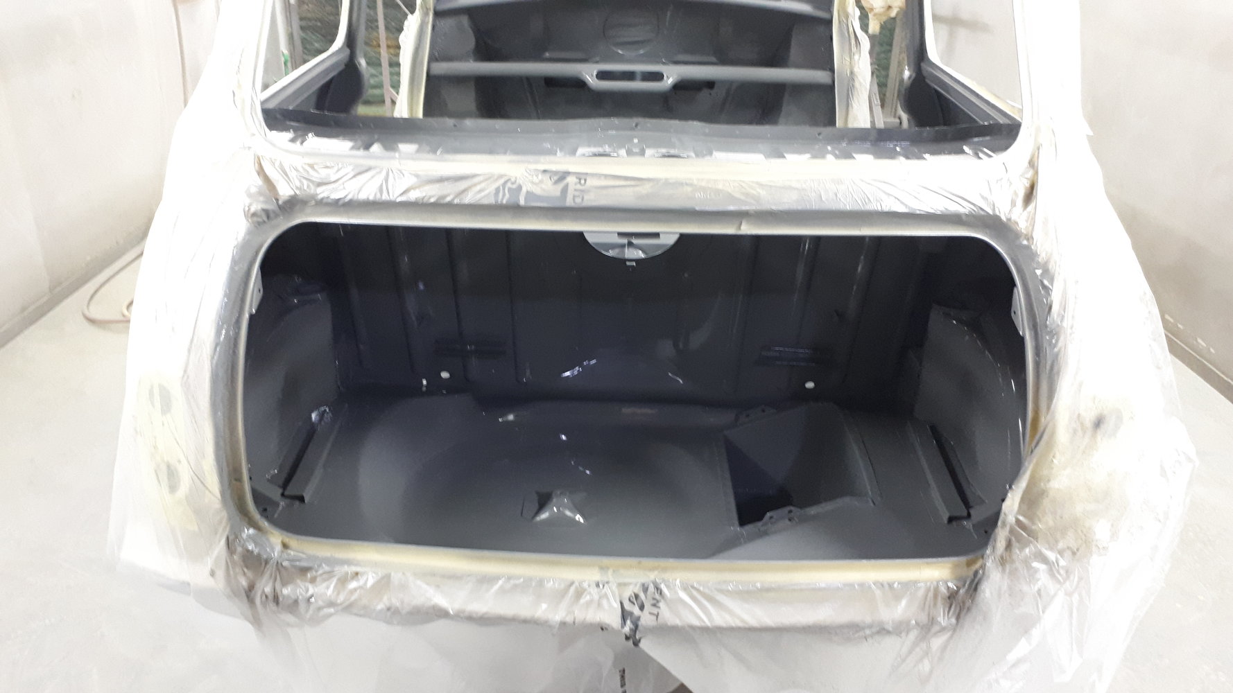

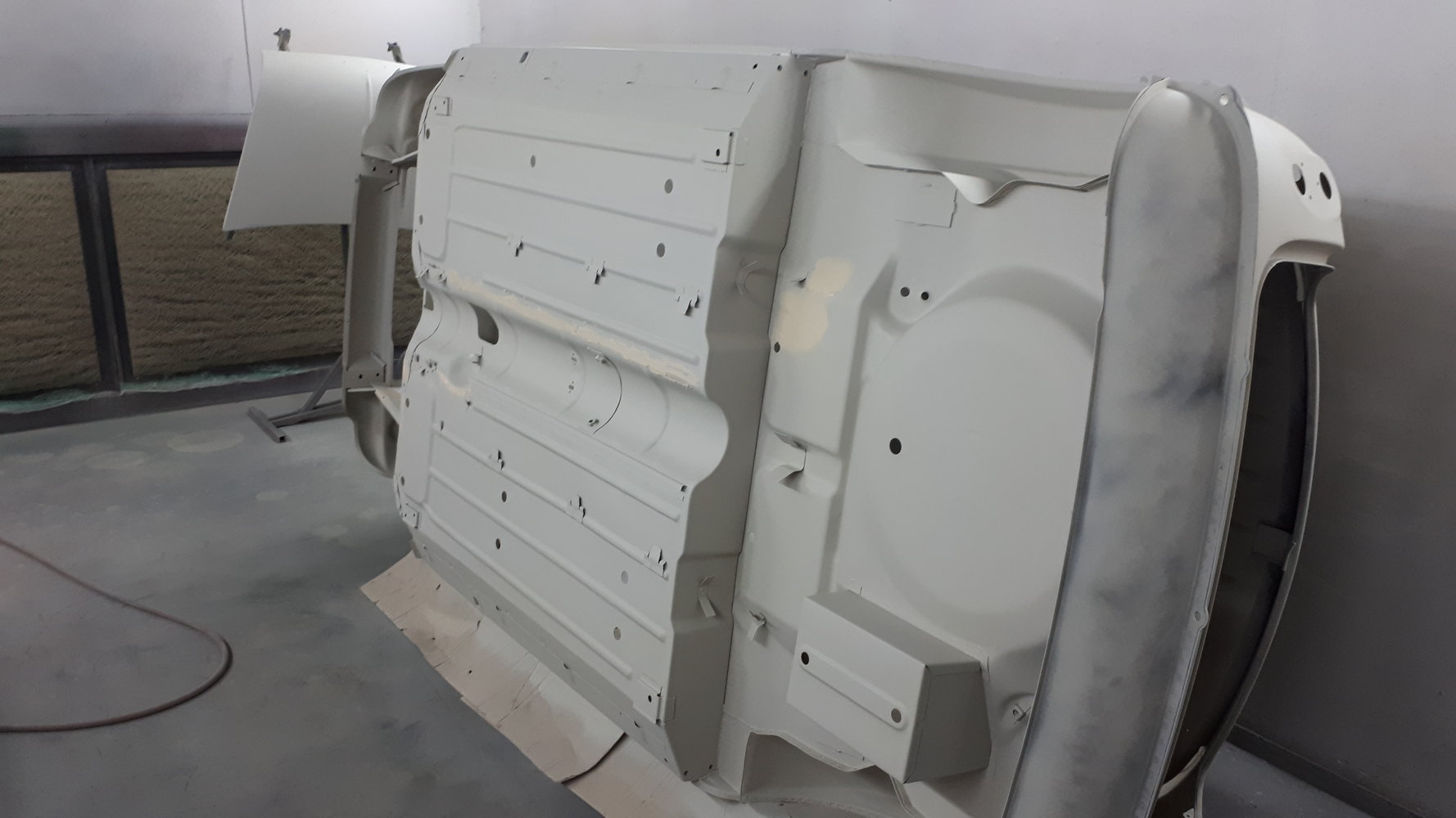

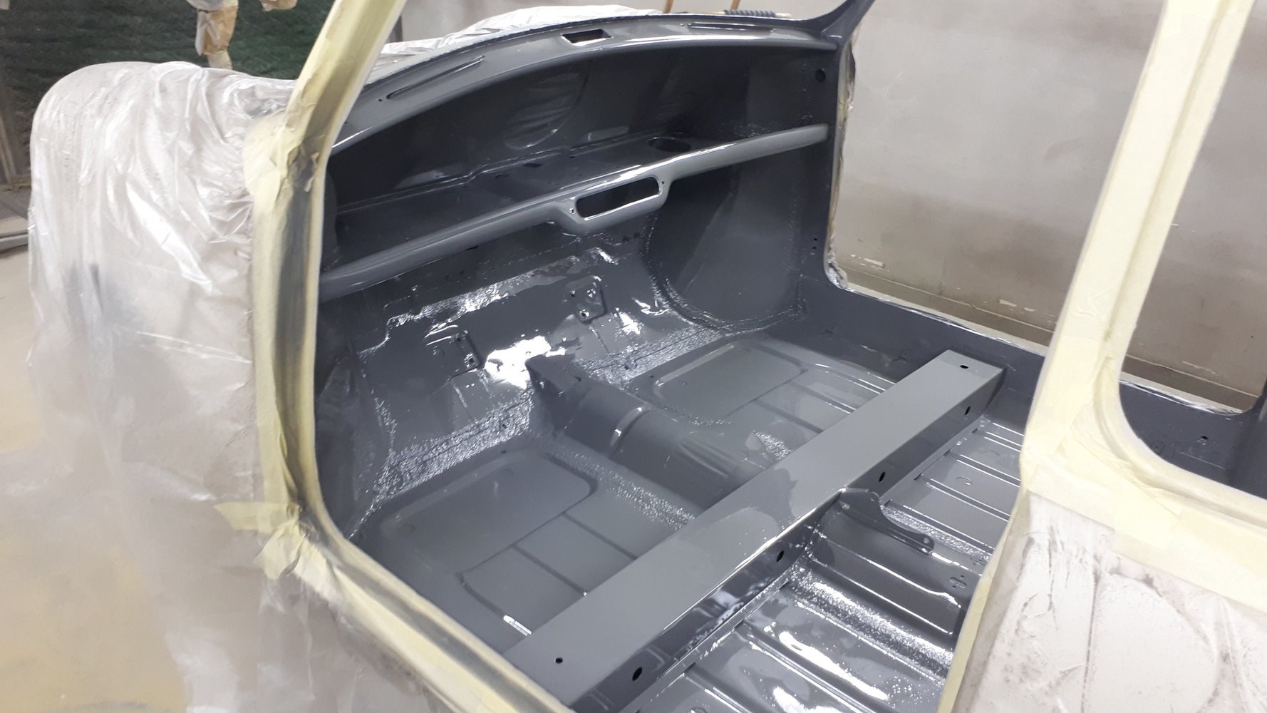

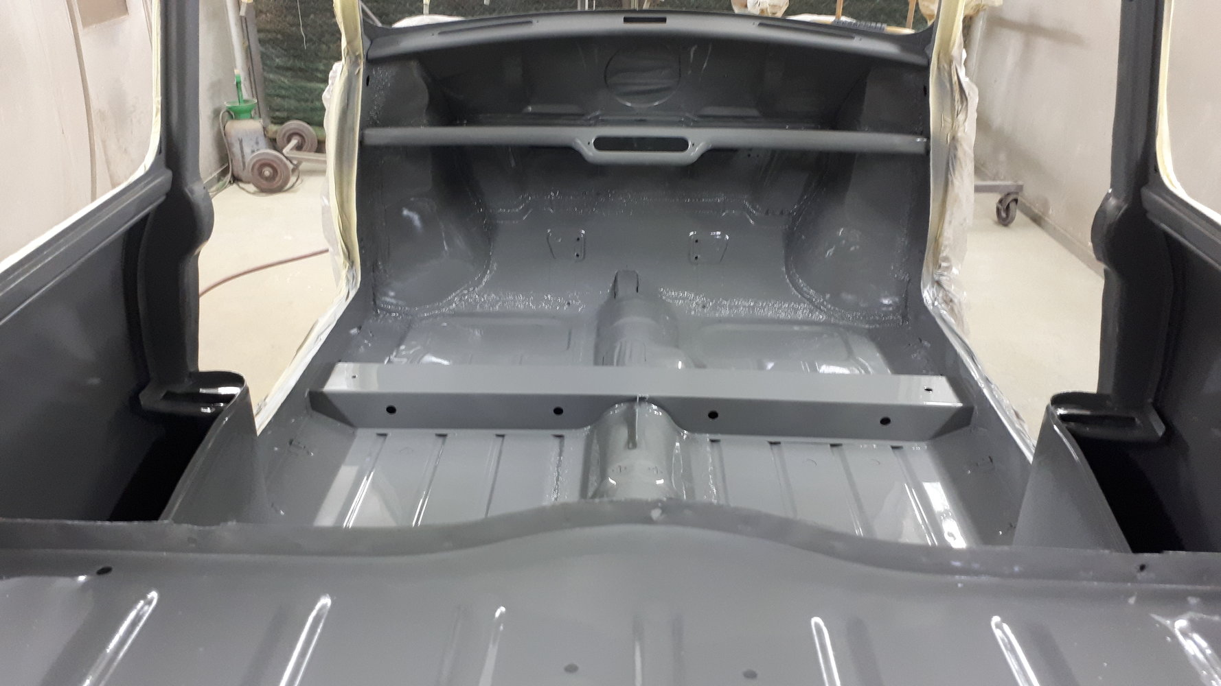

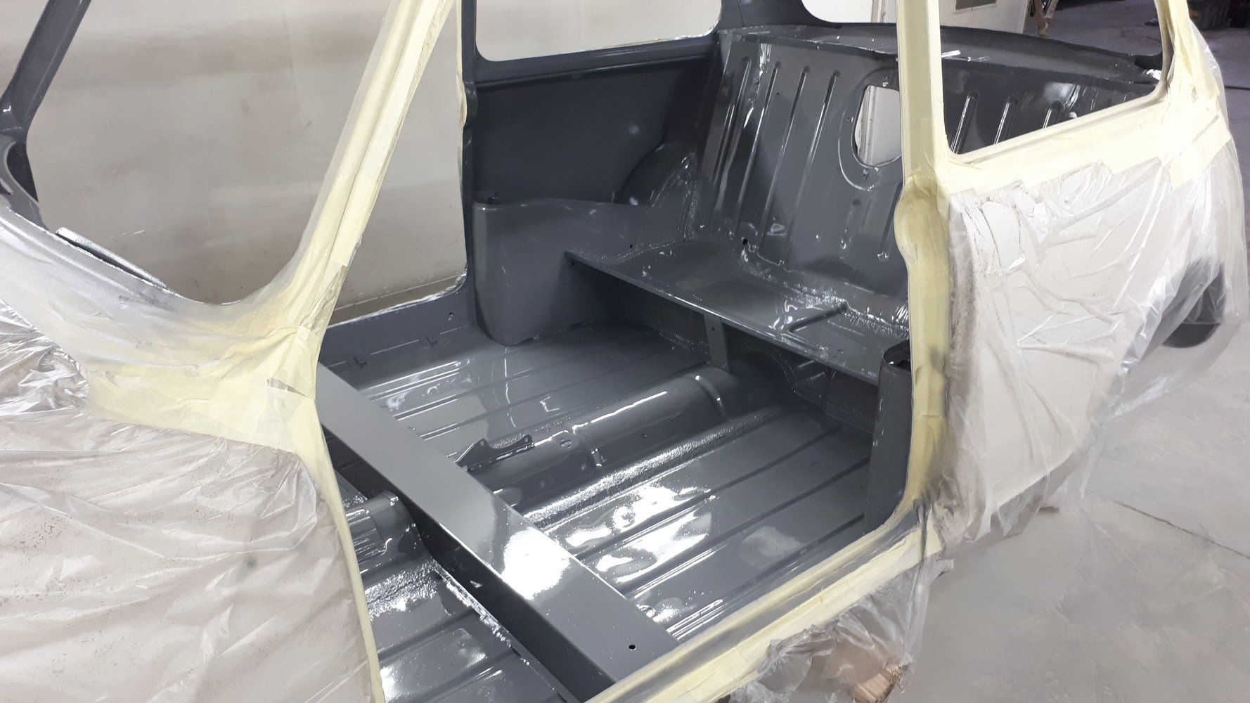

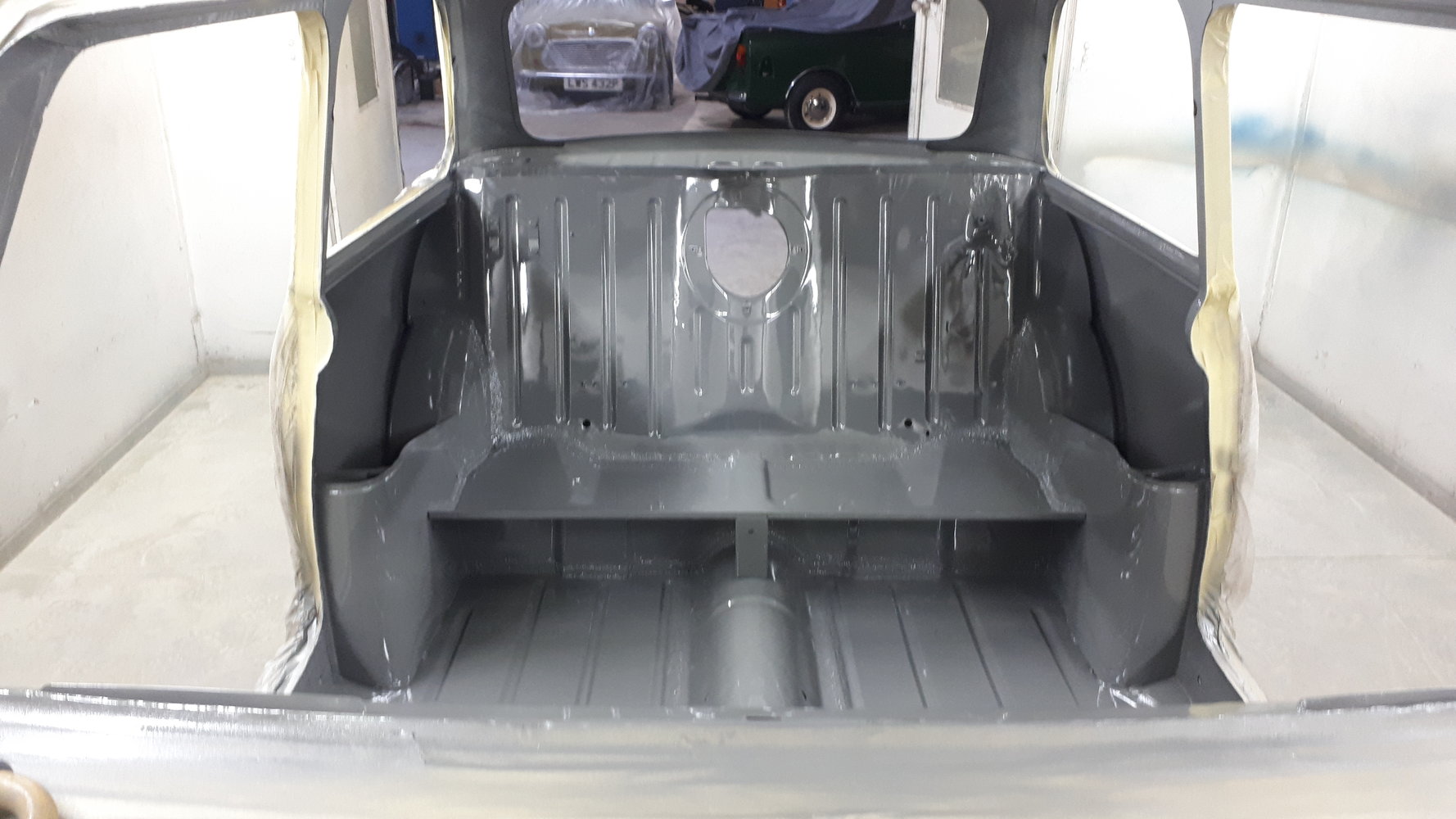

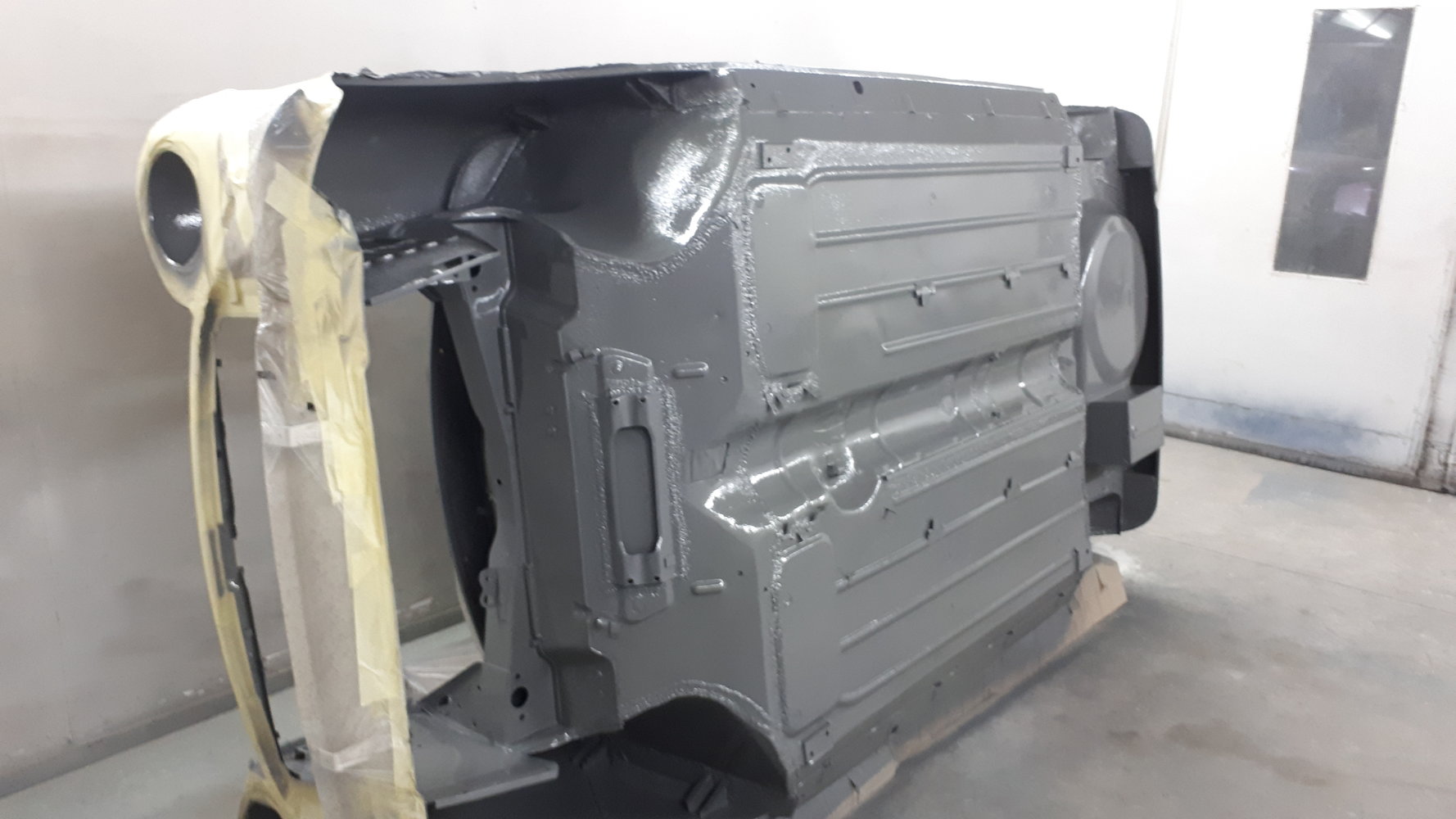

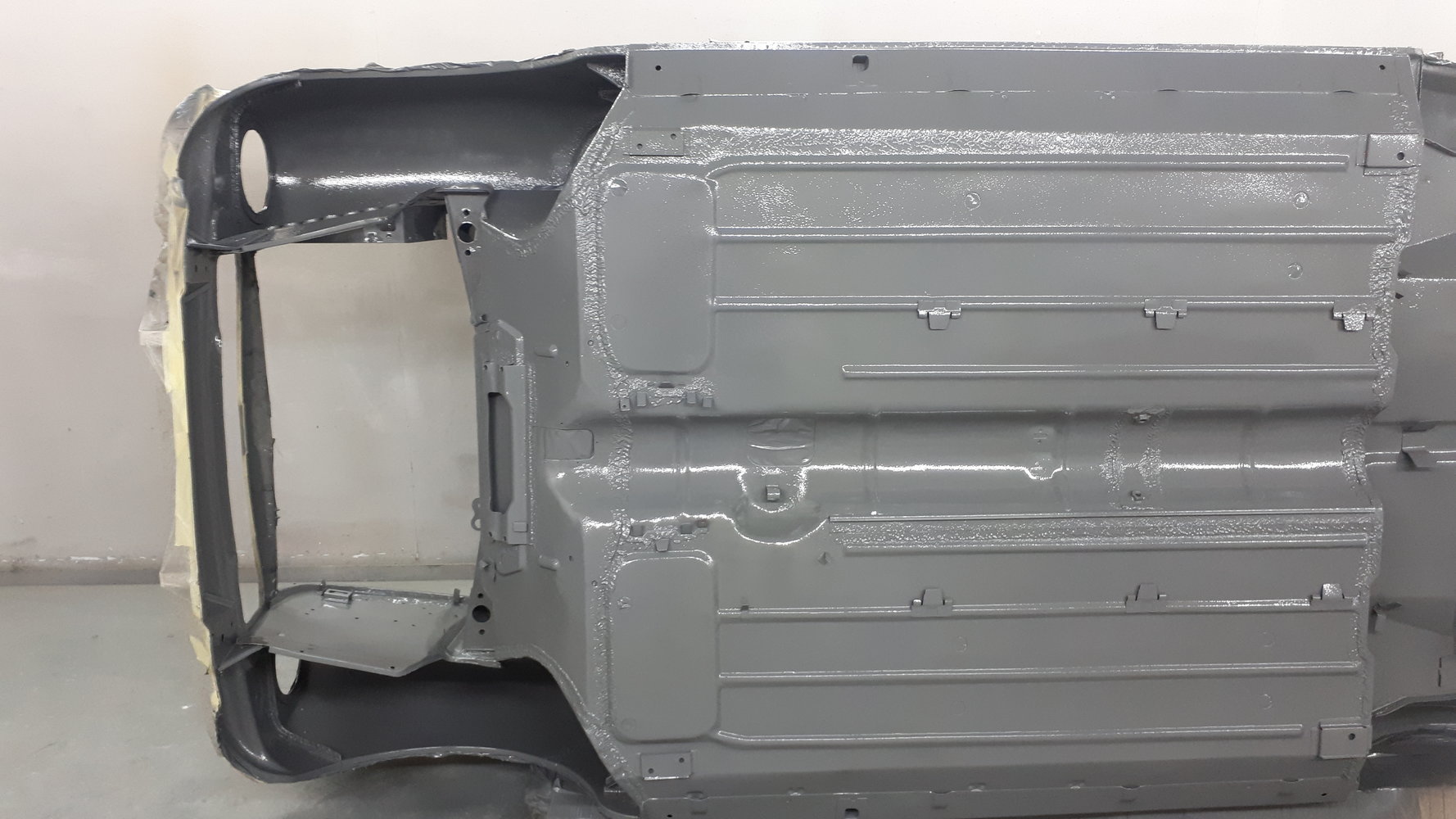

Rolled it onto it's side to give the underside some epoxy primer before filler work
Once that was done it got seam sealed along with some spray sealer over the big seams.
Then some Mipa Protect

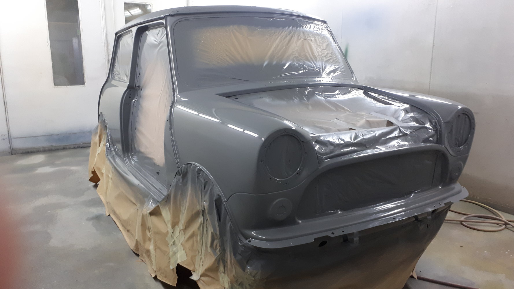

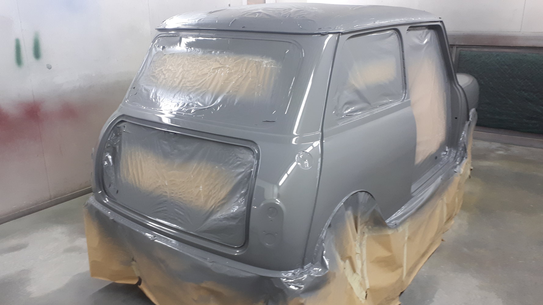

After an hour I put on some tweed grey direct gloss.
