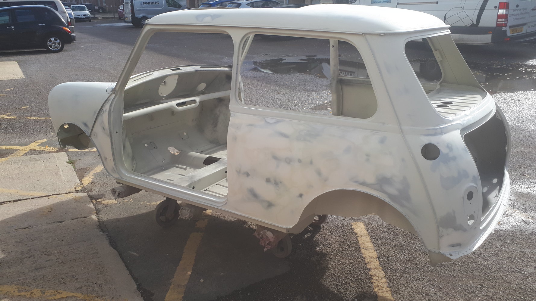

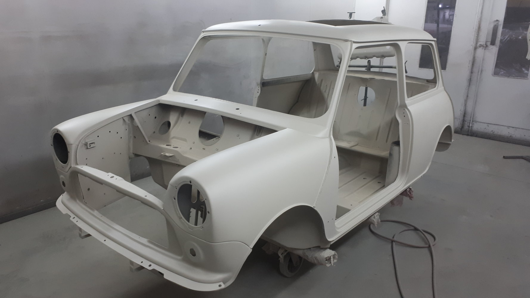

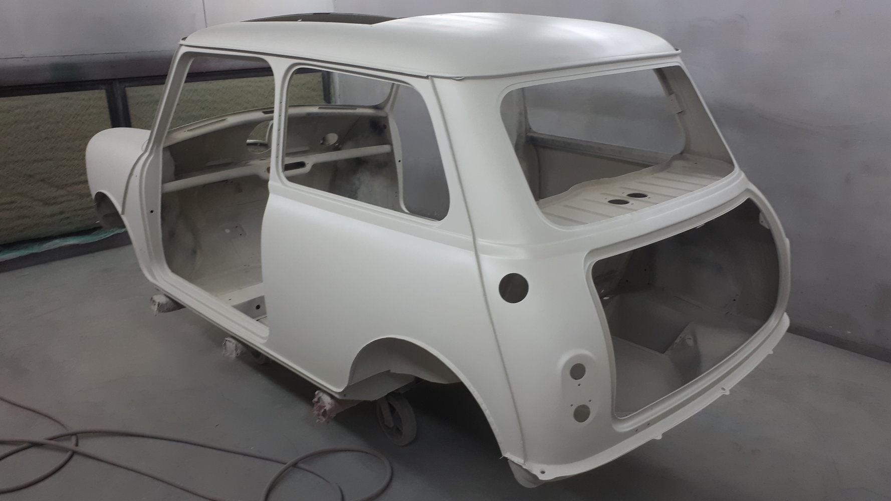

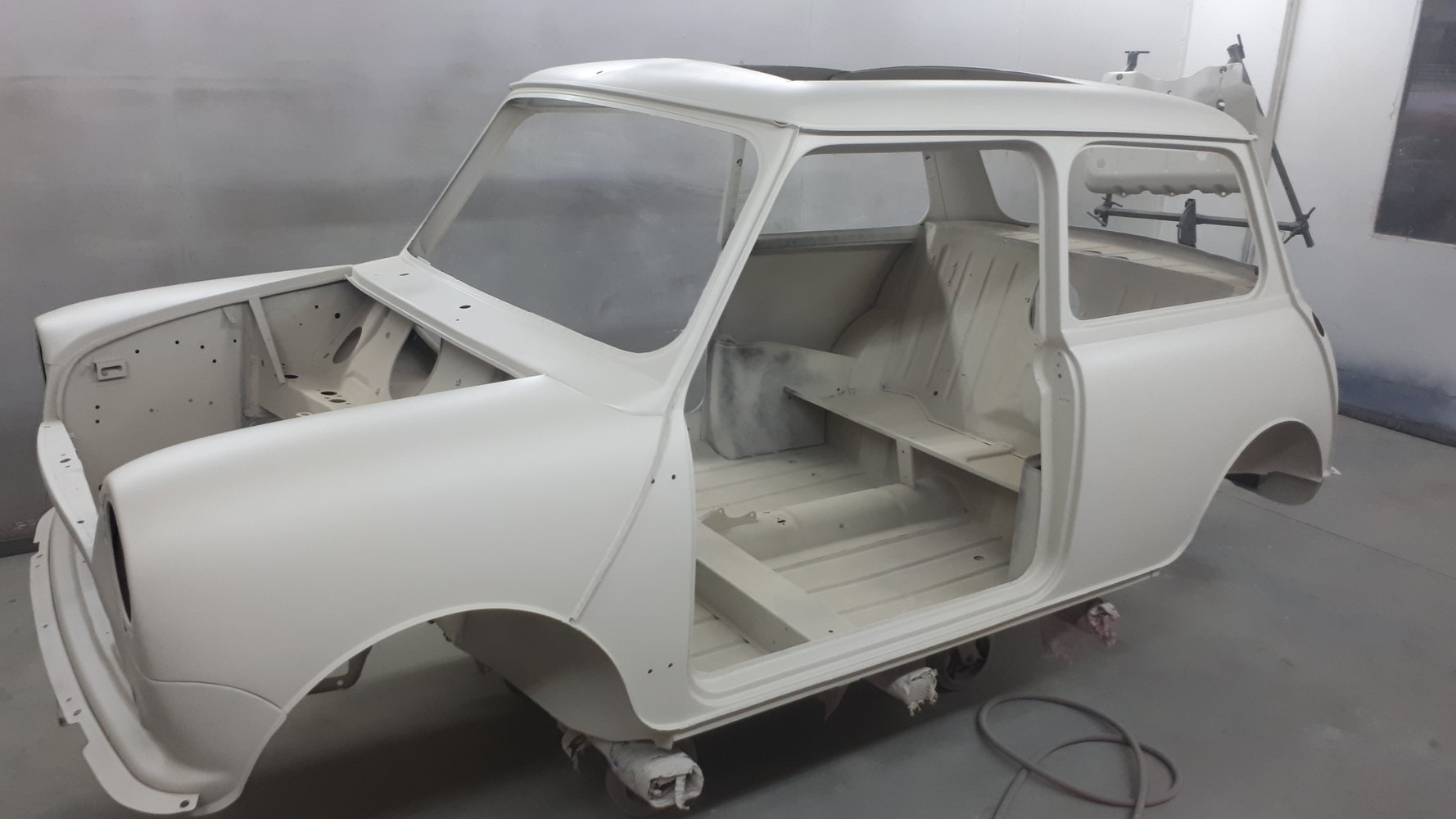

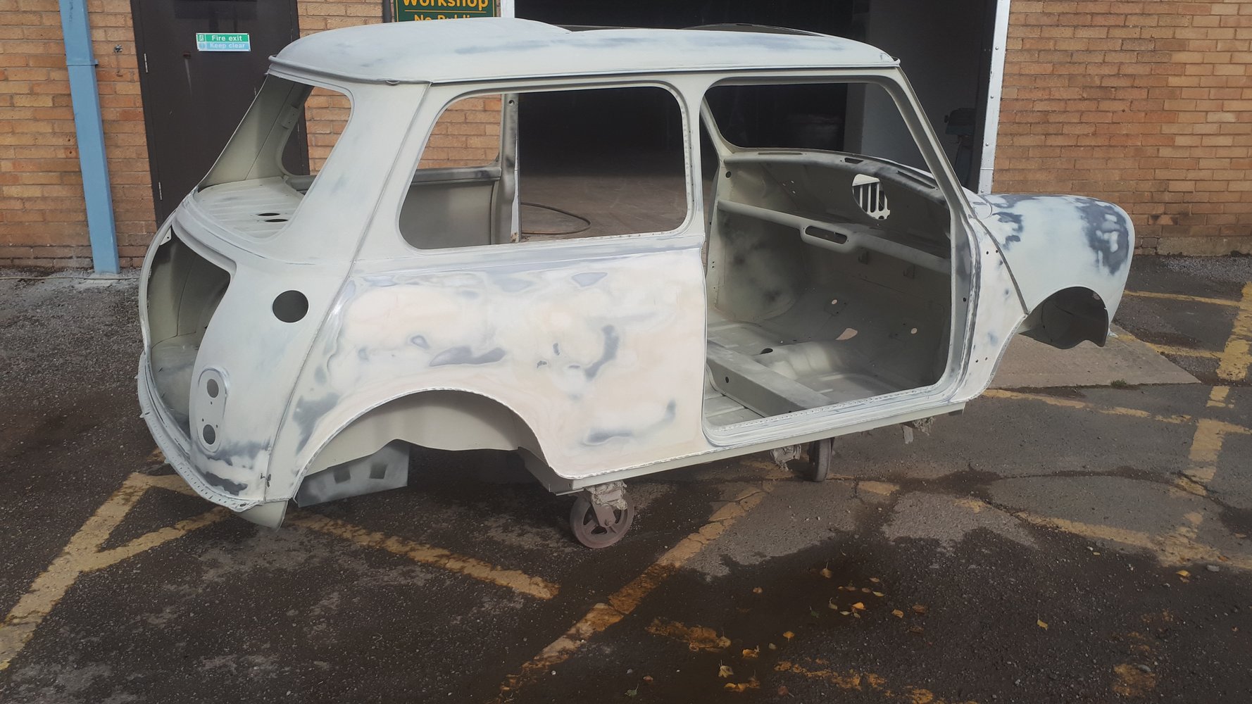

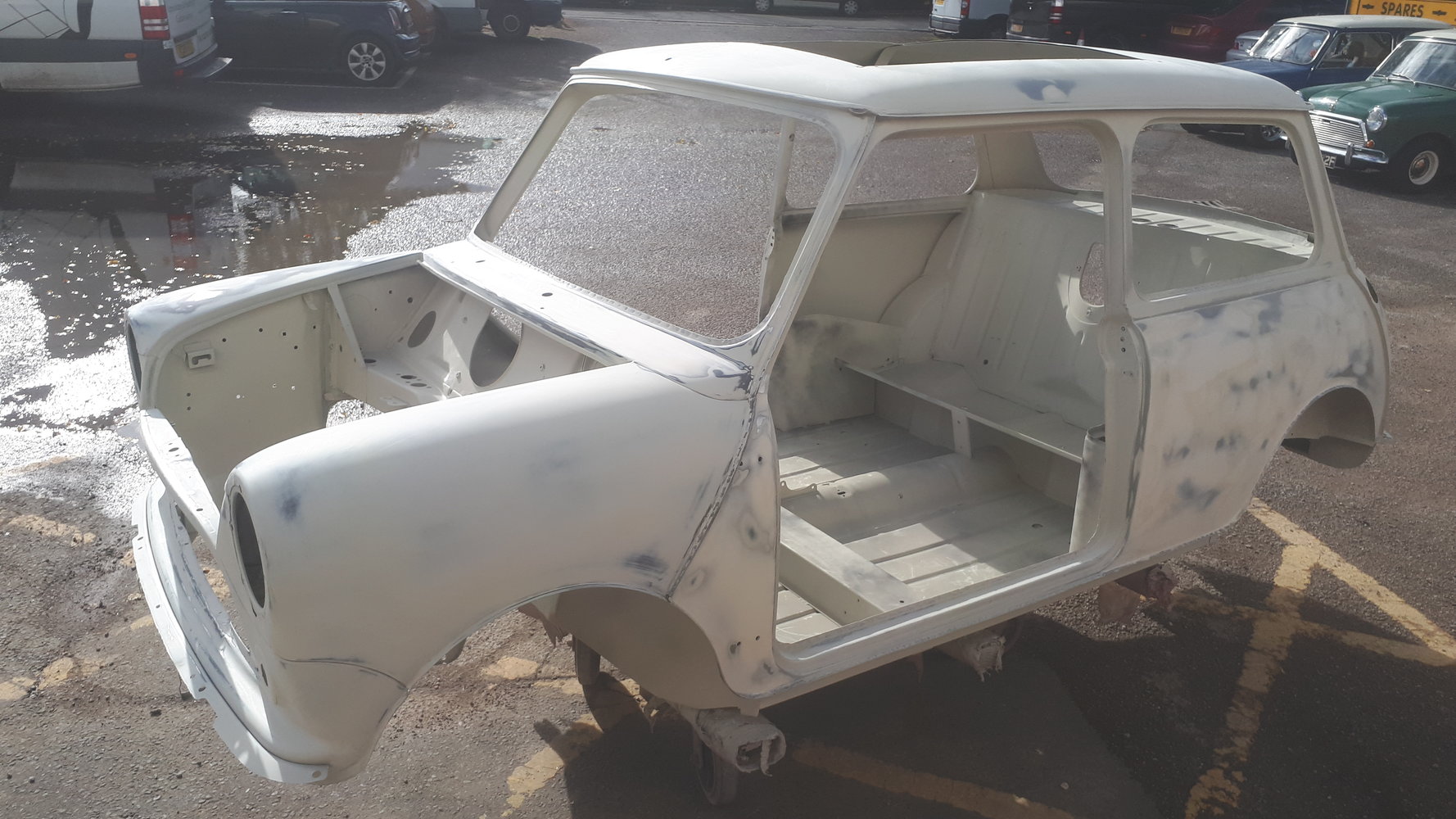

Looks really good, you've gone a lit faster with yours than we have restoring ours.Thank you everyone for your kind comments

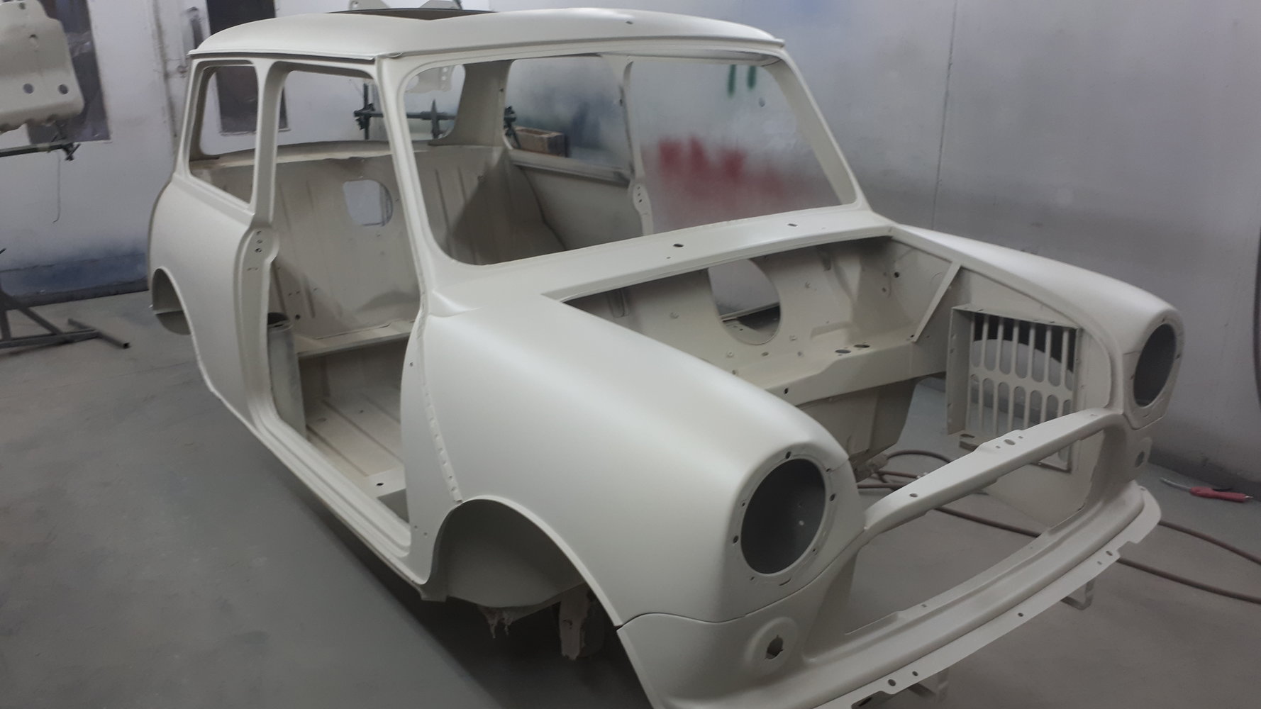

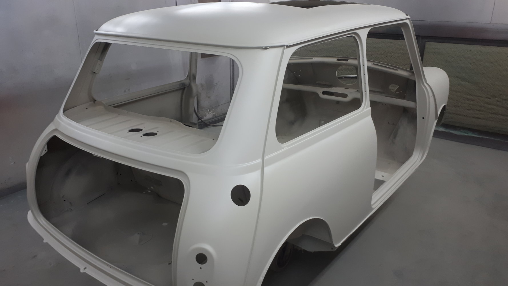

The next job will be filling, sanding and priming the doors, bonnet and boot before turning my attention back to the shell
It does take years I know, where abouts do you do it. We've been doing ours for about 2 years alreadyI do do this as a job. At roughly 35 hours a week a full resto takes 3 to 4 months so quite quick. If it was a weekend at home job it would take years.
Of course, to be honest I though it was your own business with the quality and pace your going atI'd rather not say where I work on a public forum especially as I don't want to advertise for my employer![]()

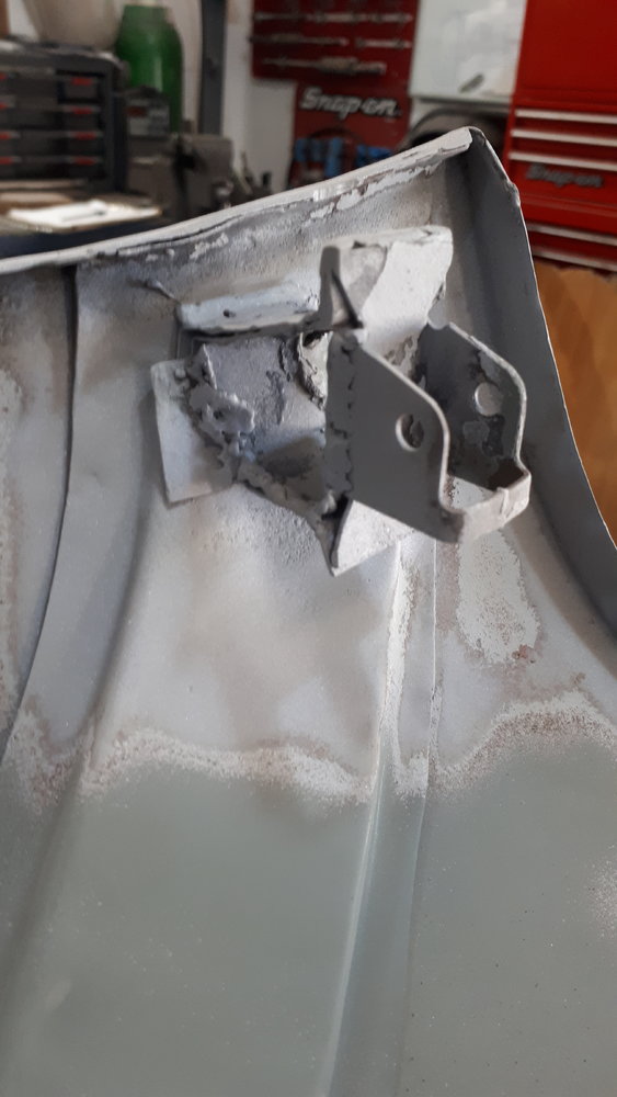

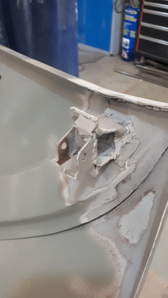

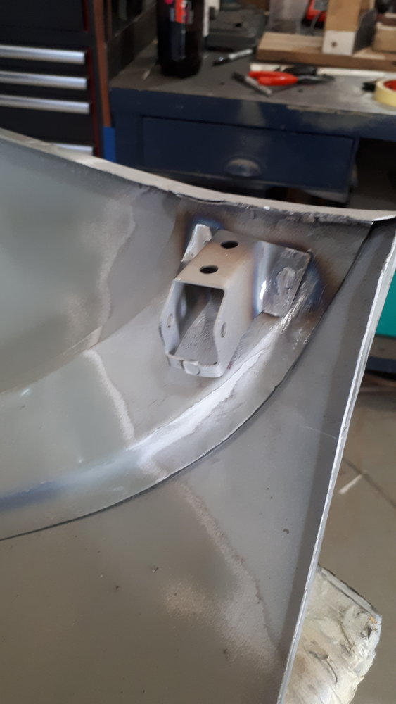

Had my Mk1 bonnet safety catch break off at the spot welds. Not wanting to weld it back on and have to have the bonnet repainted I bonded it on with sikaflex, glad to say it's rock solid!Started to prep the bonnet but noticed this monstrosity for the bonnet safety catch so that got fixed.View attachment 315324View attachment 315325View attachment 315326
