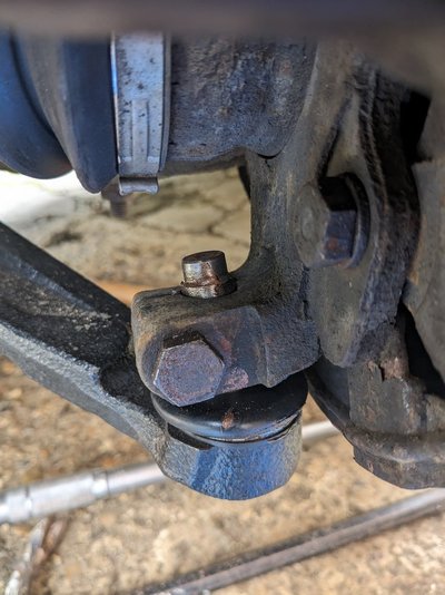

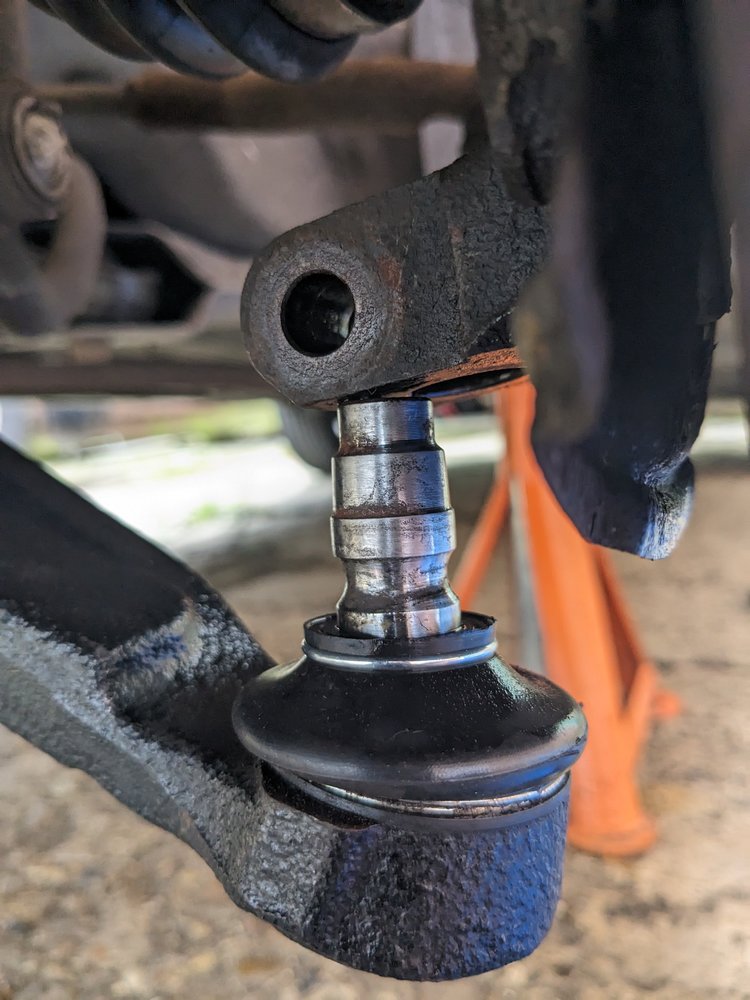

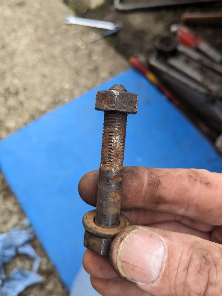

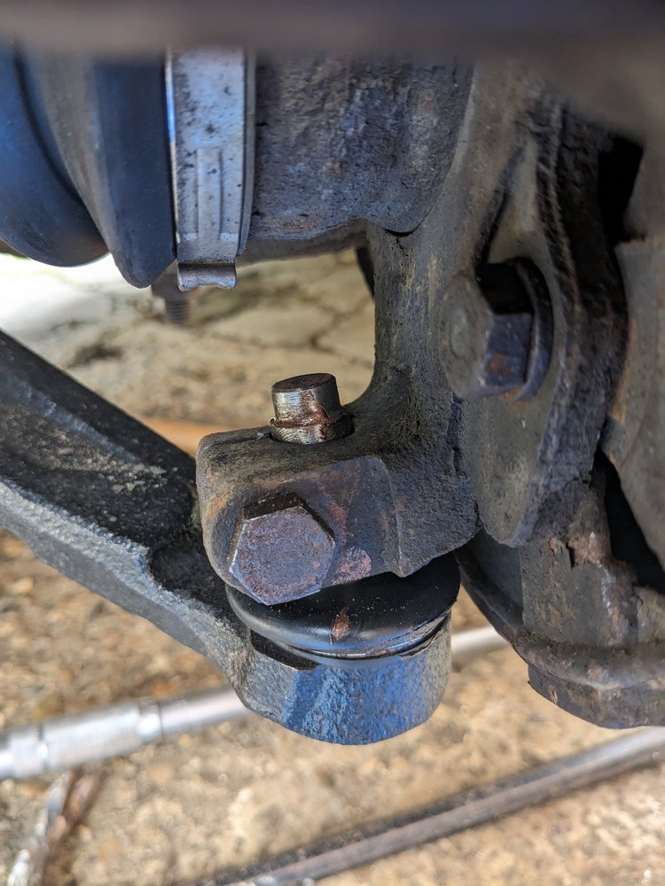

That's now's fixed!
You can see where the monkey has bashed the bolt past the wrong section of the ball joint instead of the scalloped part.
I also found a loose bolt that holds a part of the chassis in place that must come out to change the wishbone so paranoia made me strip out the whole thing to check the rest of the bolts. That includes removing the front bumper that I've only just put back on
Everything is now good but I'll replace that pinch bolt asap.
