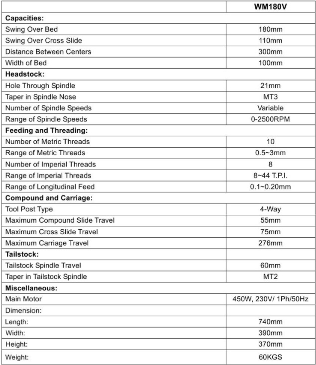

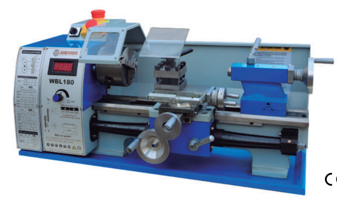

Thw WEISS WBL 180. I think is the same than a Warco 180.
The weiss has brushless motor, tampered bearings and metal gears. I don´t have idea abput how to check if is properly adjusted, so I bought this one. 1.113€ (Including shippings).

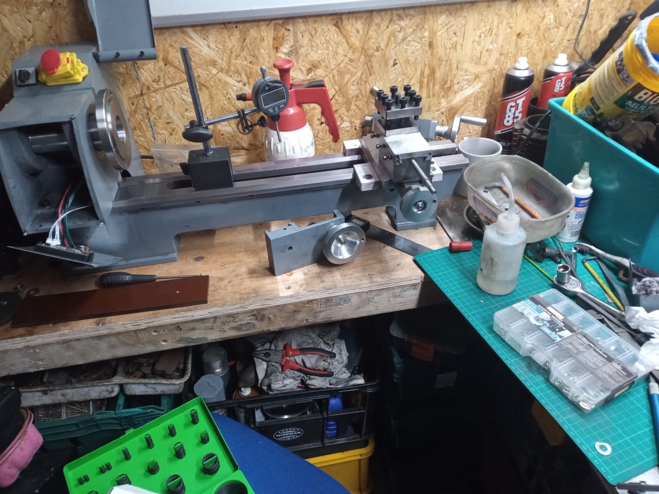

If you've still got the apron off there's a simple mod that may be worth doing now. When I got a minilathe a few years ago it was ok except the apron gears were exposed at the back so swarf got in making the traversing action jumpy. All it needs is a thin bit of ally plate hacksawed and filed to shape and screwed to the back of the apron casting to shield it.
