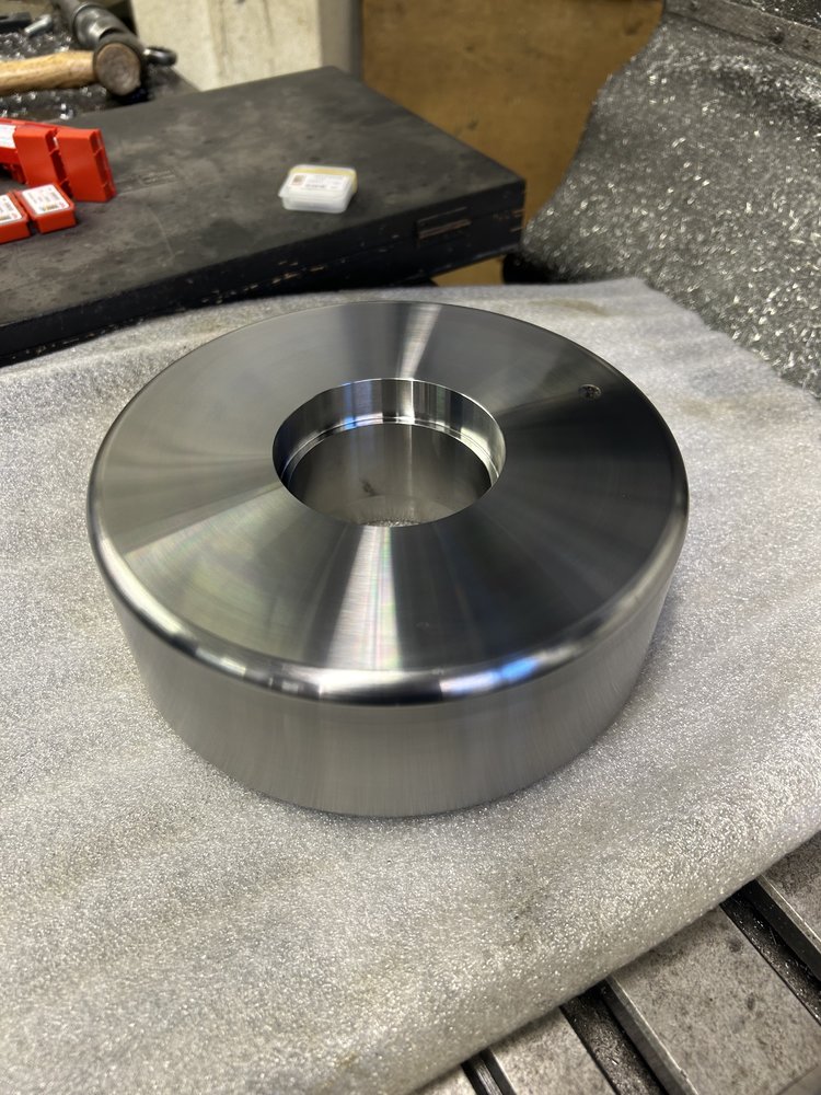

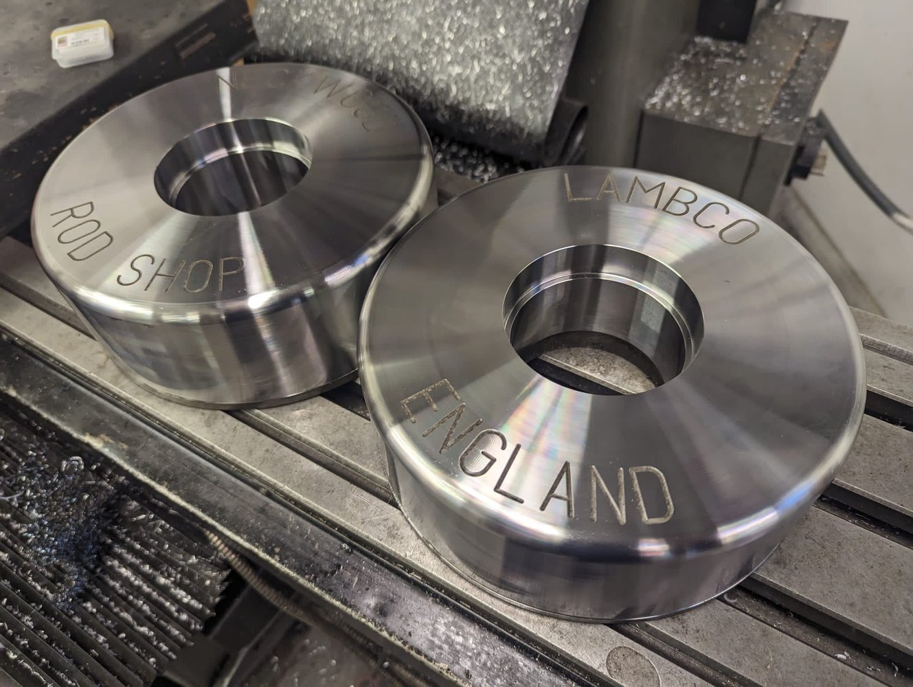

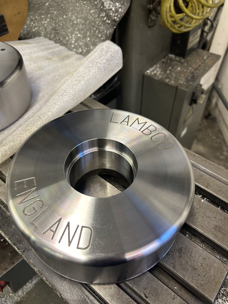

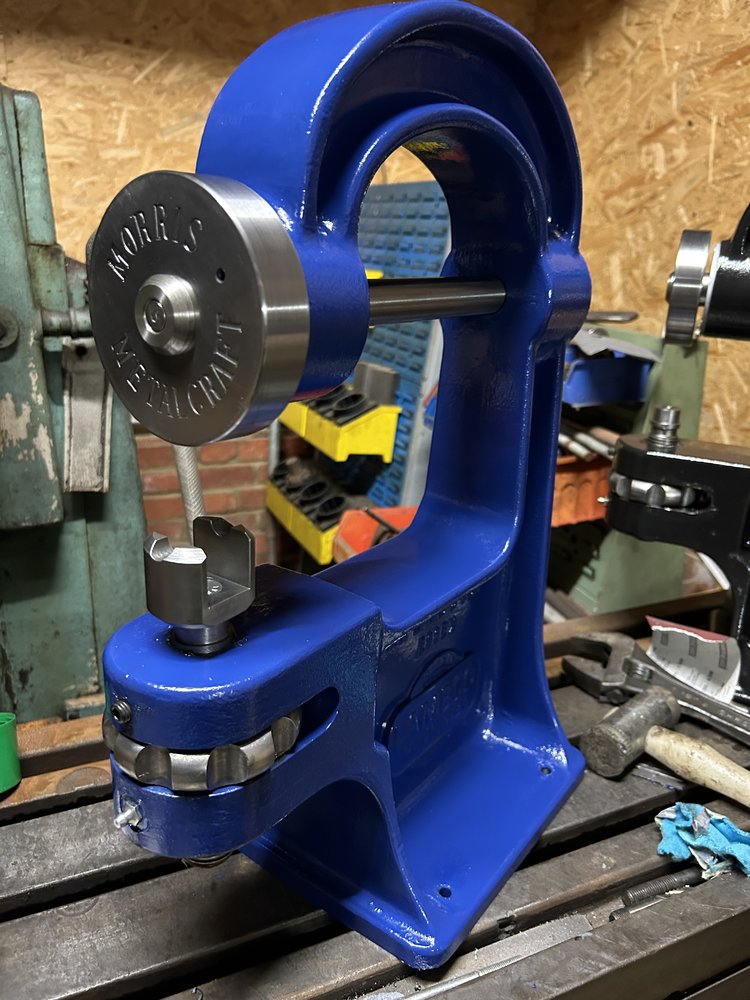

That’s a lot of zeros!Top wheel and bead roller wheel hub mounted on shaft and ground to zero (.0000015) run out
As hub is 3 morse taper repeatability should be very good
I’m still getting my head around this ultra precision stuff, that’s a squillionth right?
