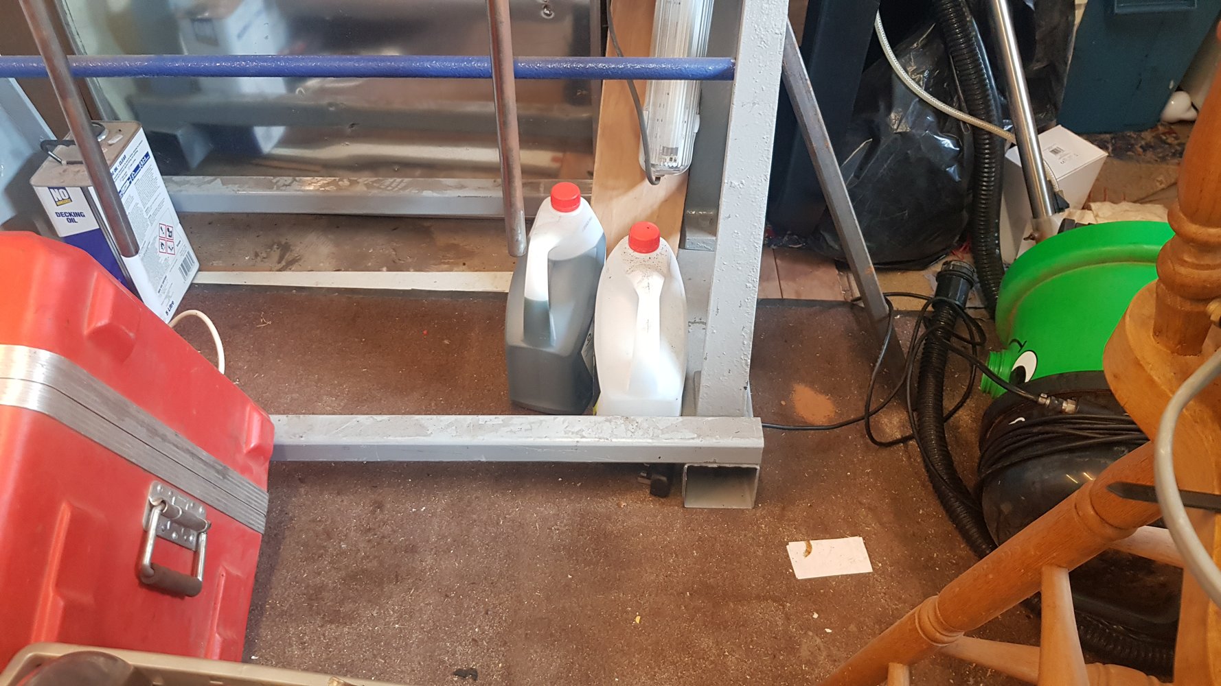

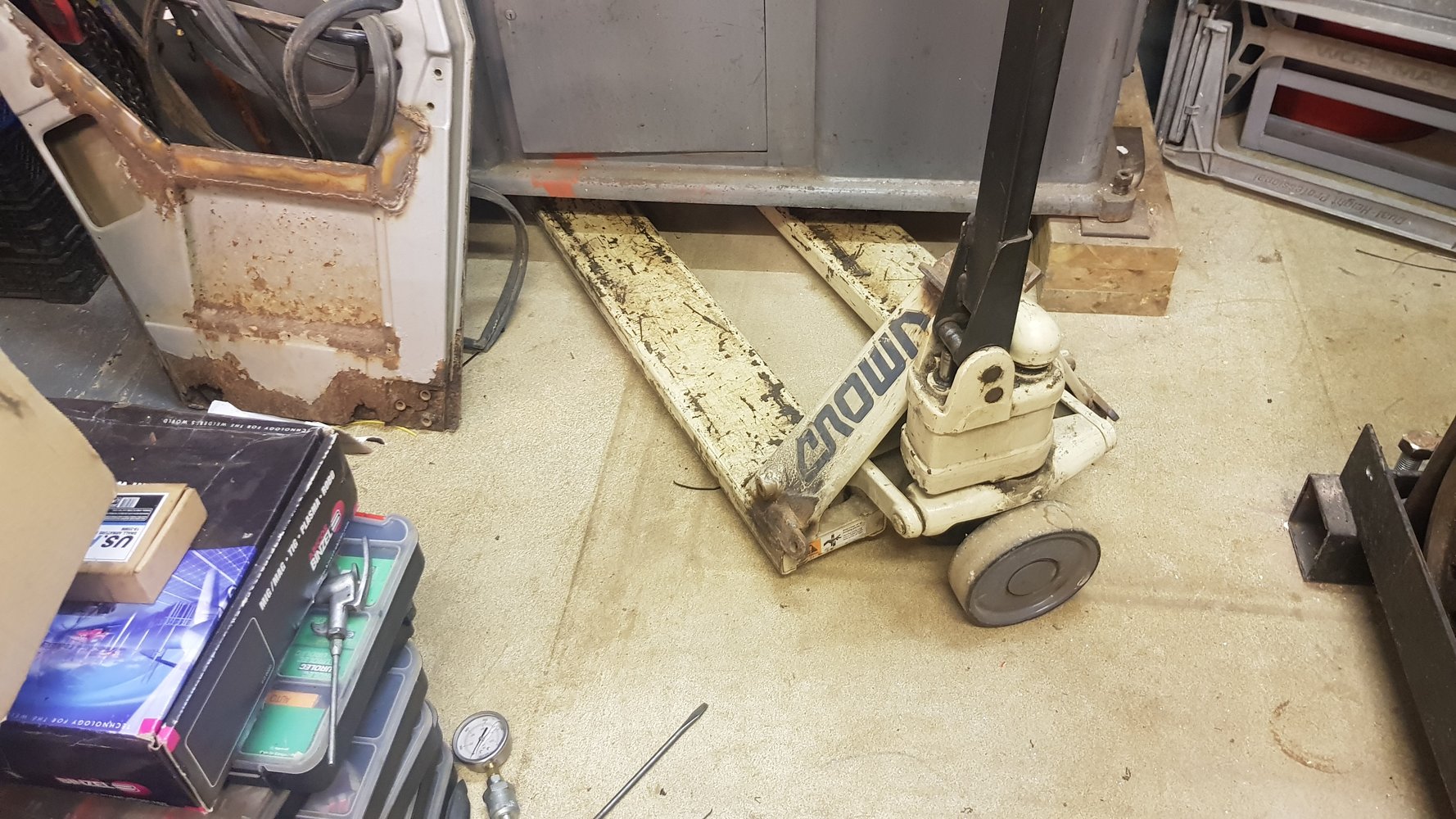

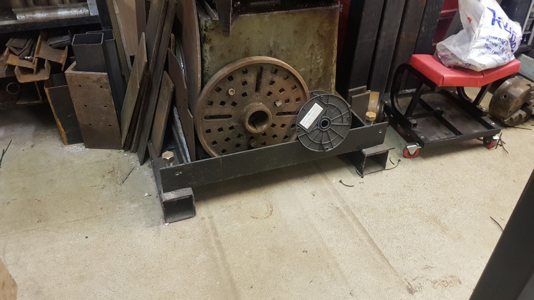

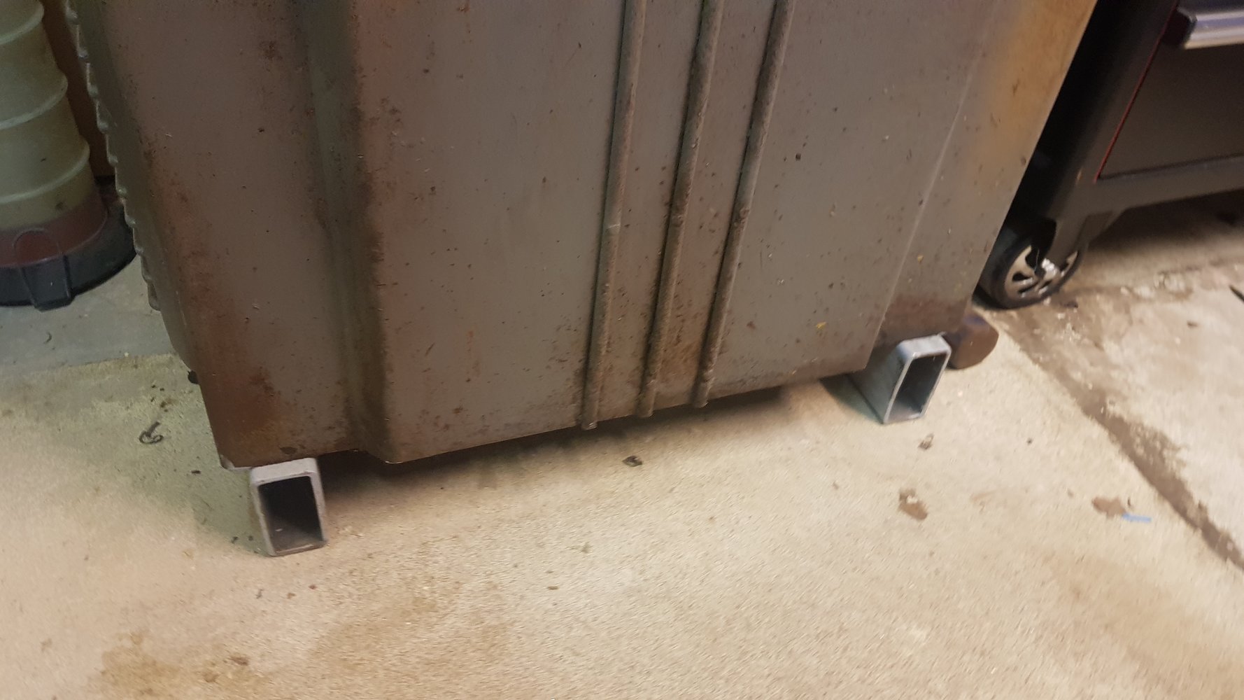

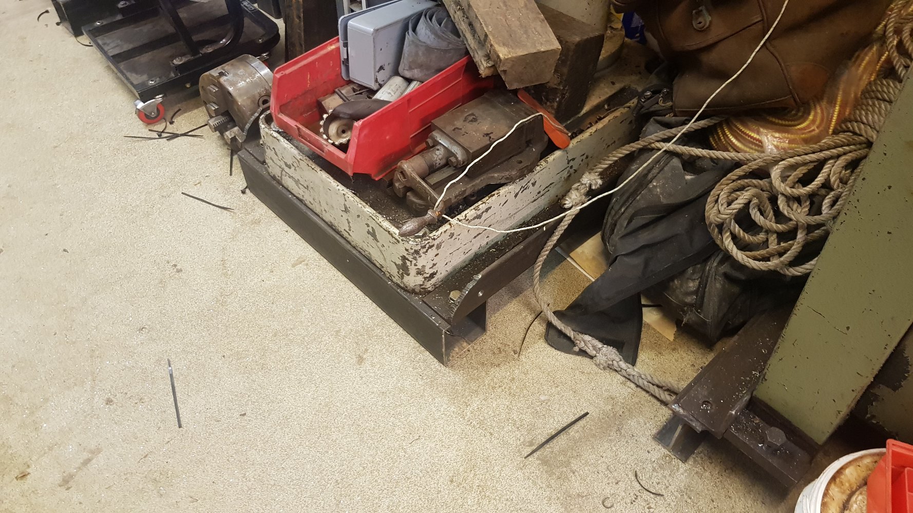

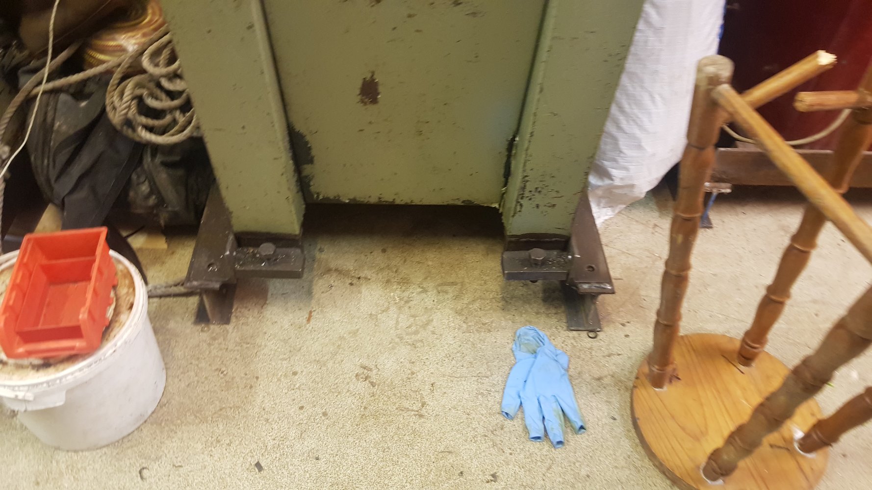

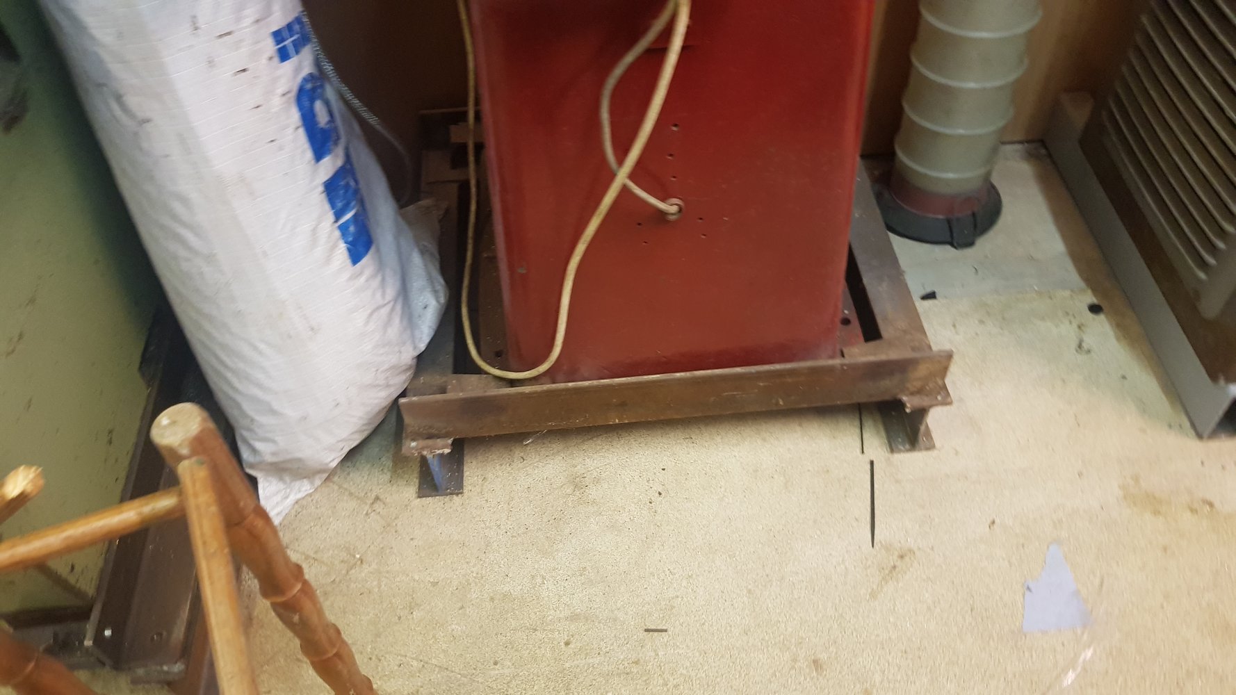

If you have room or a place to store a pump up pallet truck, I built frames for all my large machines except my lathe which sits on stacked 8" x 2" woods.
Simply pick them up and move them, makes it a doddle to take the machines outside if you ever want to power or steam clean them. Re-arrange the workshop or just clean it.
