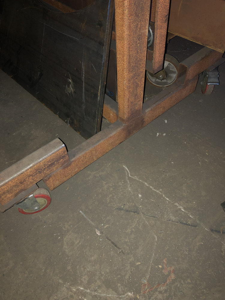

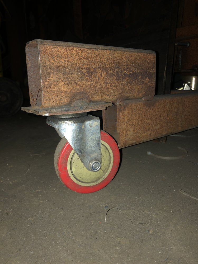

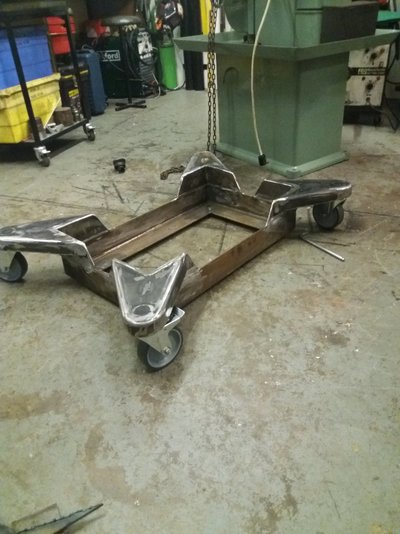

That's sort of what I was thinking if you have a pic that would be helpful.A low wide c of g is needed. I did this with my steel rack so I can move it about. This is the side view but you get the idea?
can take more pics if you want.
mine was 80x50x3 box as that’s what I had.

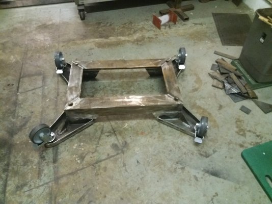

or build a frame with fork pockets on and buy a pump truck. Mine is one of the most used bits of kit in the workshop even though I can nick my neighbours load all when I need to.

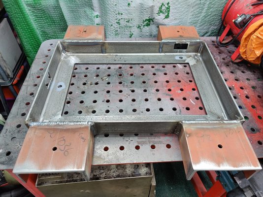

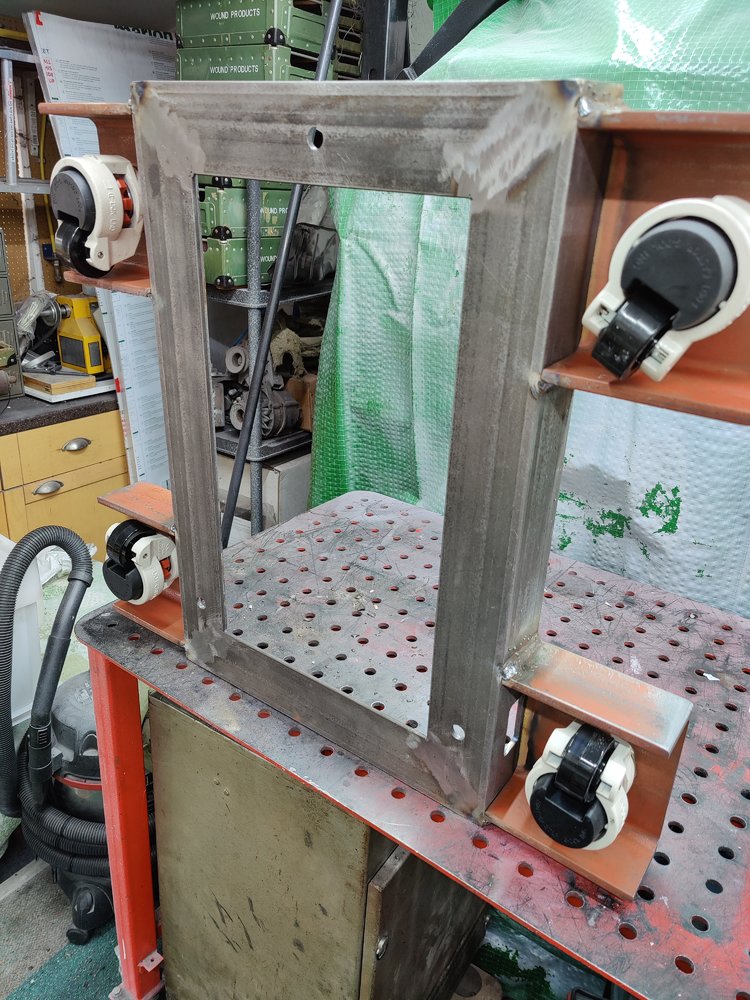

The machine has four holes for levelling feet so I could use big bolts in those. I need to figure how to float the mill in mid air whilst fitting the cradle so they could work double duty....Would some sort of jacking mechanism to lower frame to floor once moved be useful? Less likely to move when in use?

The machine has four holes for levelling feet so I could use big bolts in those. I need to figure how to float the mill in mid air whilst fitting the cradle so they could work double dutyWould some sort of jacking mechanism to lower frame to floor once moved be useful? Less likely to move when in use?

That's a good idea. Probably need fine pitch bolts as is a heavy beast.If possible I would have a frame with castors sitting slightly above the mill. I would have bolts through the holes in the base and welded to large washers underneath or better still a complete plate the size of the base. When I wanted to move I would tighten nuts thus lifting the mill to the frame and then once in place slacken to lower.

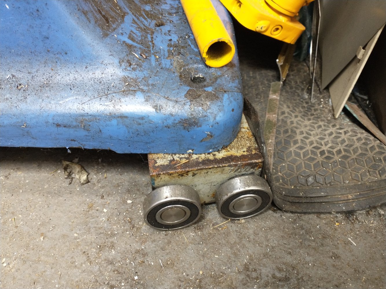

I already have some home made Strongway type skates but they are a pain to use as it's slow to change their direction.im posting this for others

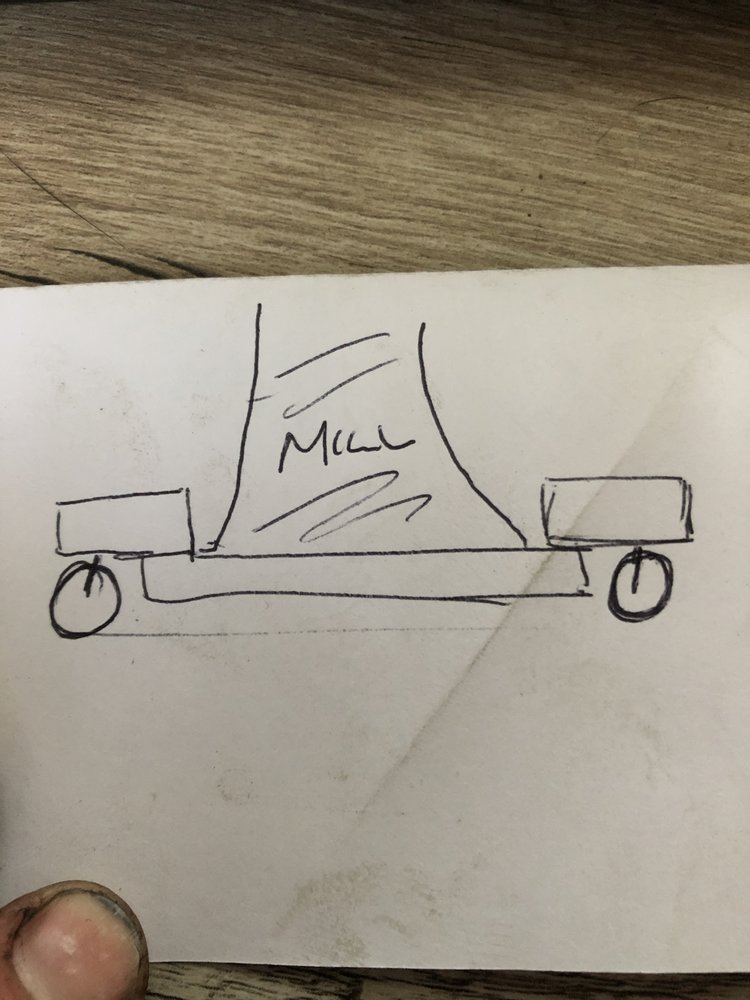

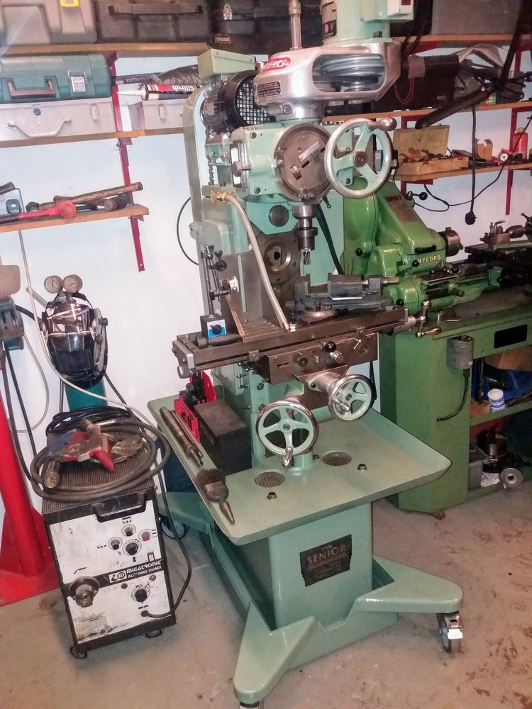

Slightly off topic but do you have the 4 collets for it?I have a medium sized milling machine I'd like to be easy to move. It's one of These
4 heavy duty castors are available and was thinking of some sort of cradle with a perimeter frame for the castors.
Any ideas?

Err nope it's an MT3 taper I think. I've got a milling chuck and that's about it.Slightly off topic but do you have the 4 collets for it?
Ah I thought they were all a proprietary taper. I only have a milling head for mine. Strangely I was going to Add some CNC motors but Tinbasher Dan was interested before Covid. Not sure if he is still interested but I still have all options openErr nope it's an MT3 taper I think. I've got a milling chuck and that's about it.
I'm not sure I'm going to keep it, if I have room it might end up being CNC converted at some point.
