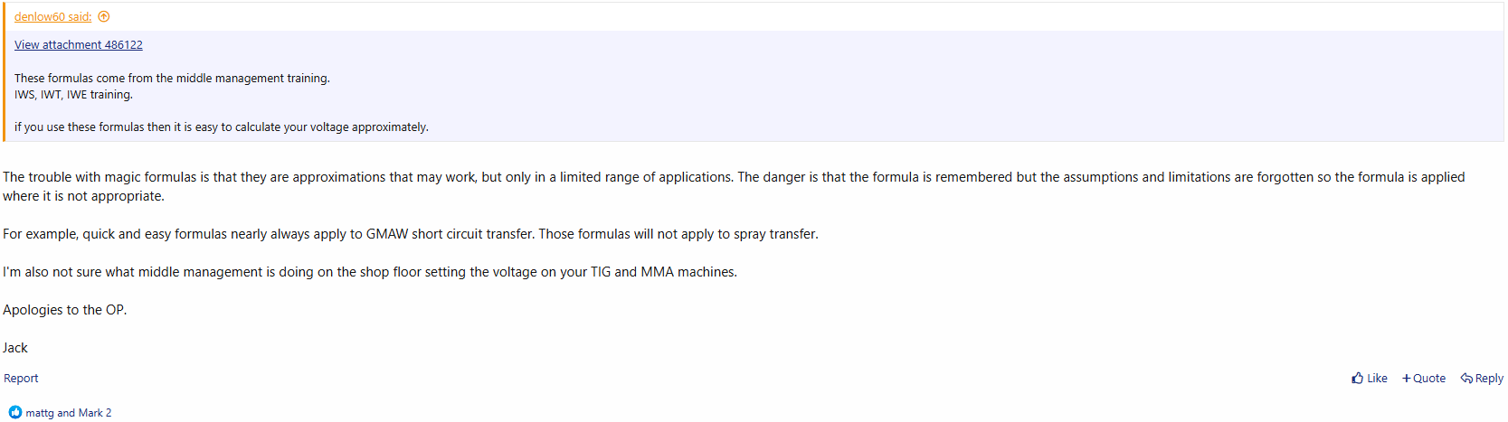

Thanks. Maybe you can share more of the documents?View attachment 486122

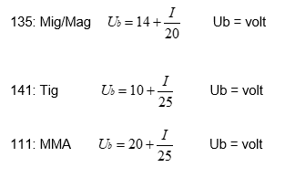

These formulas come from the middle management training.
IWS, IWT, IWE training.
if you use these formulas then it is easy to calculate your voltage approximately.
in our theme here we talk about 0.8 mm wire and this has a range of 200 amp max you should not exceed this otherwise your wire will explode.
other diameters of wire have other values.
