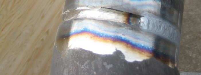

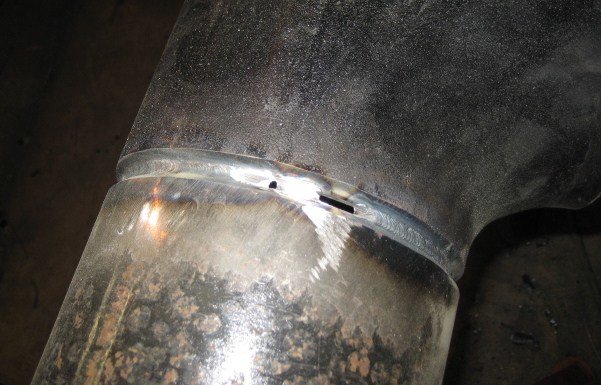

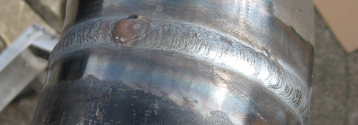

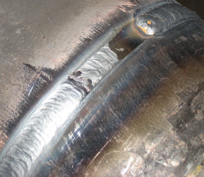

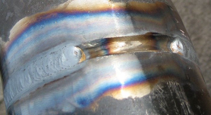

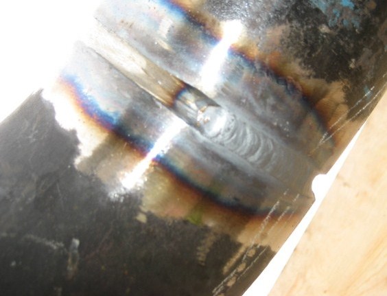

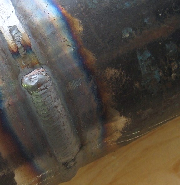

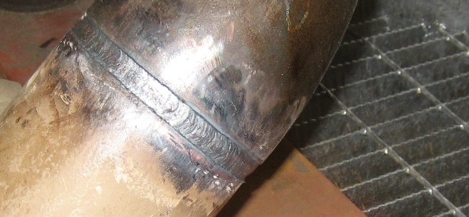

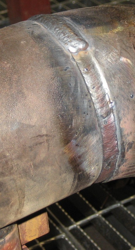

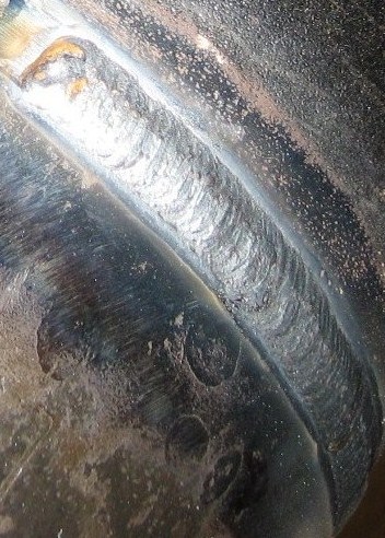

just interested F/J have you ever use the closed root technique?? was having a go on some 2" and although I could just about control the burn through, found it impossible to get the crater to close in just right, I'm sure there a trick using a back purge someone once told me, anyhows I'm no pipe welder so more likely thats the issue
I can tig but not that good, one question though,when your in position how long of a bead can you get before you have to stop and adjust? Oh another question what technique do you use for vertical and overhead?
