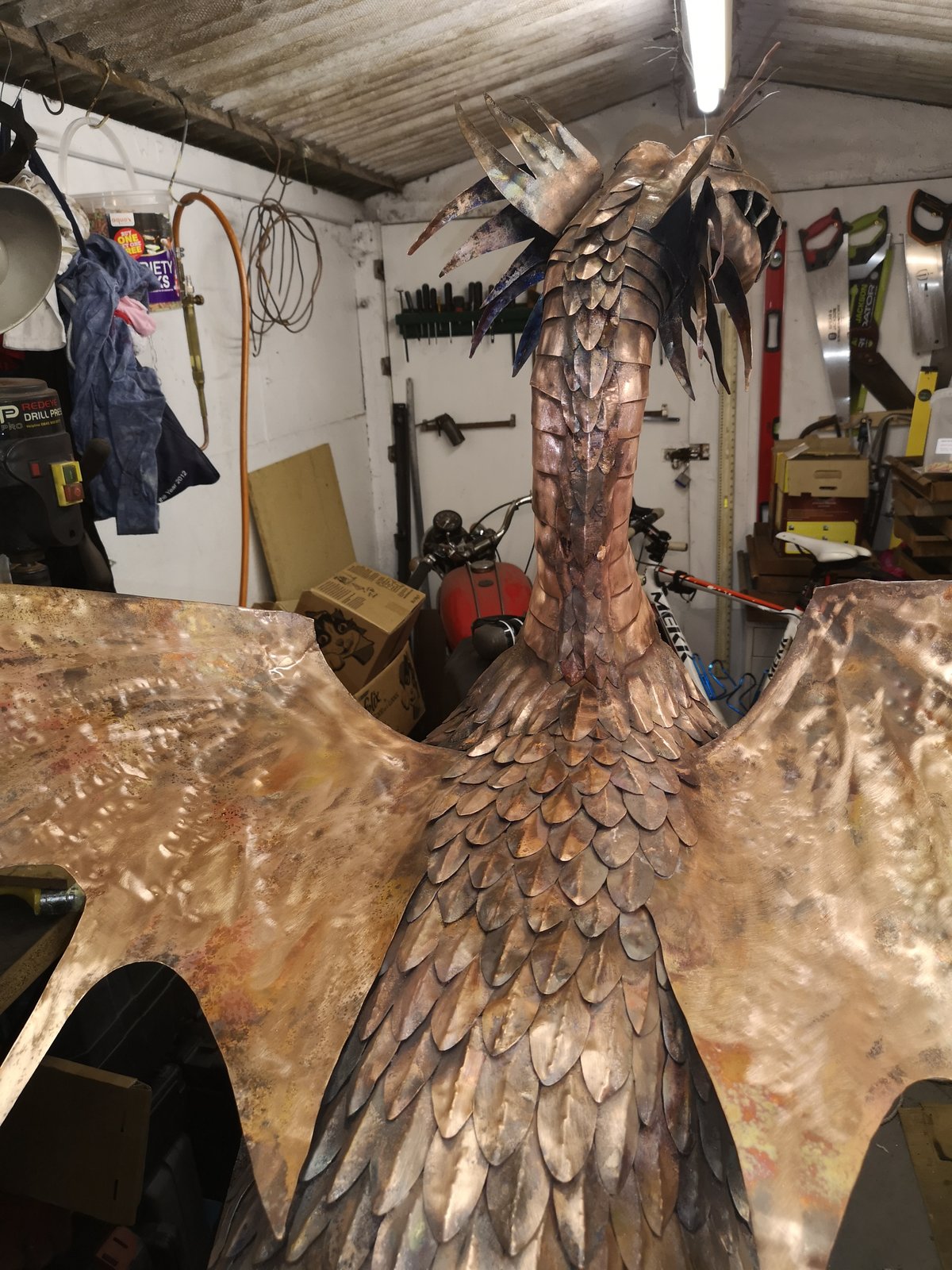

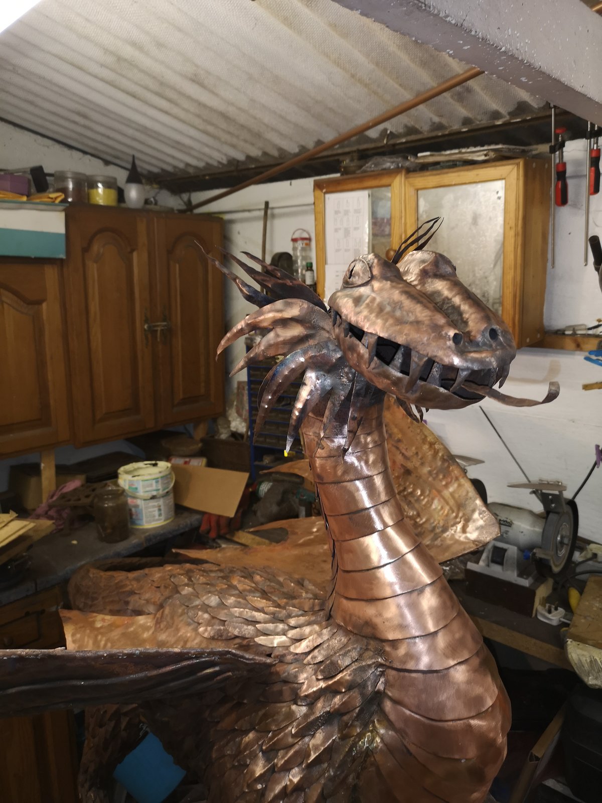

I have a basic MIG welder that can work with or without gas and I was wondering whether I could use this in any way to at least tack them in place prior to brazing. I also have an old AC arc welder.
I have used plain 0.8mm copper wire, argon gas and spool gun. It works but does need a powerful machine.
