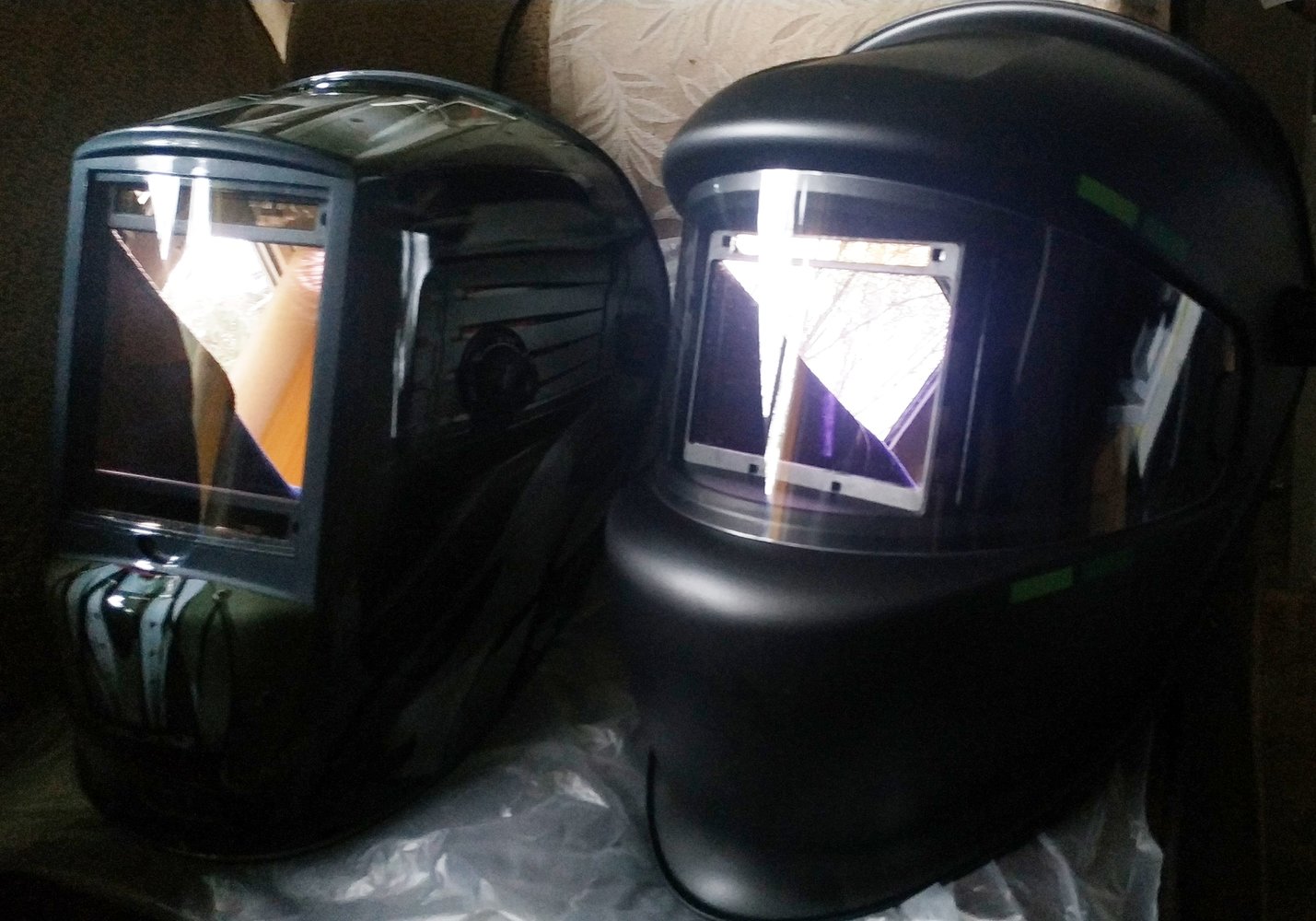

It arrived as a 1/1/1/2, so its not the latest + model. What do you have?It'll be interesting to see what you get - the one in the link has been superseded by GYS to one with a '+' it appears to have a rating of 1/1/1/1 and a faster reaction time.
Mine is the same as yours, I think the 'white' LED torch puts out composite light from one source whereas there are three primary light sources in LCD panel so more blue end of the spectrum will be output.It arrived as a 1/1/1/2, so its not the latest + model. What do you have?
While the amazon is 1/1/1/1, I cant really tell the difference between them except the amazon has the iridium mirroring on the outside, they are the same looking through side by side.
I havent tried welding yet.
They share a very similar adf design apart the lid shape. The amazon is more comfortable but slightly less secure, and smaller.
