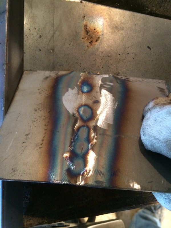

make yourself some of these butt welding clamps they will make life much easier letting pieces of steel in

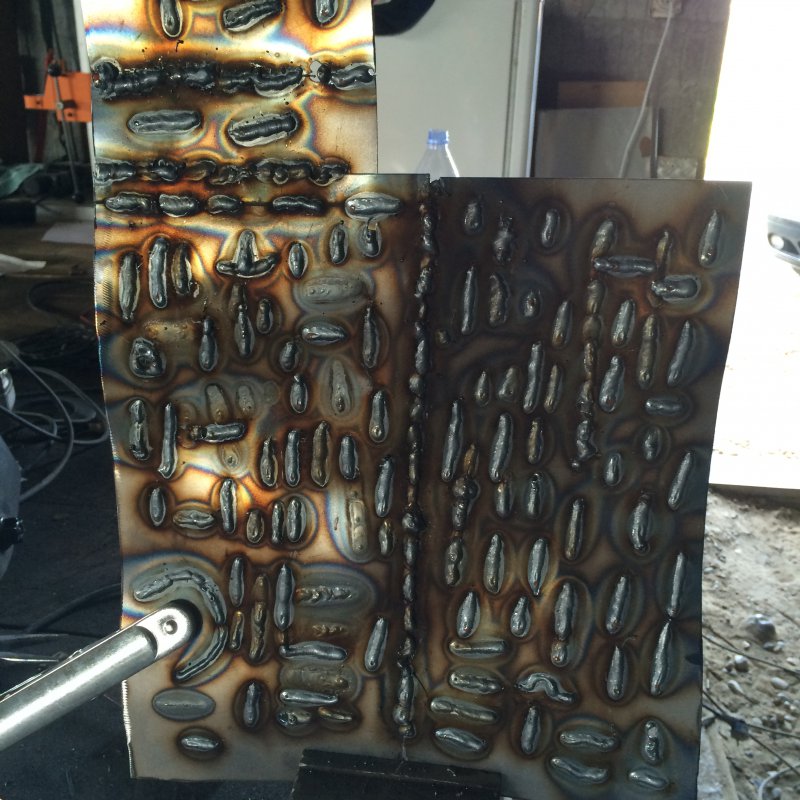

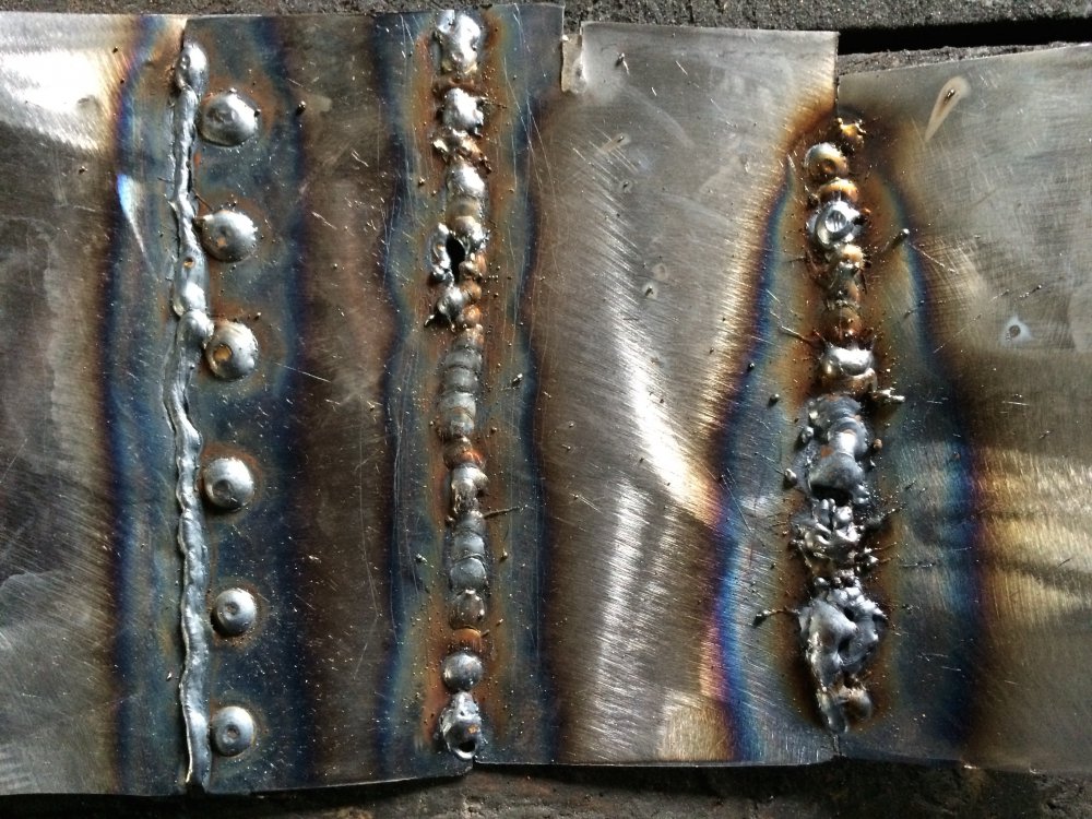

On the air gun, you weld a bit then blow over the work with the air gun, it's two separate processes. So just do your short weld then go over with the air gun.

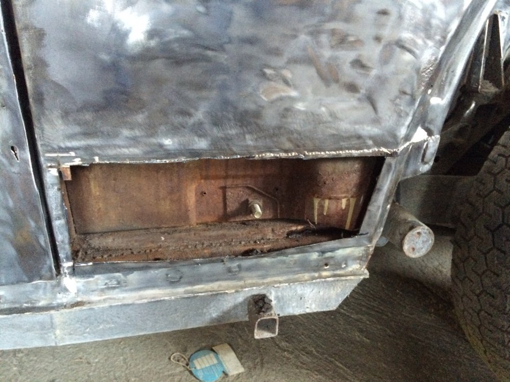

You will get plenty of practice of chassis welding on the Classic Range Rover in the back ground
I'm quite happy to say this is not my project but my brother's project... If needed I'll give it a try but the future of this RR is not yet defined (my brother already did a convertible classic).
No RRC should be scrapped, rebuild it.
