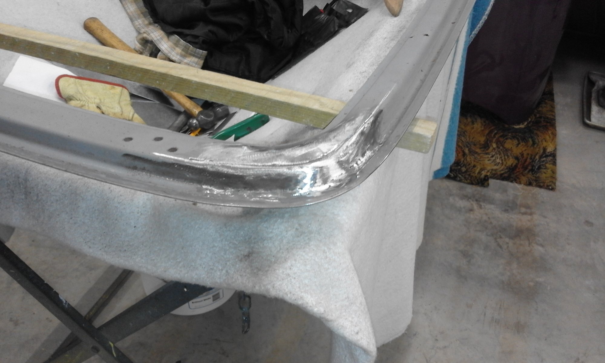

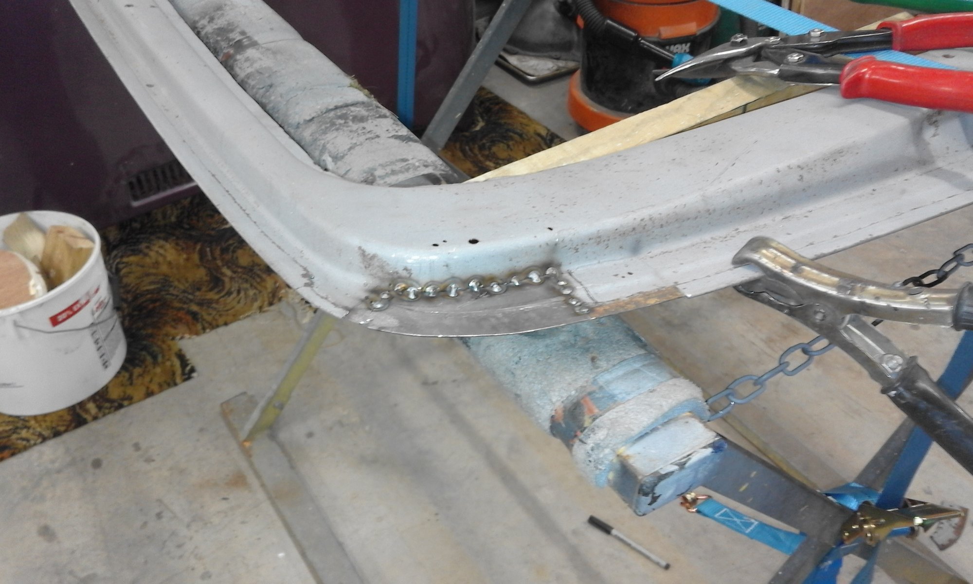

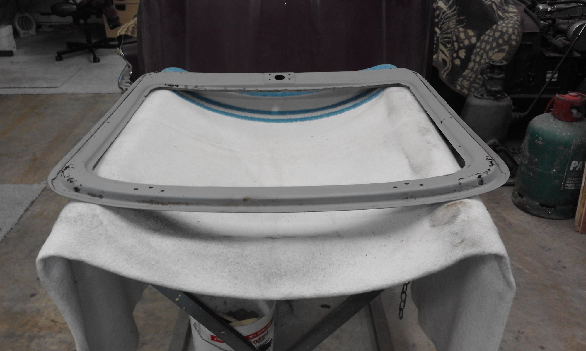

@RWD3M back in my younger days SW Classics used to make a replacement front roof section for the GT6, they packed up shop many years ago and no idea if anyone else makes them.
They were handmade and had a pretty good body work guy who made them with an English wheel
Welding them in was fun trying to keep distortion at bay
