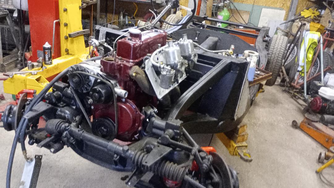

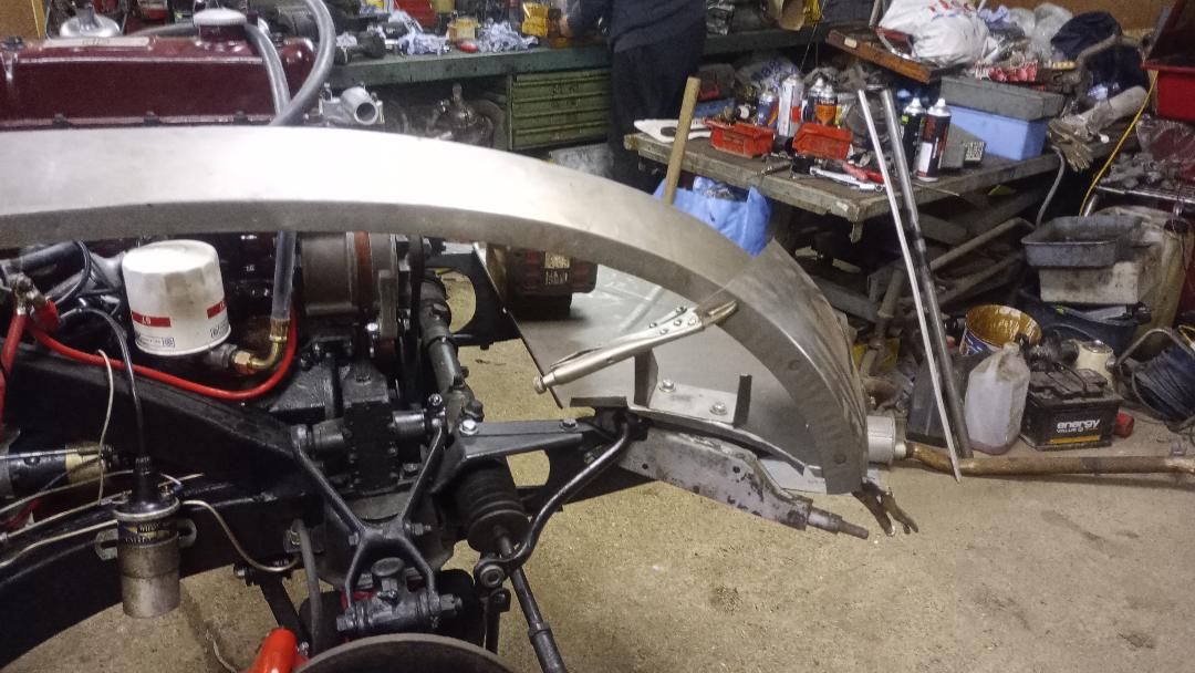

The engine may be running next week, and then again it may not be! I am not aiming for a show winning restoration, the "original" red leather will be going back in with just a recolour, some is actually original and some was sourced used in the 70's, new, better carpets will be ordered, I am unsure about the dash as it has a crinkle black finish that is it seems not correct, maybe someone changed it early on due to glare from the body colour (OE White) facia, on balance I will probably leave it black,Matchless.

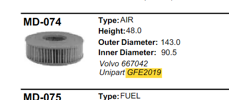

GFE 2019 but also has K1094, could be old stock as there is a sticker on one box offering a swatch watch for £8.99 inc. P&P send a cheque before 29th February 1984.................Are you sure the number is GFE 2019?? cant find anything in the 3 or 4 books I have
Nothing in my book but online it appears to be a Volvo 667042. More info: https://www.skandix.de/en/spare-par...GTJ05imAlll59dcgF2IJ1WytkkaWODVV8XZxmMbW8DSMCGFE2019 does come up on google but not what it's for. I keep meaning to check my filter book but I keep forgetting.
Jackpot, as the first set of filters were in for 50 years I may not need to replace these but if I do at least I know what to look for!Nothing in my book but online it appears to be a Volvo 667042. More info: https://www.skandix.de/en/spare-par...GTJ05imAlll59dcgF2IJ1WytkkaWODVV8XZxmMbW8DSMC

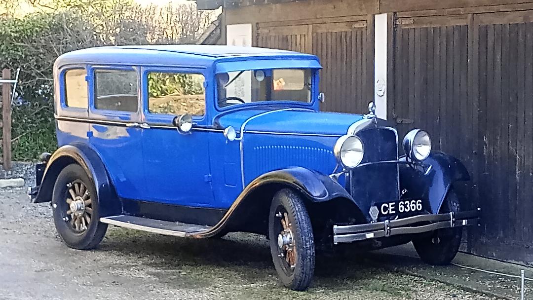

Dodge now runs and drives, lights work,Took a day off from the MG, I towed my 1929 Dodge home from the council garage it has been sitting in very unloved for the last 6 years, it has suffered a bit but was actually far better than I thought it would be! I had to stop driving it when my shoulders started to get very painful. I am trying to get it running again and probably next year tackle the list of jobs that needed doing before I parked it. The starter solenoid has died so I mounted a spare pull cable MGA one and made up new battery leads, fitted new points, new battery going in tomorrow, then may look at the water pump leak, bleed the brakes and see how it runs! It is nothing as nice in the flesh but will come good.
