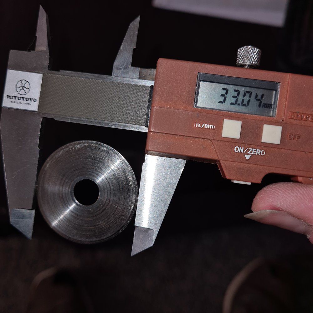

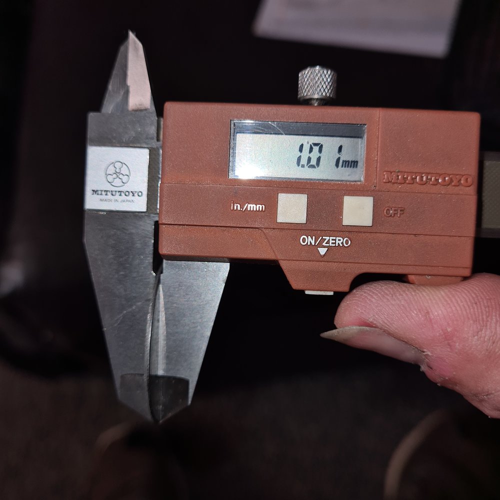

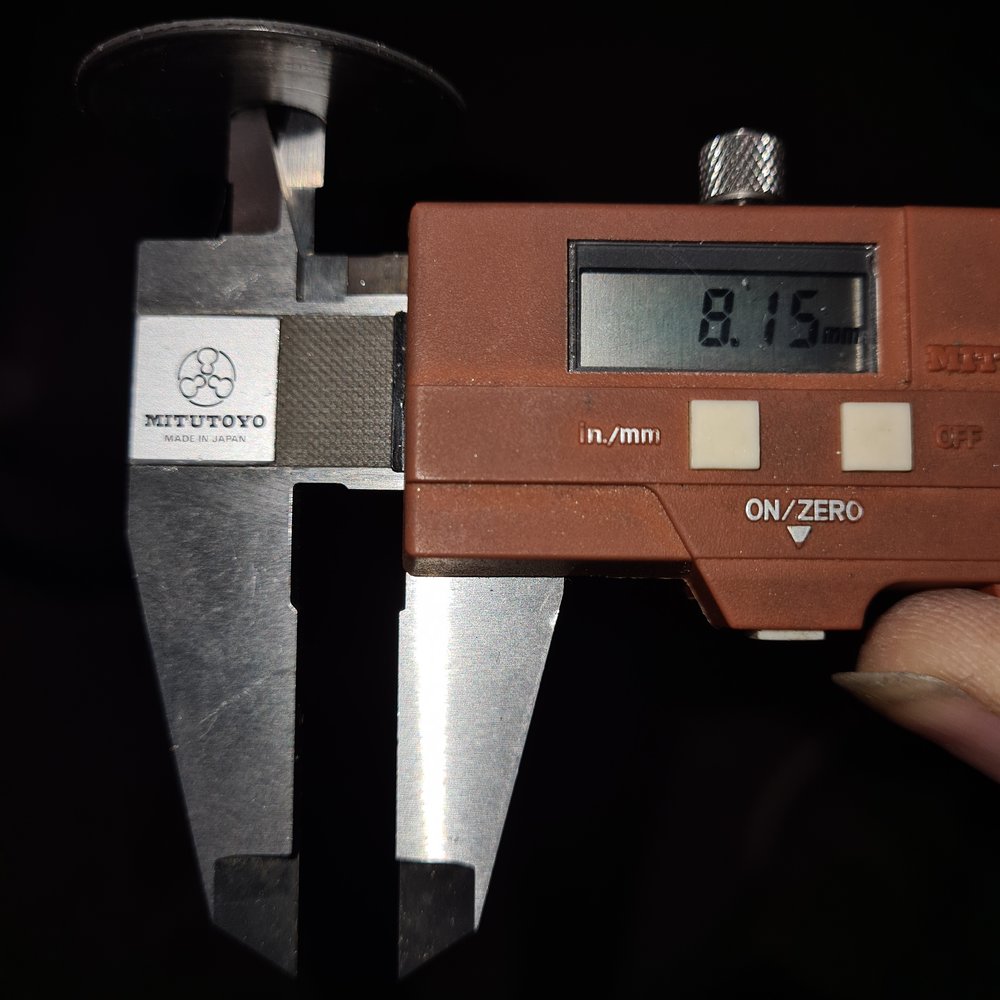

This is the shim that's in there at the moment
And there's to much slack in there I'm ideally looking for 2 x 0.75 shims
Or 1x .5 and 1x1mm shim I think will do it
ive got penny washers but thats going to take off ..8 mm off to get the .5 shim thats a lot of work rather just buy one for a couple quidlooks like a big "penny washer" local nut and bolt supplier may have something to modify?

also the one thats in there at the moment is 1mm the total i want to put in there is 1.5 mm hence 2x 0.75 as i need one on the top and then one on the bottem and remove the 1mm
or add a 0.5 shim to make the total 1.5 split
its for a hedge trimmer that keeps throwing the gear mech so im hoping adding extra pressure top and bottem will stop this
