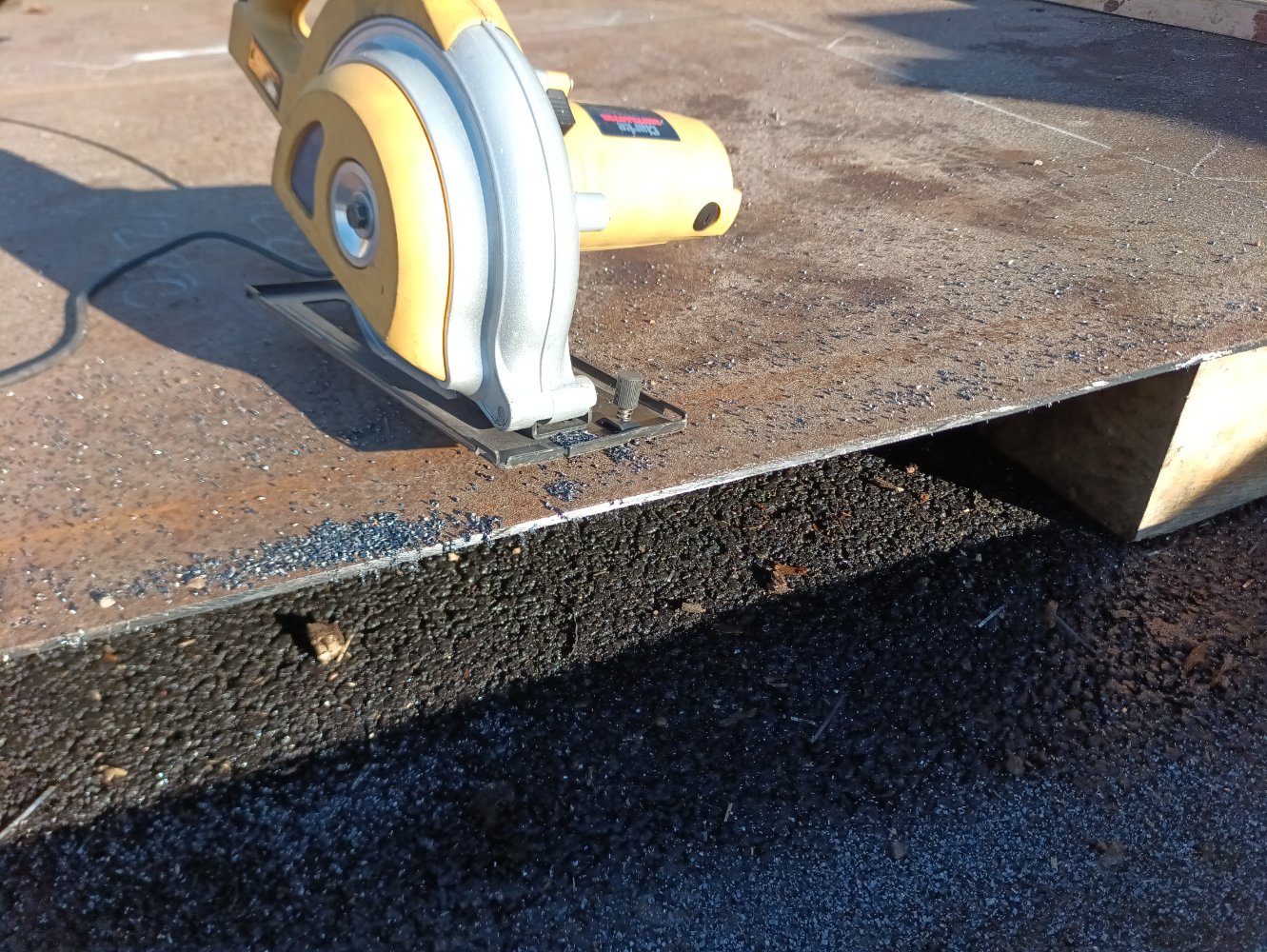

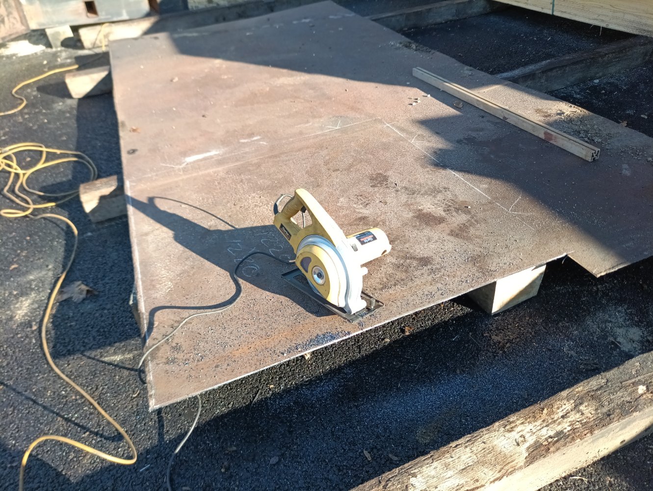

So,a little update,even if it is late
I bought @Wozzaaah beast,and it works
Cut this yesterday
No sparks just loads of hot chips,does what it meant to do,BUT,it fights back,so need to have a firm grip and keep it flat,my only gripe was the amount of chips it spat out in front of my cut line,then again one should always look ahead of the cut
BTW thats 8mm very rusty pitted sheet steel,and no nasty burr
