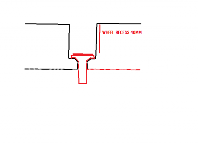

weld a nut on it ?...blast weld into the centre,allow the heat to penetrate a little then undo with a socket,difficult part is centralising the nut in the well so a socket will still fit,I'd use a mig on a high setting,
Good luck....![]()
think i will pop out and see what room i have to get the biggest nut in i can so a socket will fit in aswell,
