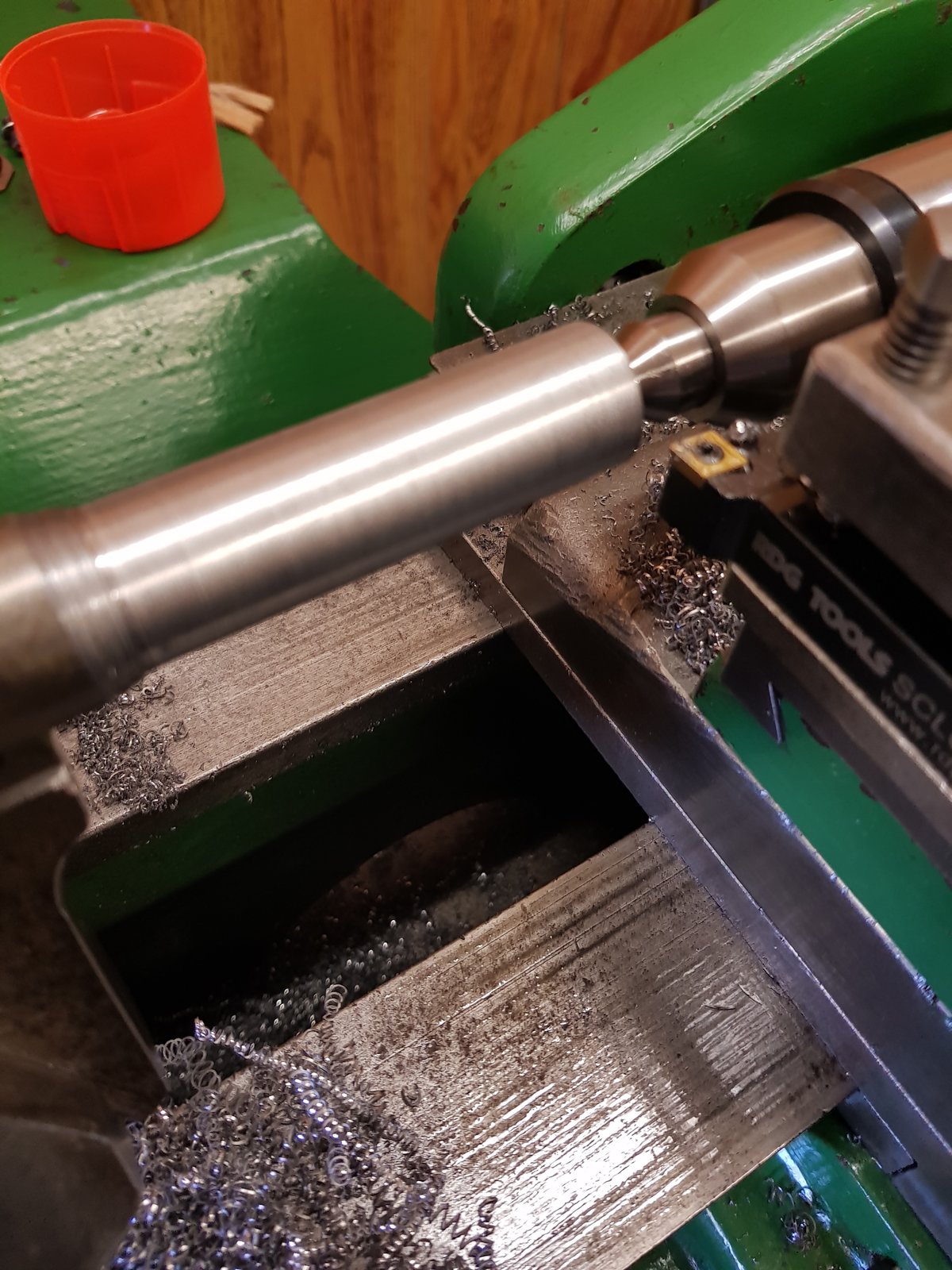

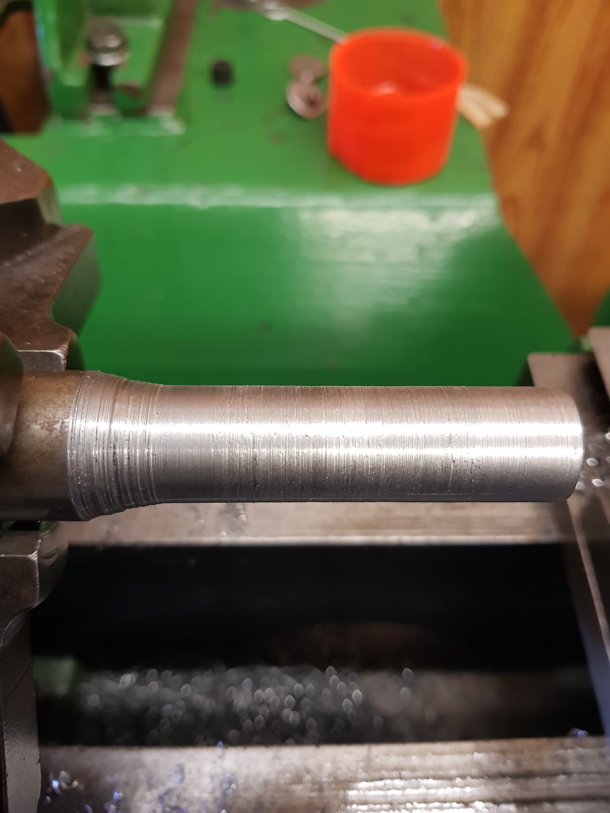

I’ve just timed mine on it’s slowest speed spencer. I literally keep it at this travel speed for everything as it always seems to produce a nice finish with the small cuts my lathe will take.
At 50 revolutions of the chuck my apron has moved 5.1mm. Whether that’s right or wrong I dunno but I’ve no intentions of changing it as my finishing is lovely.
