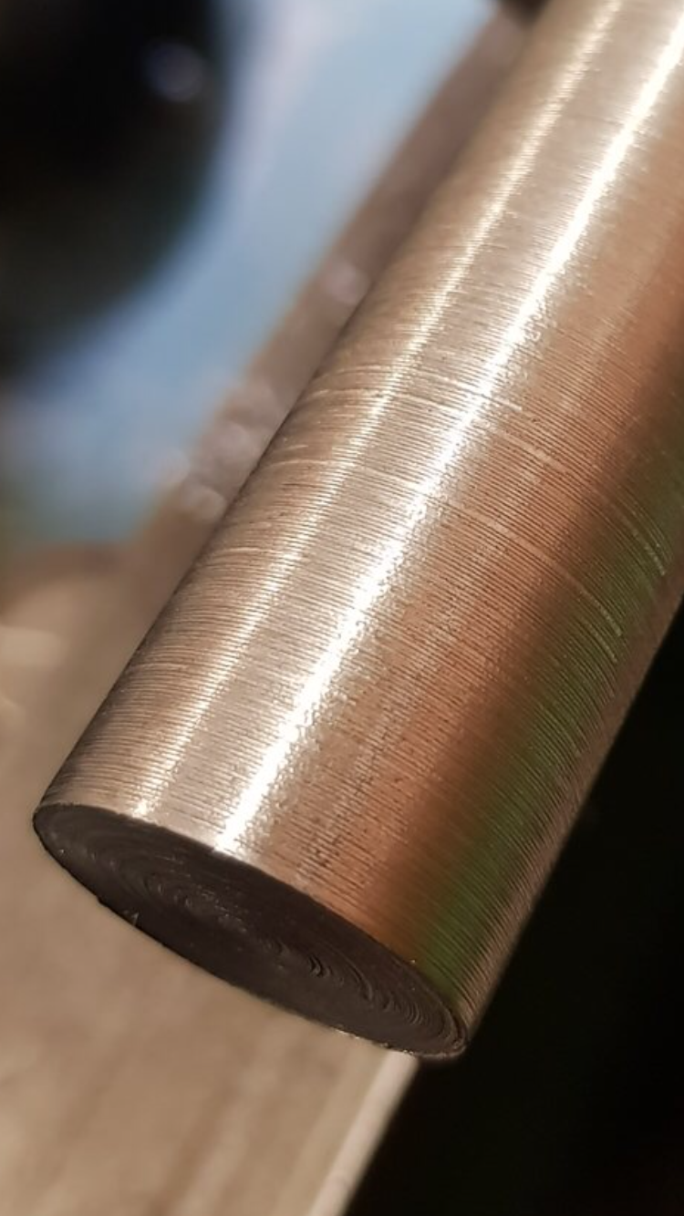

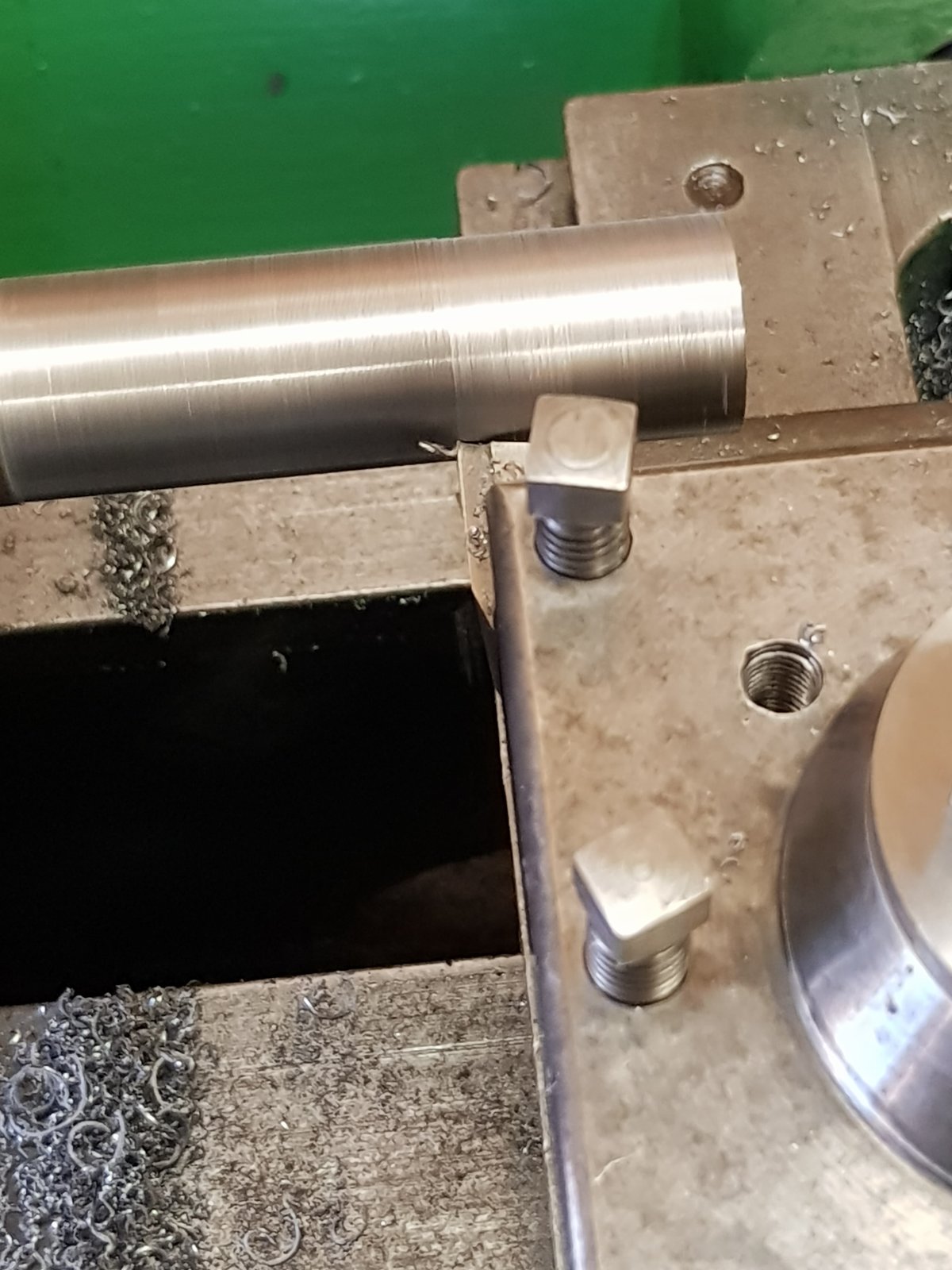

Tools are brand new. Perhaps not sharp enough. I was testing the back gears as I never used them after I stripped the machine .normal mild steel. Unless am running it to slowDoes the tool need a grind/hone perhaps? I wouldn't bother with back gear, that'll be too low i'd have thought. What is the workpiece, mild steel, hot rolled...?

Yes. That was the first thing I checkedIs it on the centre line of the workpiece?

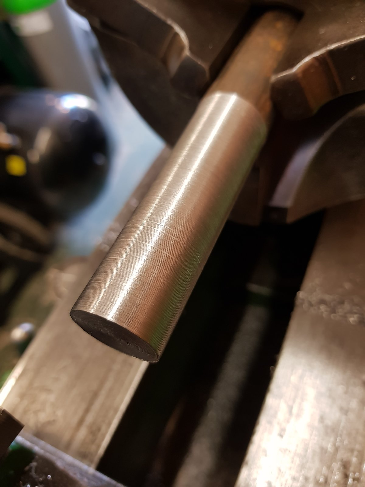

I have not tried it yet. Was literally just a few test runs. Will try that .@spencer 427 have you tryed it with a tail centre fitted at that length to seeing it will improve the finish I am no expert but am speaking from experience with my old laith

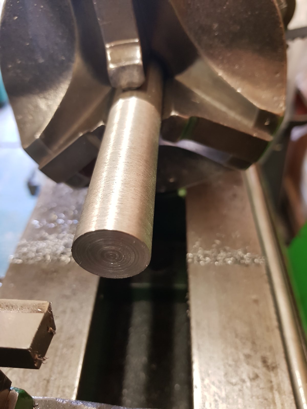

That's another thing I was looking at Richard. It's as if the apron is moving before the stock as done a revolution.I’m not an expert but I will take an educated guess at travel feed speed too fast in relation to the rpm and tool too pointy.
It almost looks like you’ve cut a thread.
The apron will always be moving but how much does it move per revThat's another thing I was looking at Richard. It's as if the apron is moving before the stock as done a revolution.

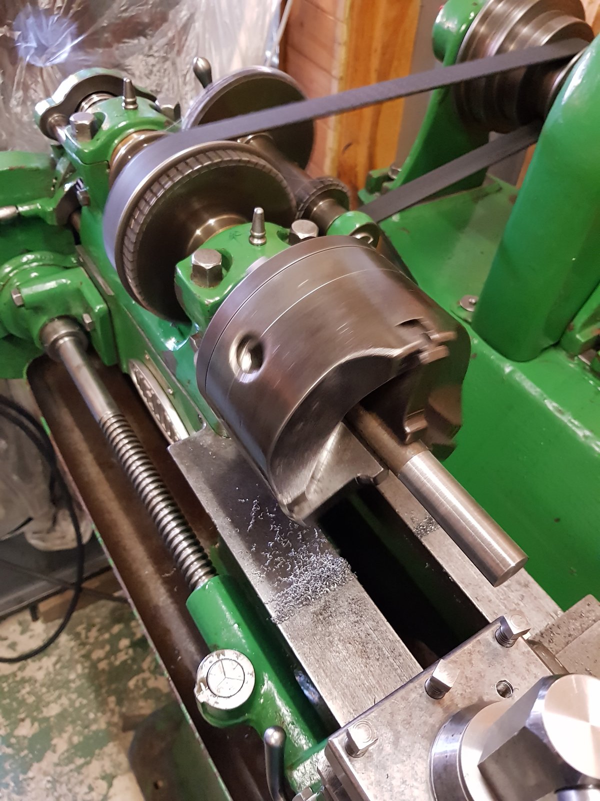

That's why I tried it with back gears.just to see what happens. Stood there five minutes waiting for it to finish it's travel. A bit to slow.The apron will always be moving but how much does it move per rev
It’s difficult to get the balance right as you need good positive feed to take your cut but you need it to remain slow enough to get that nice fine feed finish.
I will use the centre just to see. I can't reduce the travel speed as it runs off the gears through the tumbler.At 20mm diameter you want quite a high speed. You have quite a bit of stick out, id suggest having about an inch out the chuck, put it on your highest speed, and slowest feed. See what you get.
With that amount sticking out Id be using a revolving center.
Back gears are really for large items at a slow speed, so it cuts, dont forget as you increase diameter you increase surface speed. Also for screw cutting, again you dont want any slip.
To be diplomatic you are getting a record finish, often acceptable for some things, because your feed is too high
Then try running it off the lead screw in much the same way as you’d cut a thread. I think it needs reducing spencer looking at the cut.I will use the centre just to see. I can't reduce the travel speed as it runs off the gears through the tumbler.
