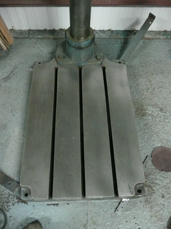

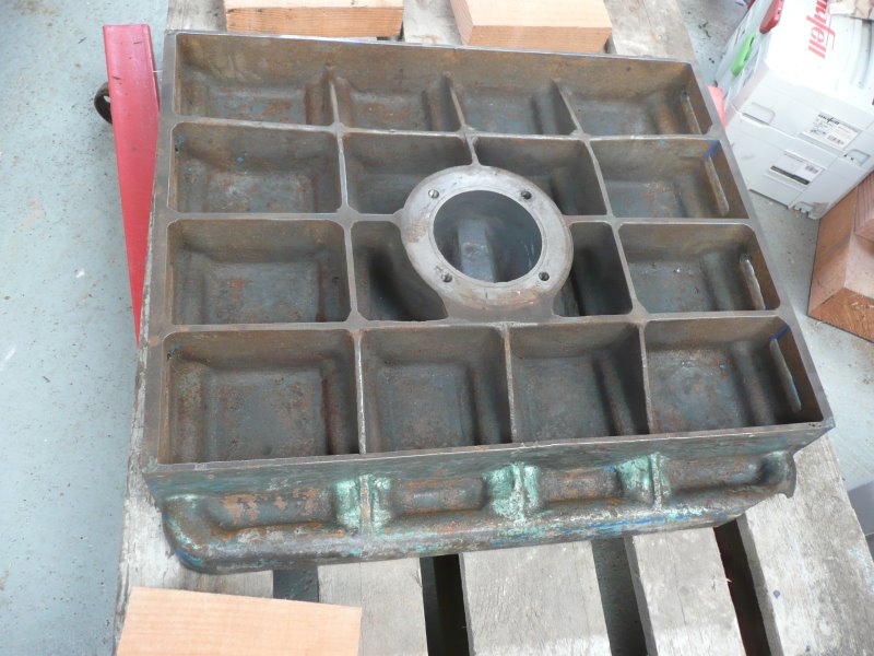

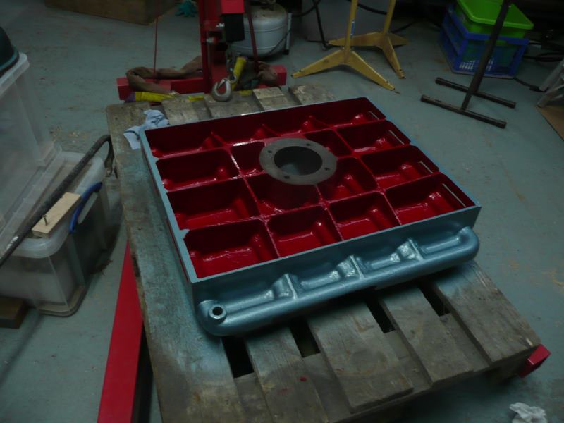

A bit more done, yesterday evening I got the table arm filled and sanded and I turned the table onto its back to de-rust and paint if I get chance this weekend. The missus is away to I'm looking after the kids so I doubt if I will get much time. Temperature in the workshop is too low for painting, just above freezing at the moment.

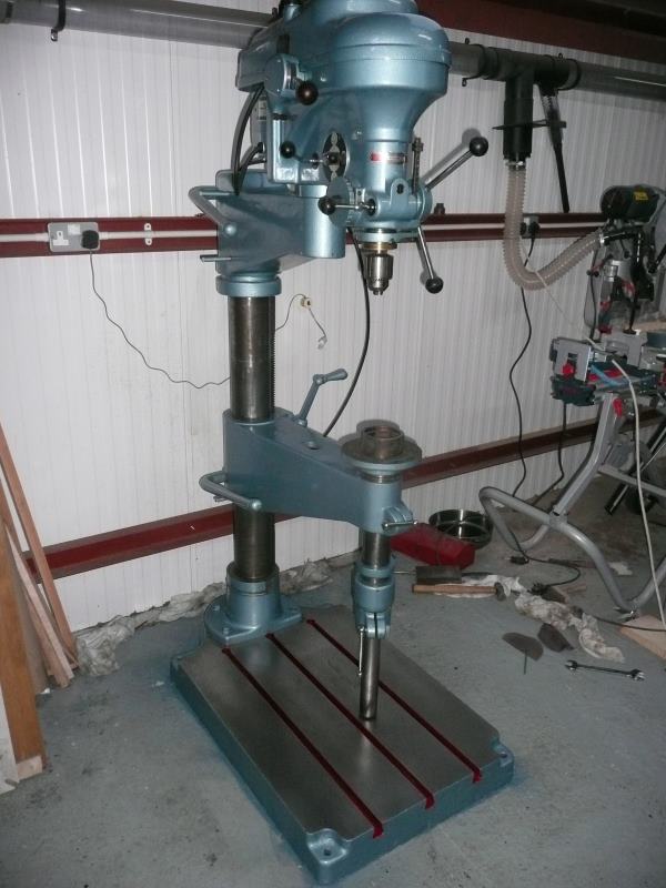

The spark has just left, I now have power to the drill and it runs lovely and quietly

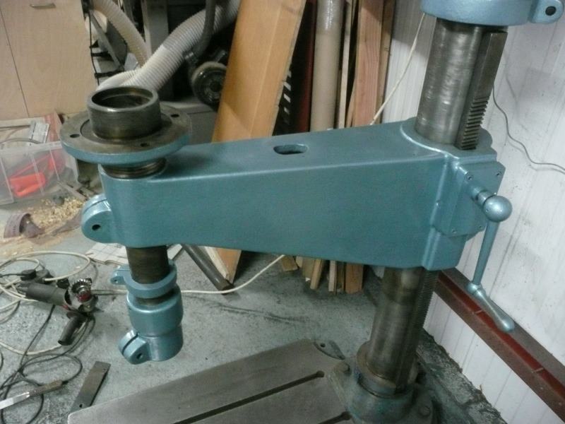

If I put the belt cover on, it does rattle a bit, which surprised as its cast aluminium. It turns out the motor pulley is just catching it at the top so I shall raise the cover slightly, just needs a couple of mm.

I'm going to wax the horizontal machined surfaces. I may use it for drilling into long bits of timber occasionally. Liberon lubricating wax is what I use on all my wood machines. Two coats with a bit of a polish then another coat every couple of months in winter or after heavy use. See my rust prevention thread, it's not perfect at rust prevention but better than nowt if it has two coats and doesn't leave an oily residue on timber. It is great on the thicknesser, wood slips through it very nicely, it helps the power feed.
Yes but most of the time it will be covered with the woodworking fence and t track so won't be seen
