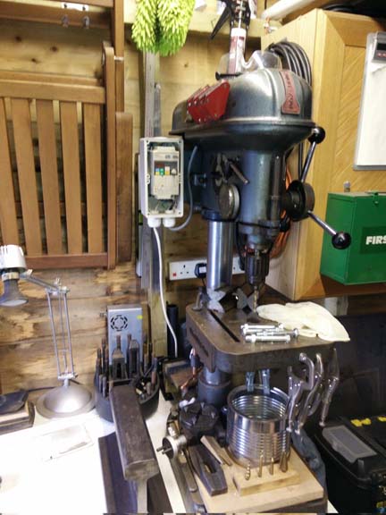

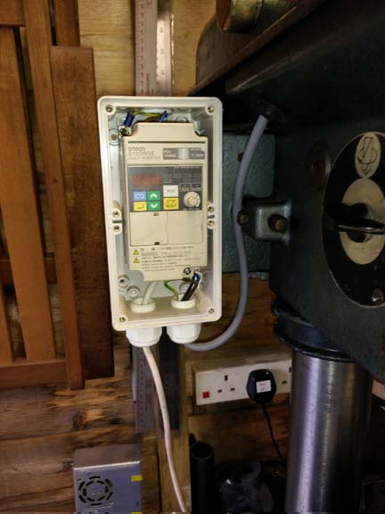

Here you go, I still have to make a clear cover for the VDF - but the stuff is there, and on the list
Been too cold [and now dark] to be outside today, I'll get some for you tomorrow.![]()
Can I trouble you for the pictures too? I am restoring a Meddings myself
That vfd box looks too small if its sealed up? Could get melty. Im near enough to the enclosure spec for mine, its taking far more premium shed wall space than Im happy with!
. Thanks for that, I'll probably make it from white plastic and drill ventilation holes [angled upwards
] in it, based on your advice.
