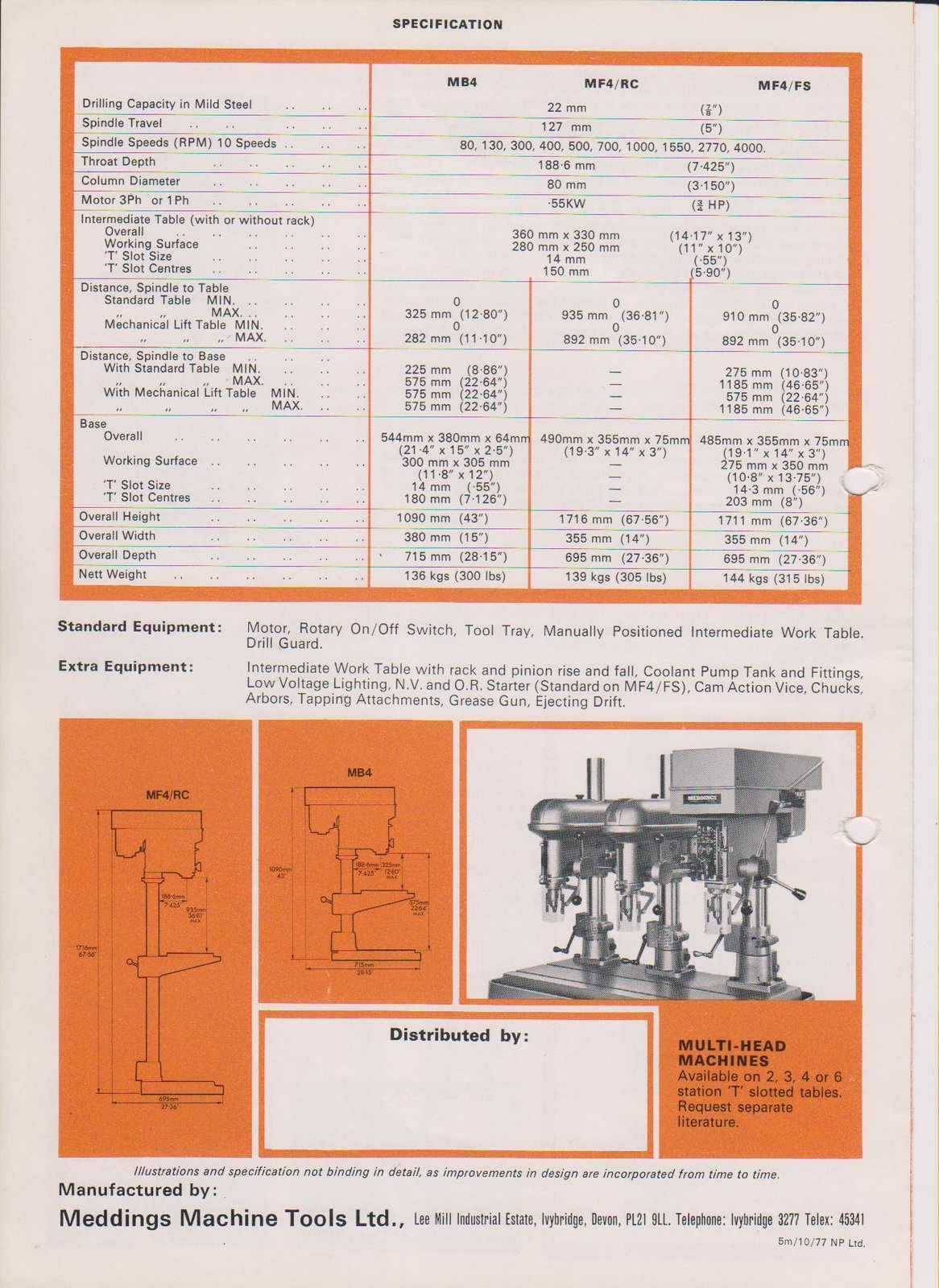

I recently purchased a Meddings MF4/3 but it didn't come with a motor. It has a flex with a main plug on it and a rotating switch with 3 positions which is not connected to any wires.
First question what replacement motor? I did get in touch with Medding who very kindly send me copies of various Medding manuals and they where able to tell me the date of manufacture (1977) but they where no help for a replacement motor or the spec to go source one.
