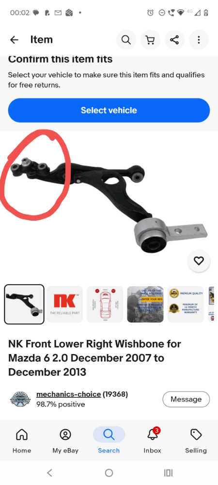

Hmm I typed arb instead of arm, is it the anti roll bar? If so, thats one of the things I poked at, and looked ok to meJust get some new anti roll bar links and wack them on rather than messing around with new rubbers.
Have a look at the bottom ball joints while you're in there as they can wear out quite badly.
Probably ok on yours if they didn't pick it up on the MOT. Use a pry bar to move the wishbone against the hub and you'll see movement if they are knackered.
Sounds like lower ball joint rather than the drop links to mePair of "repair as soon as possible (minor defects)" of both front lower suspension arm ball joint dust covers.
