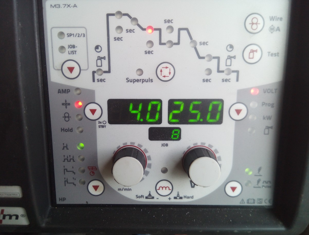

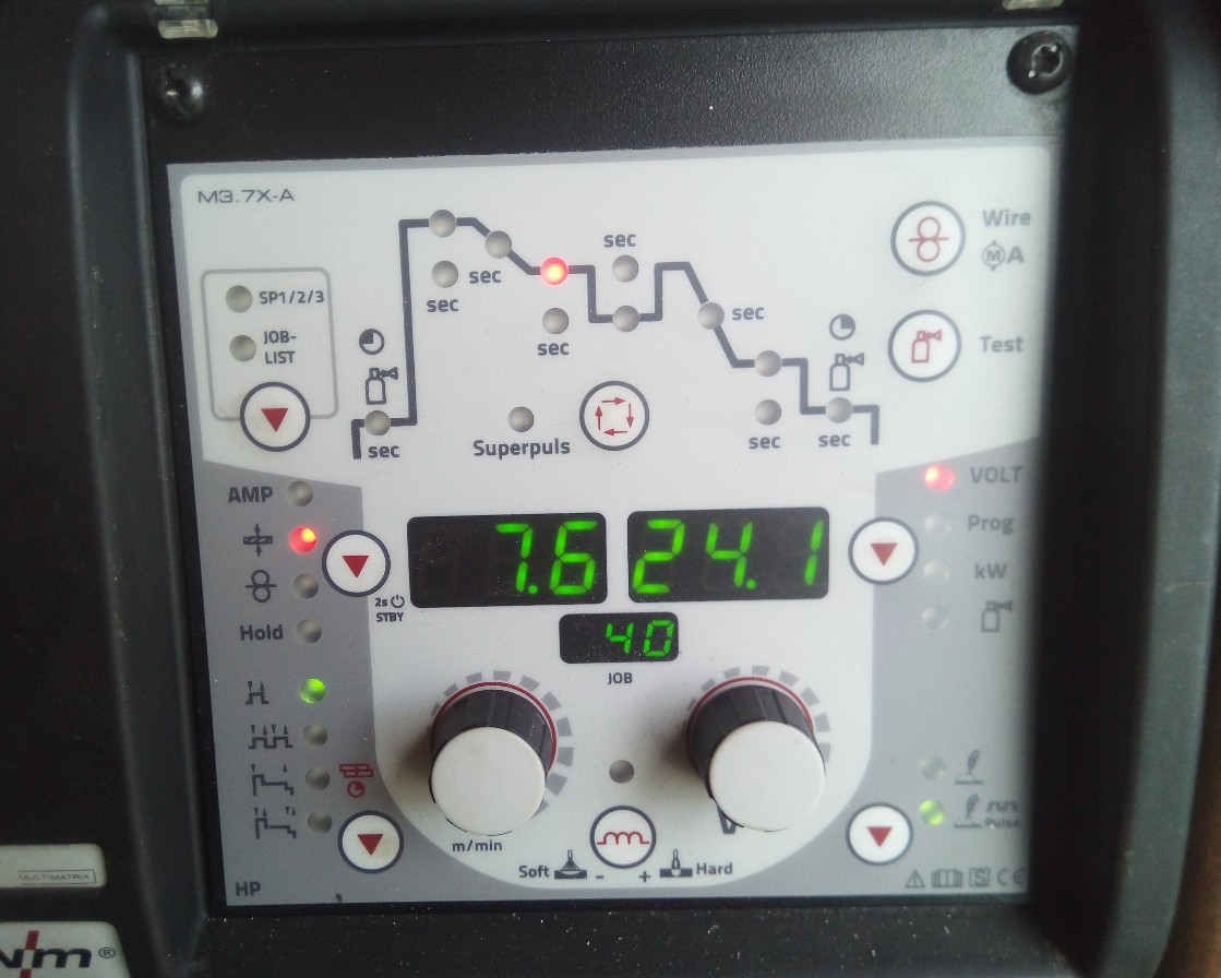

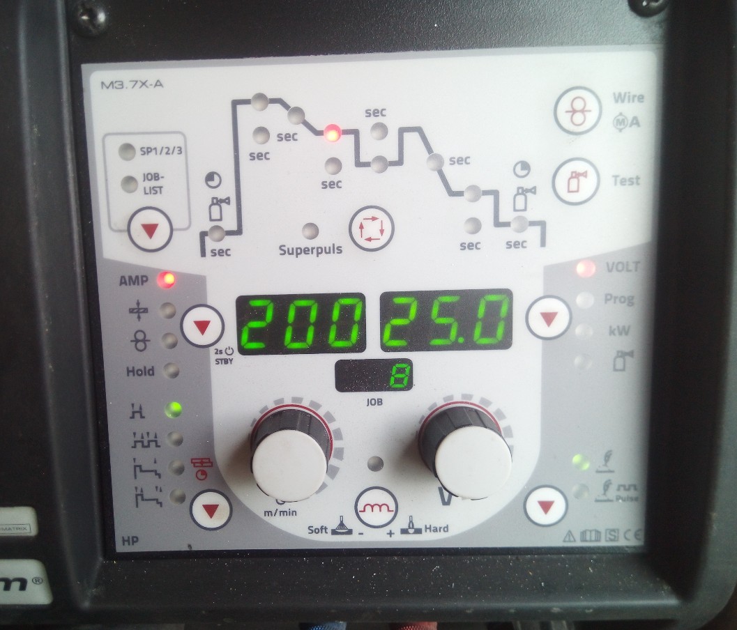

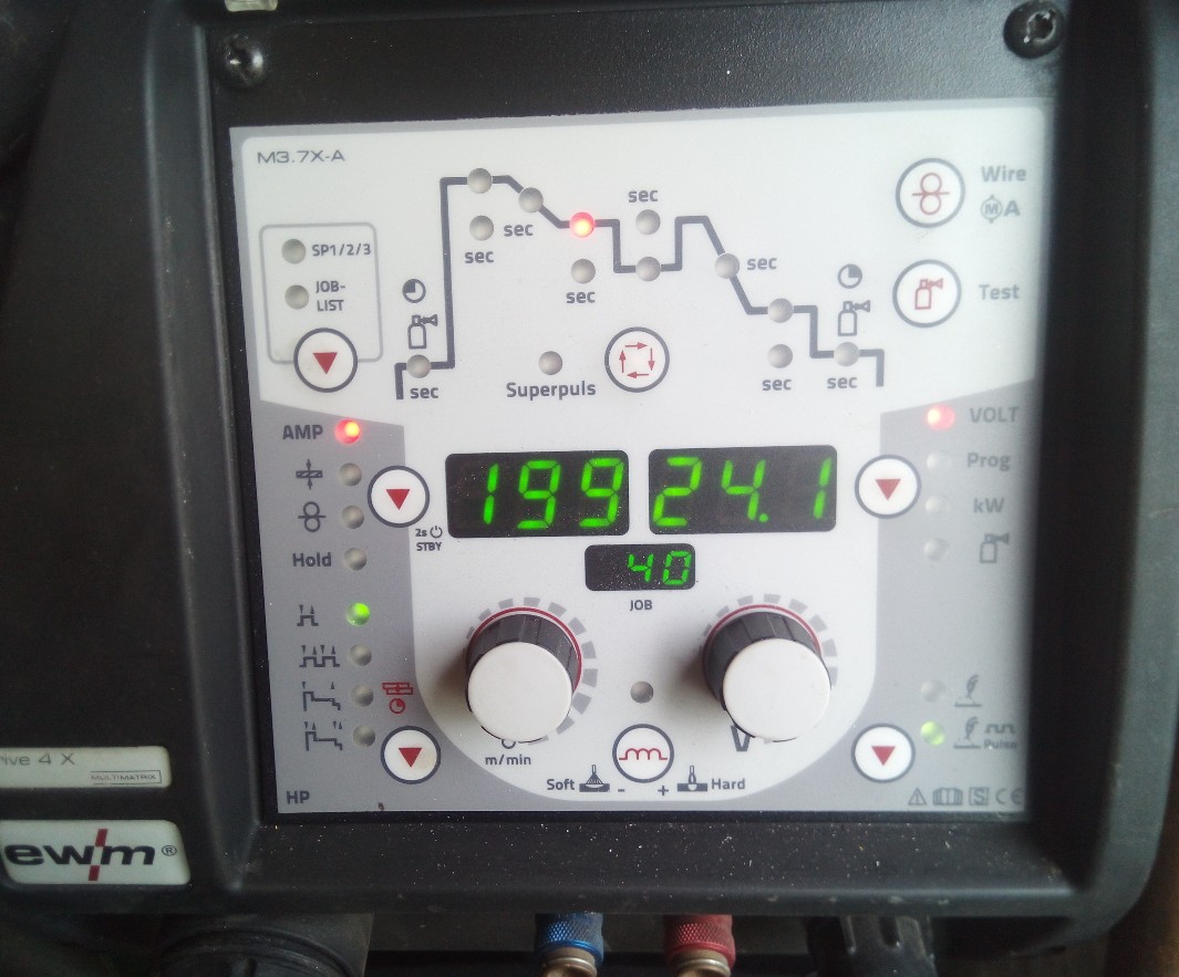

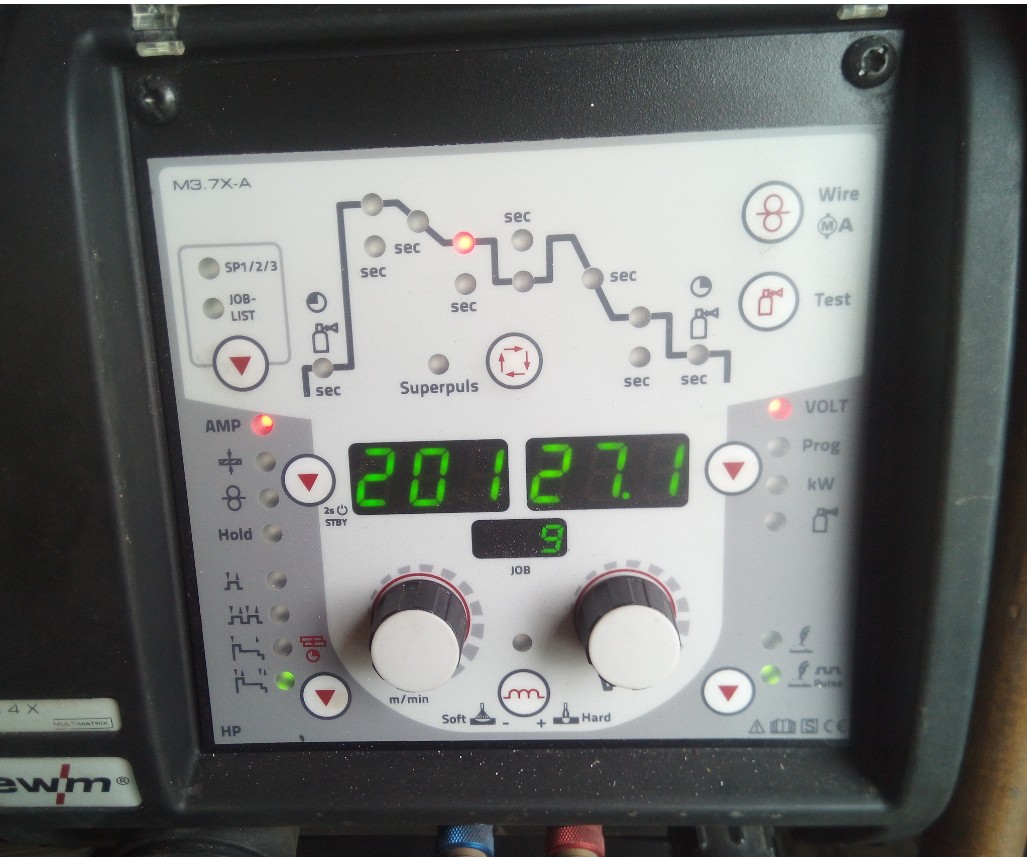

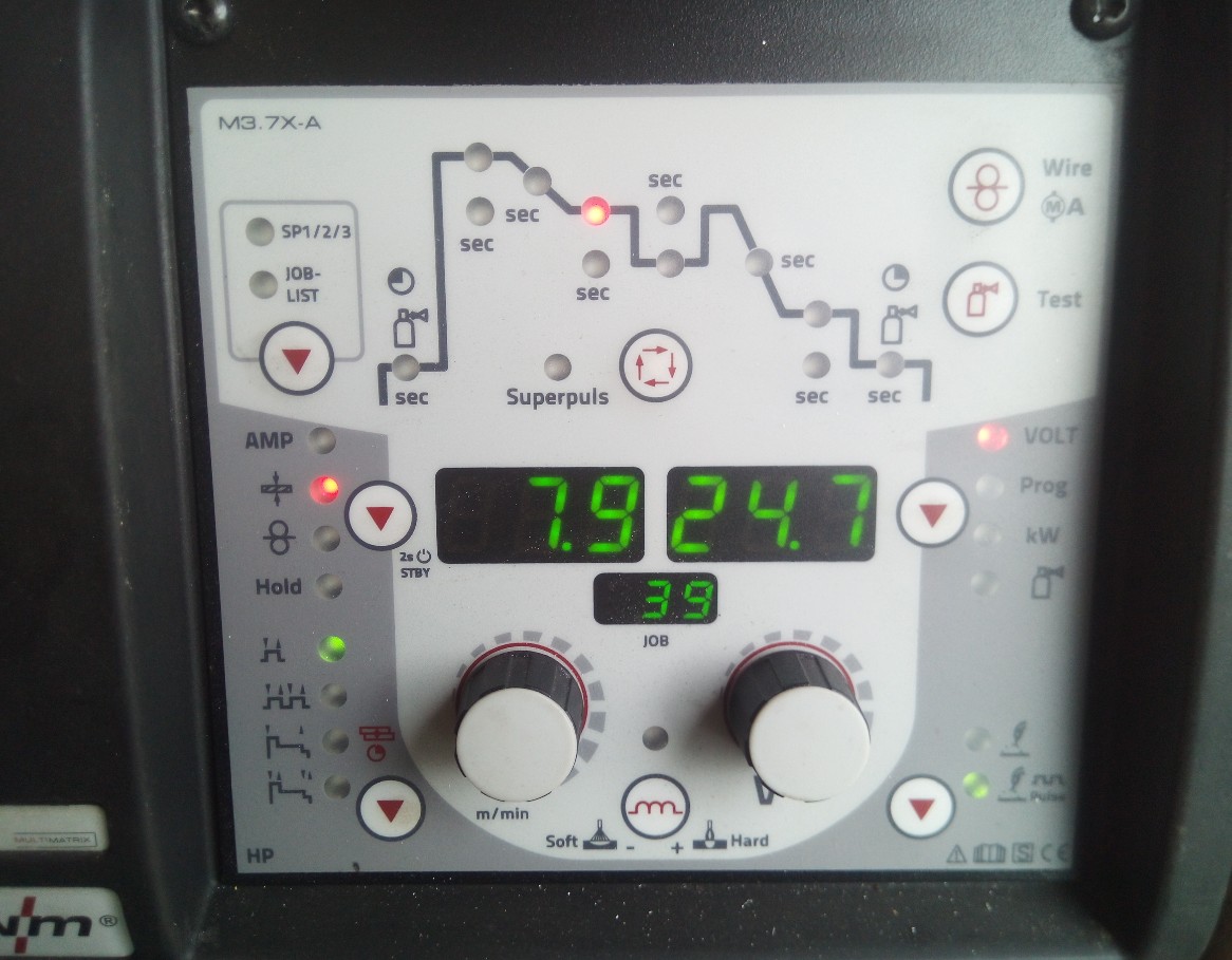

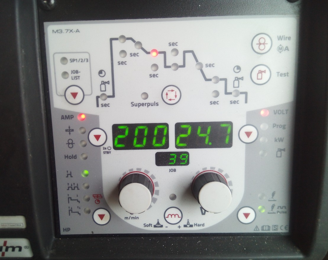

For ali i am using 1mm 5356Yes they both have synergic lines for all sorts, will check with the newer 355 as that is easier to set as the jobs are set via the dial where the older 2330 you need to choose a few different things, then again most are preselected as you alter the others.
What wire dia would you be using for steel and stainless? BTW that was 1.2mm Al/Mg in the above pictures, it will be vastly different if say a silicon alloy.
And for steel 1mm steel wire
And stainless either 0.8 or 1mm 316 grade
