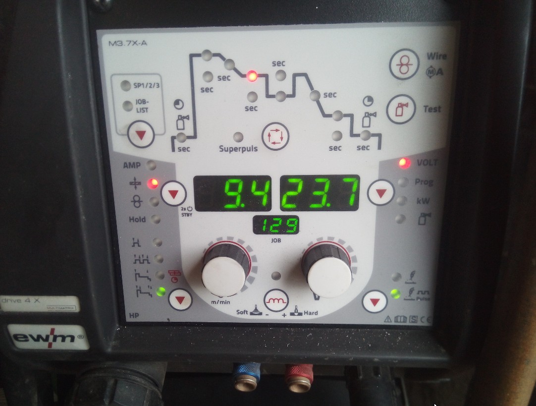

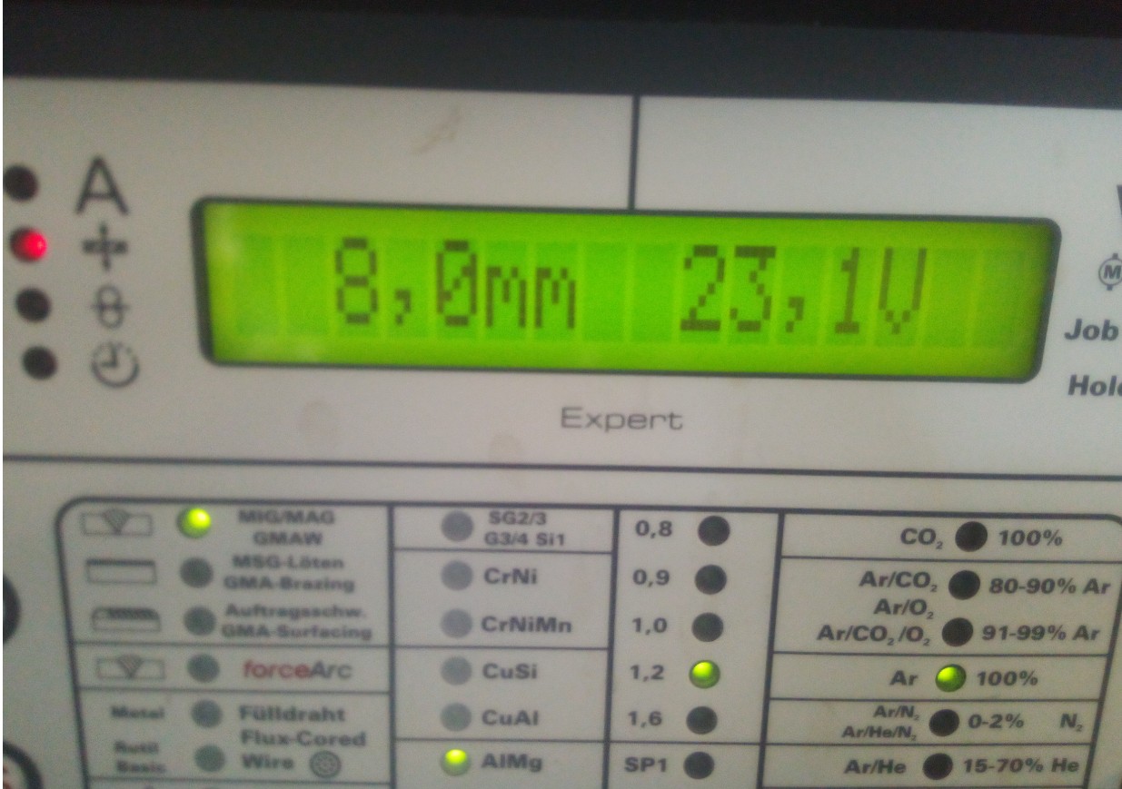

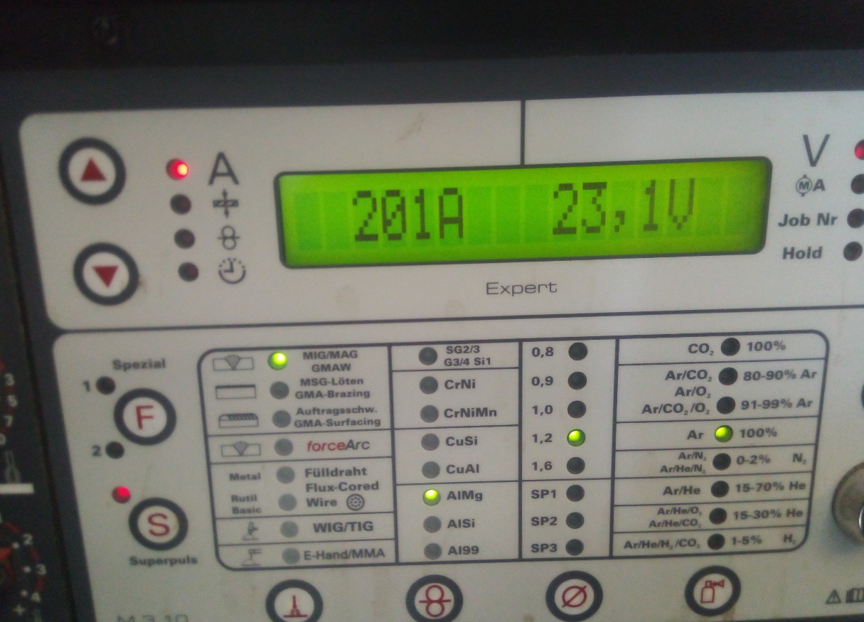

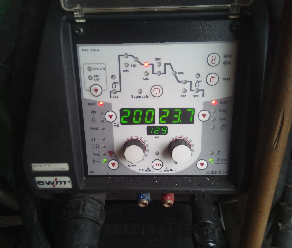

    Ok here is what my EWM's say for the synergig lines.
    EWM Phoenix 330
    Change to material thickness at the above current and it is ..
    The EWM Phoenix 355 is as follows.
    And change to thickness at the above settings and it says.
    The older 330 in the top pics I have the voltage trim at zero just because the last time I used it I was messing around with some steel and never changed the voltage trim back to what I normally prefer for Alu. The 355 has a voltage trim of 1.8v so it would be showing a lower voltage if set to zero.
