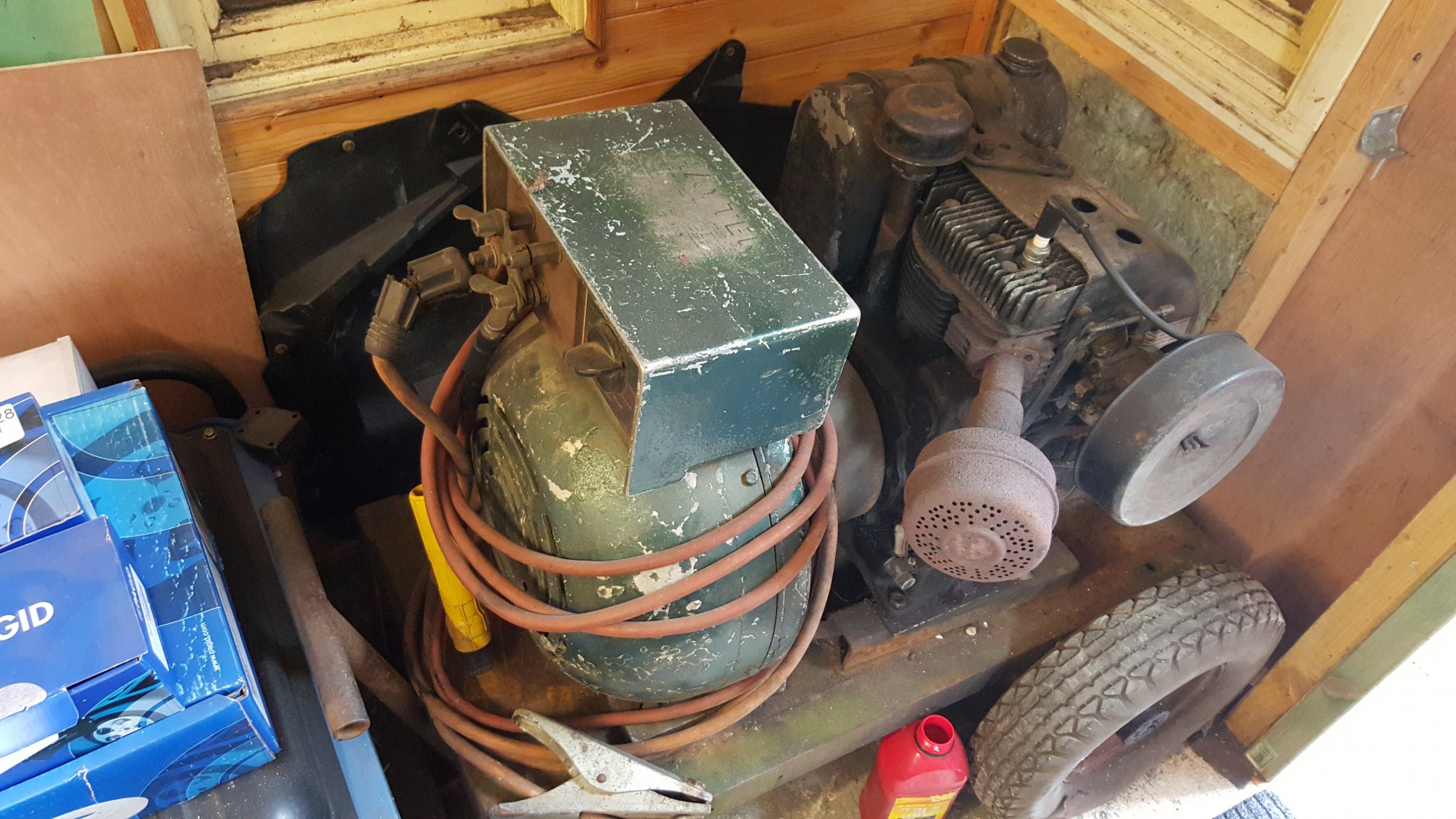

So the spike mentioned is generated from nothing, the big bang theory all over again.
Having trouble keeping up with this,
but isn't the spike caused in the difference in time between the operator breaking the arc (stop welding) and the time it takes for the governor to reduce engine speed to match the new load, resulting in a peak of high voltage higher frequency electricity. This is what normally upsets a basic inverter input side.
