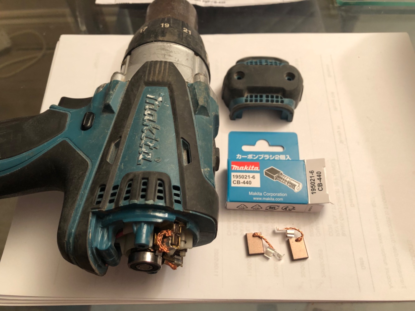

A BHP451 I bought recently. I have refurbished a couple of these before for our Men's Shed.
They are a beast of a drill and will bite back if the bit jams. If we need to use a big tenon cutter this is the one we use.

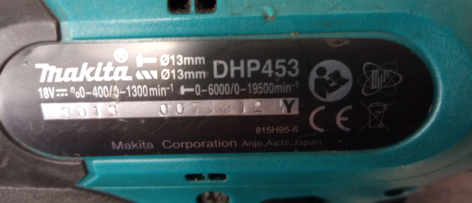

This one is mine and it will be getting a refurbishment in the future.
A bit bigger than a standard duty Dhp 453!
Regarding the rubber strips on them - they can be glued back down using super glue. Just need to degrease everything thoroughly with thinners.
