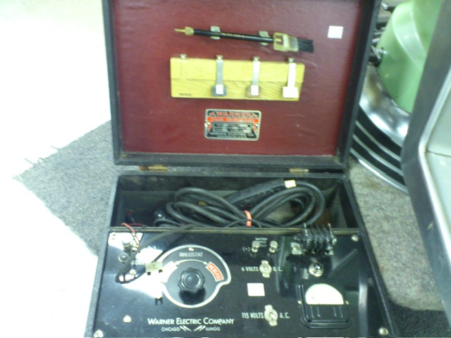

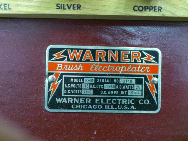

Very cool old machine!I picked up this a few years ago but still haven’t used it
