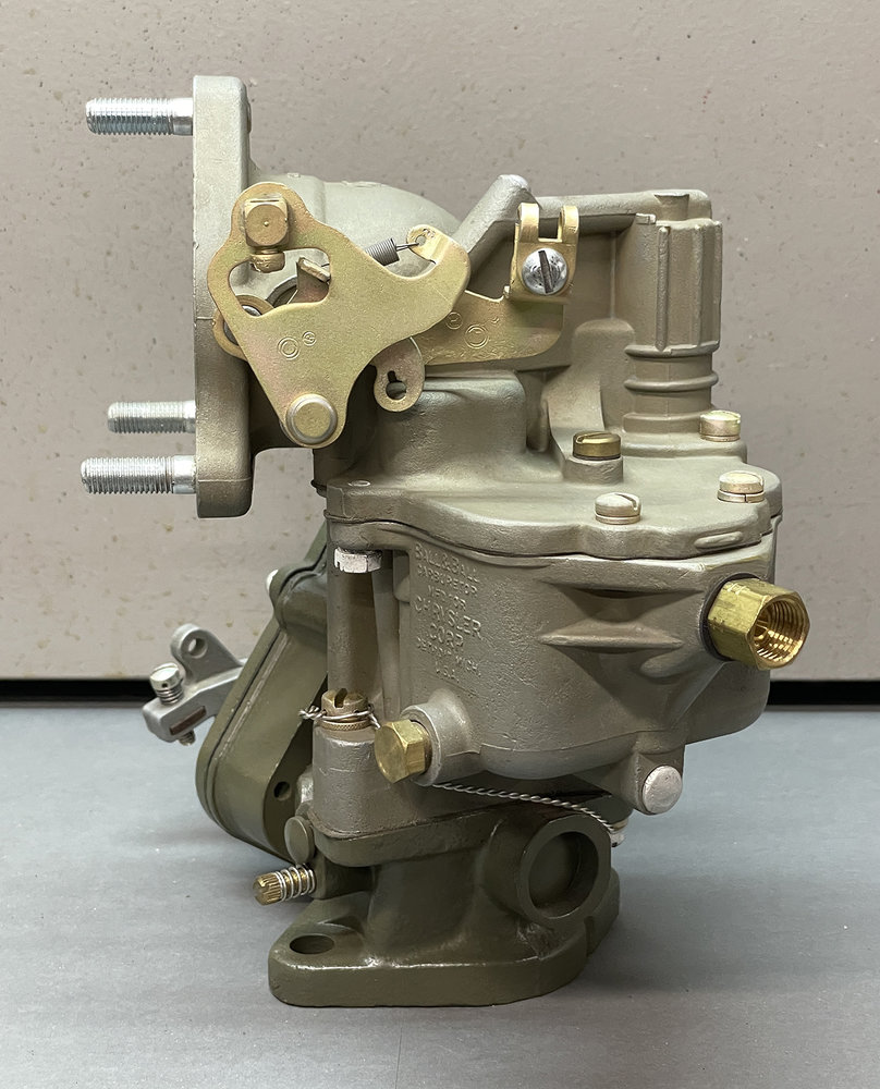

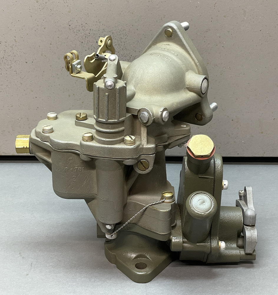

Here's an ETW1 carburetor and governor that I overhauled years ago, complete with re-plated linkage, dichromate conversion coating on the carburetor body, safety lock wire, new passage plugs, etc.

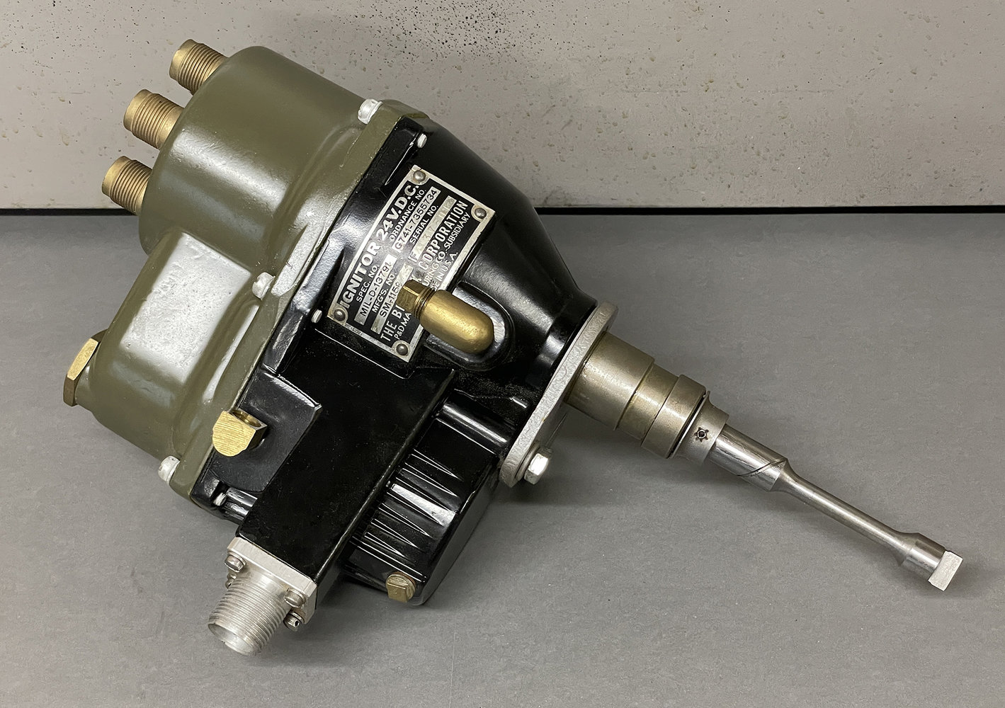

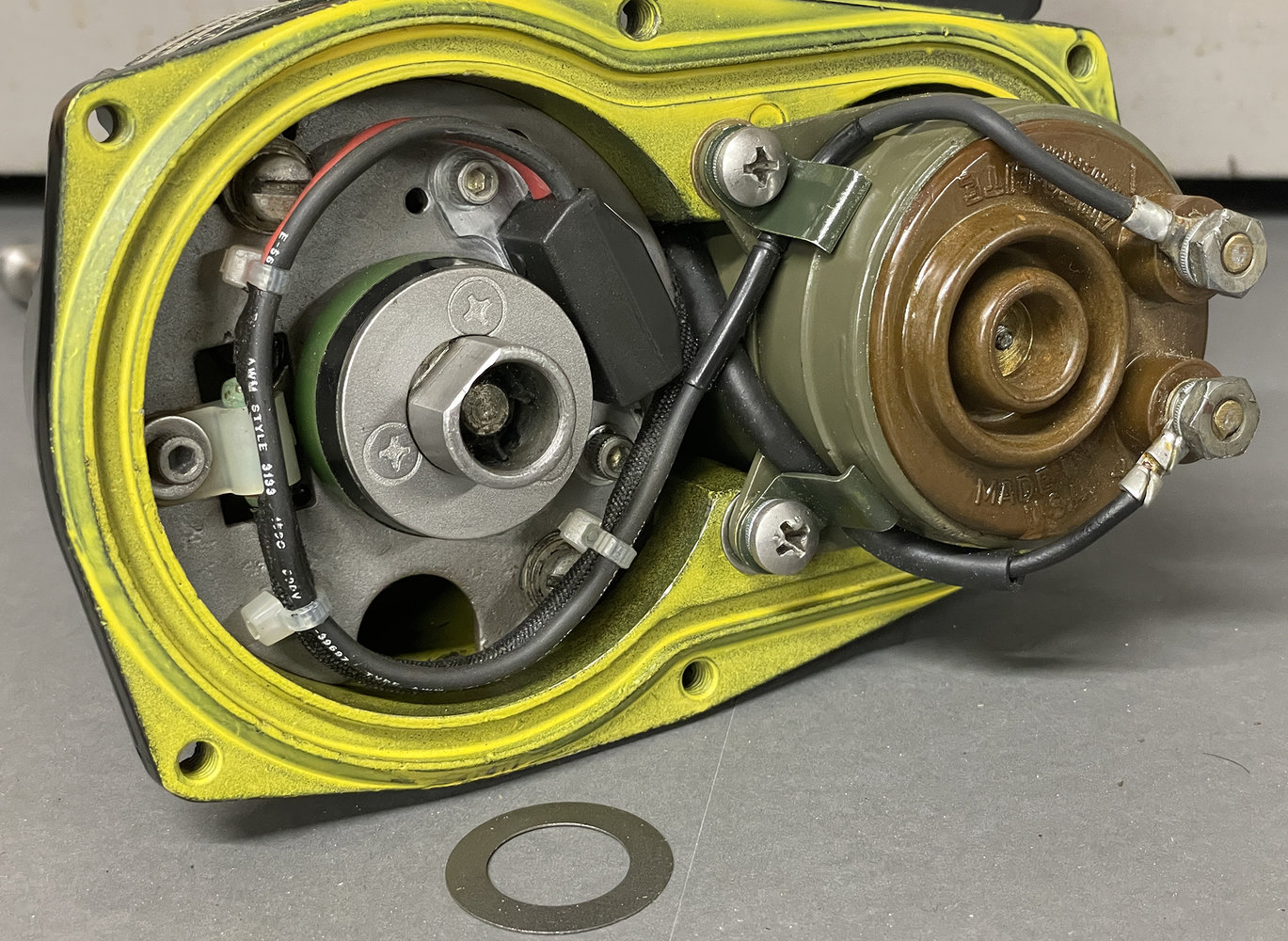

I rebuilt a couple of distributors. Here's one that I kept completely stock. These are totally waterproof distributors that are vented through small tubes for cooling air.

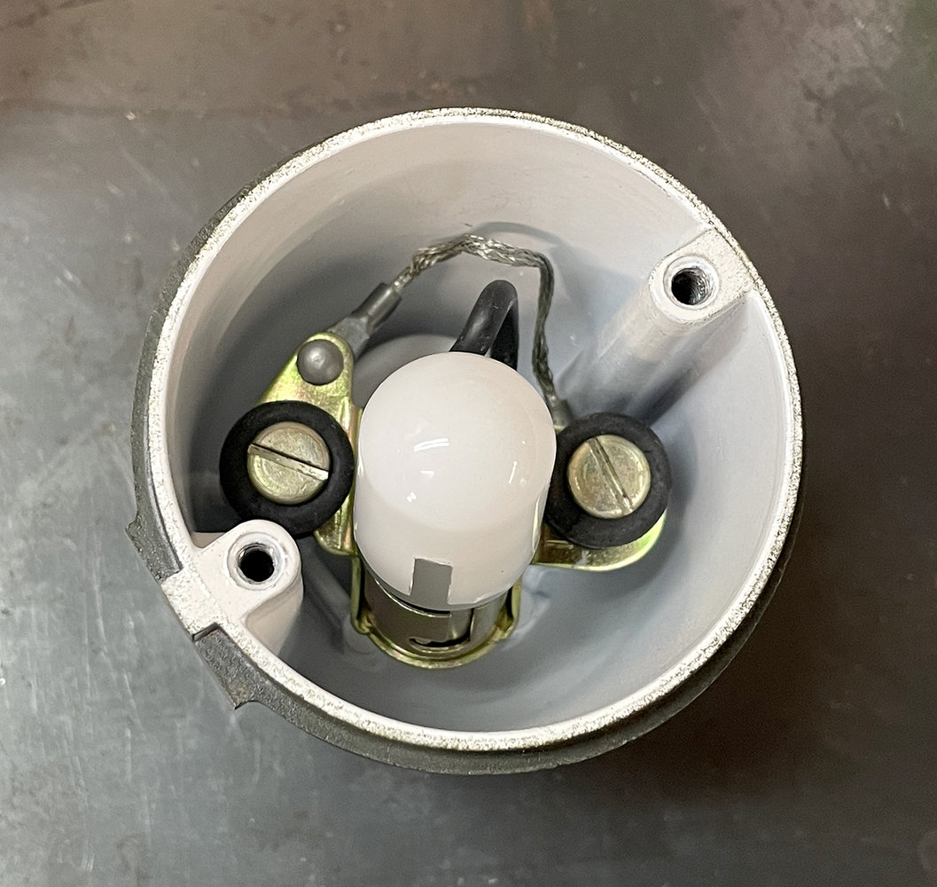

And here's another distributor that I set up for breakerless ignition with a Pertronix Ignitor. Note that I did this MANY years ago, before Pertronix offered a 24V Ignitor to fit the M37 distributor. I used an Ignitor for another vehicle, and I had to custom-mold the inside of the magnet ring to match the distributor cam and install a resistor, since it was a 12V Pertronix Ignitor that would be running on 24V. I still haven't tried it in a vehicle yet, but as I recall, it seemed to work fine on the bench.
BTW, the 12V Pertronix Ignitor and Flame Thrower coil that I installed on my 1953 Ford NAA tractor (which has been converted to 12V), is still working great! Highly recommended!
