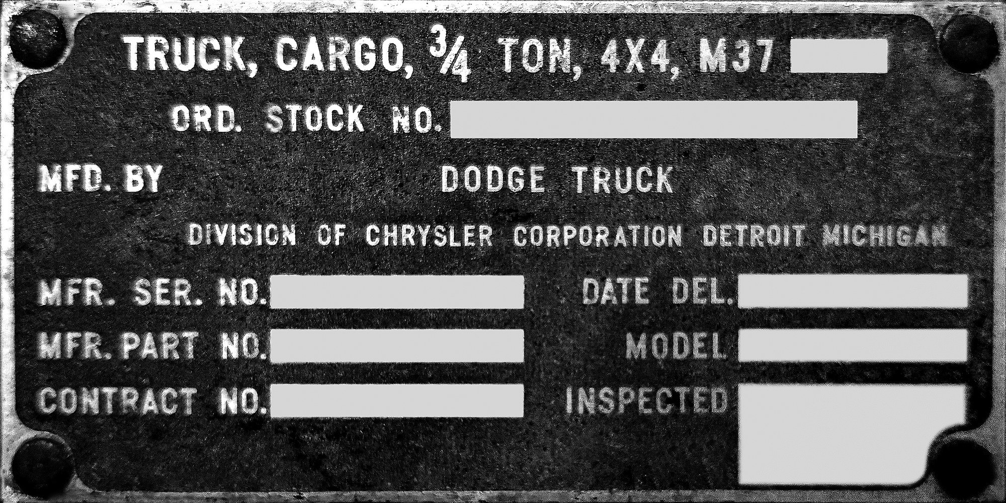

In preparation for duplicating the information from the old data plates onto a new set of reproduction data plates, I bought a set of Capris 1/8-inch number and letter stamps. They appear to be good quality, and the sides of the stamps are engraved with the characters, making them more user friendly. It would be nice to have a holder for them with some space between the stamps for easier extraction, but that's a minor detail, as I don't have that much data to copy onto the new plates. And besides, space is at a premium in my small shop, so the more compact the tools, the better.
