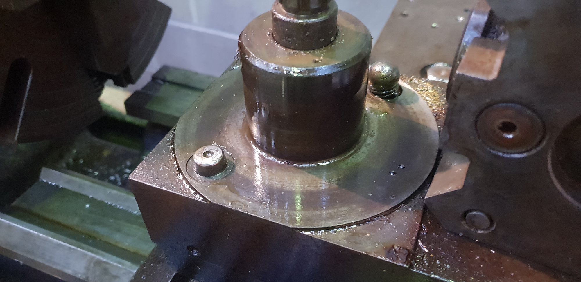

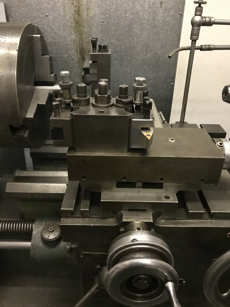

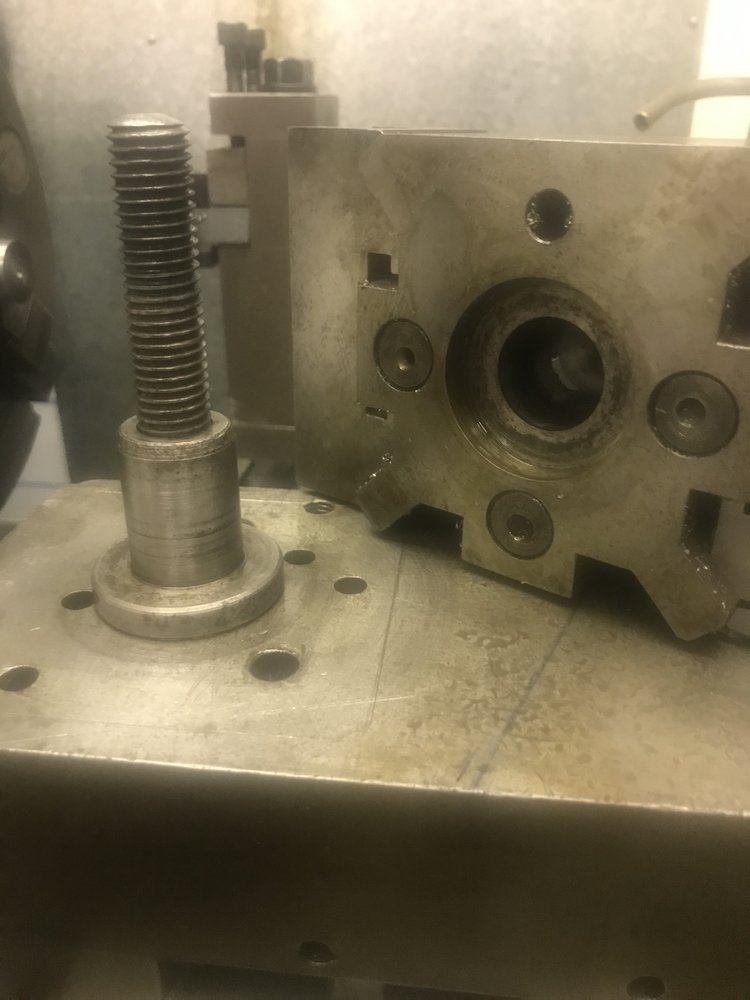

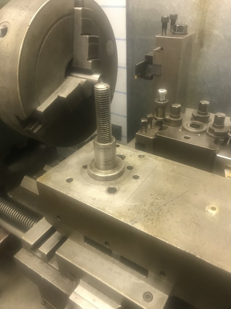

The central post with the 4 way is huge.
Does it look like the one in this manual?
That shows two style of top slide, one slotted and one solid. Neither have integral fixing stud.
It also shows the four-way indexing toolpost, and has two part numbers, one to suit the slotted slide and one to suit the solid slide (so there is not a third type of slide to be used specifically with this post).
Hence, going by the manual there, you may be misinformed about the inseparability of the parts.
