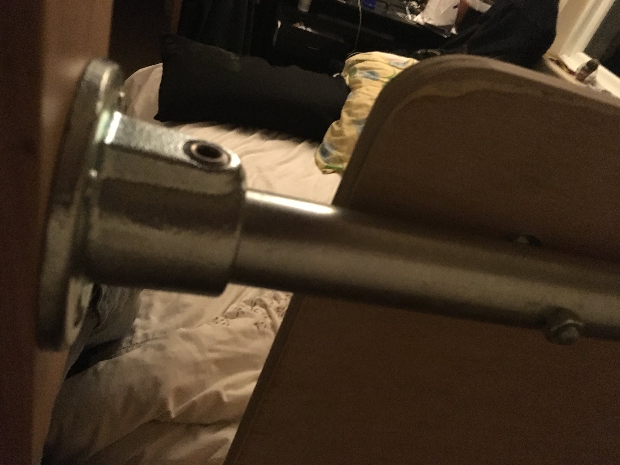

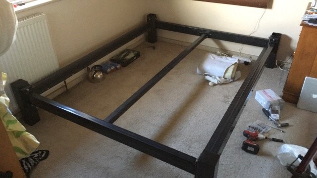

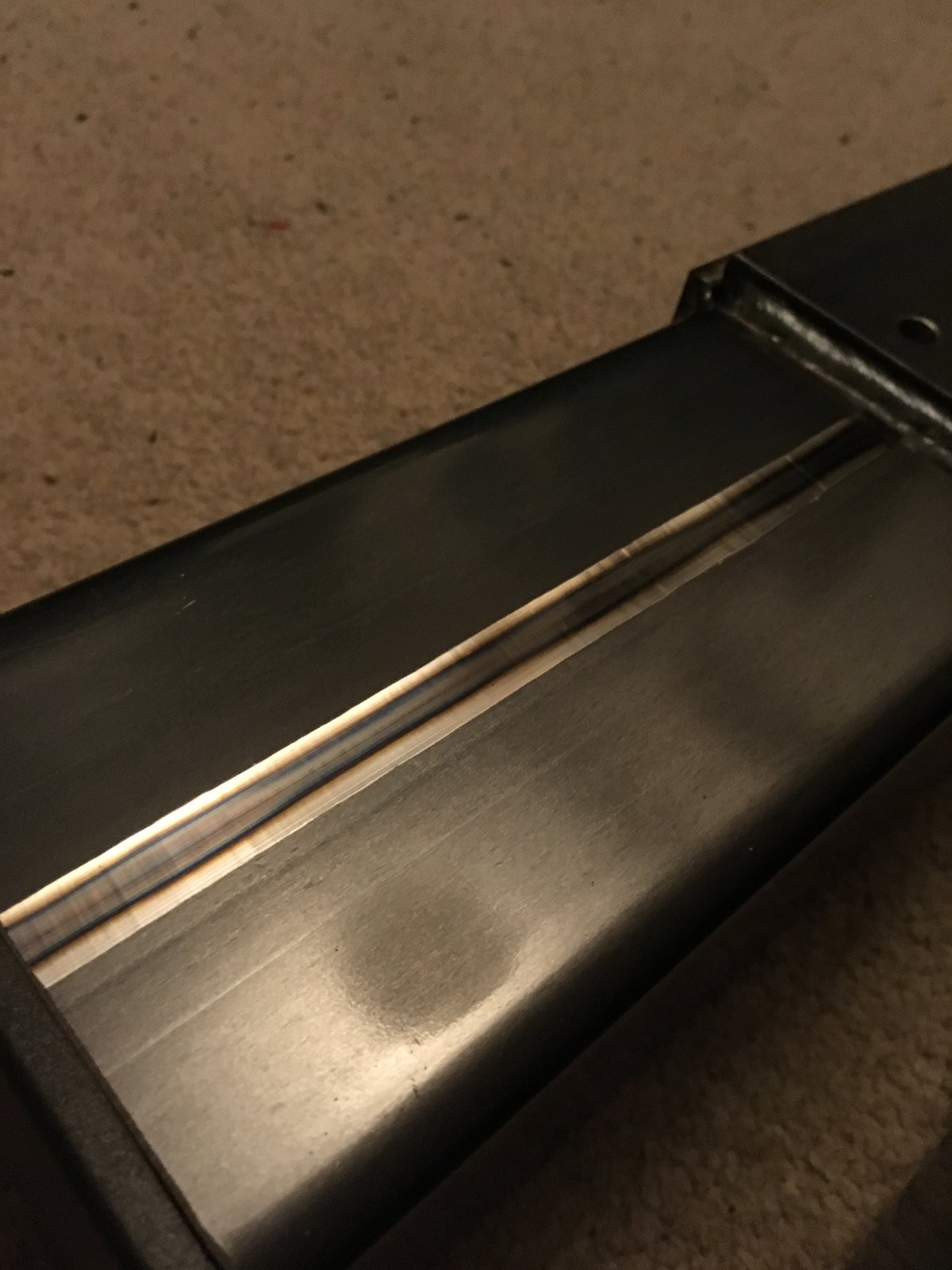

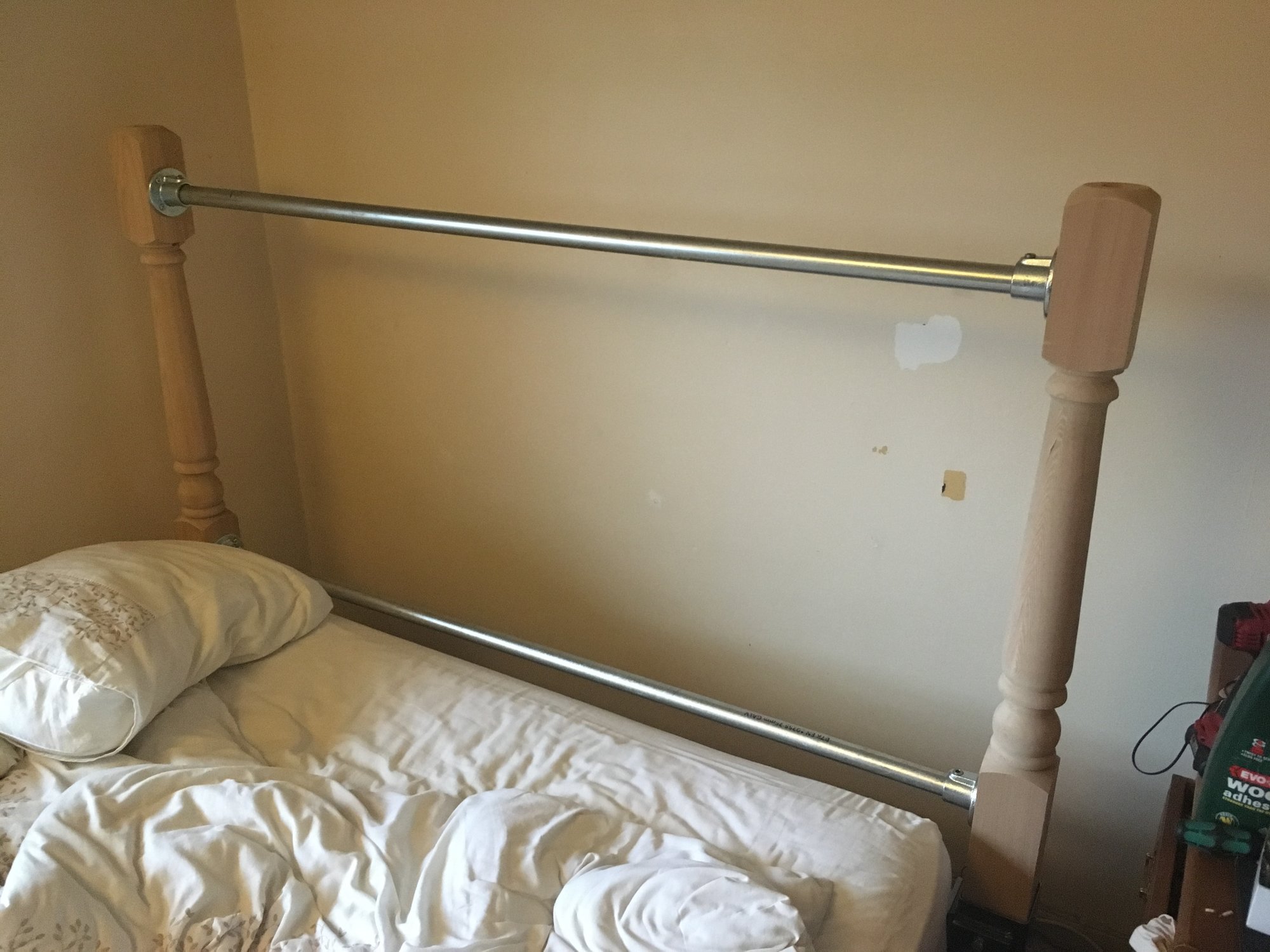

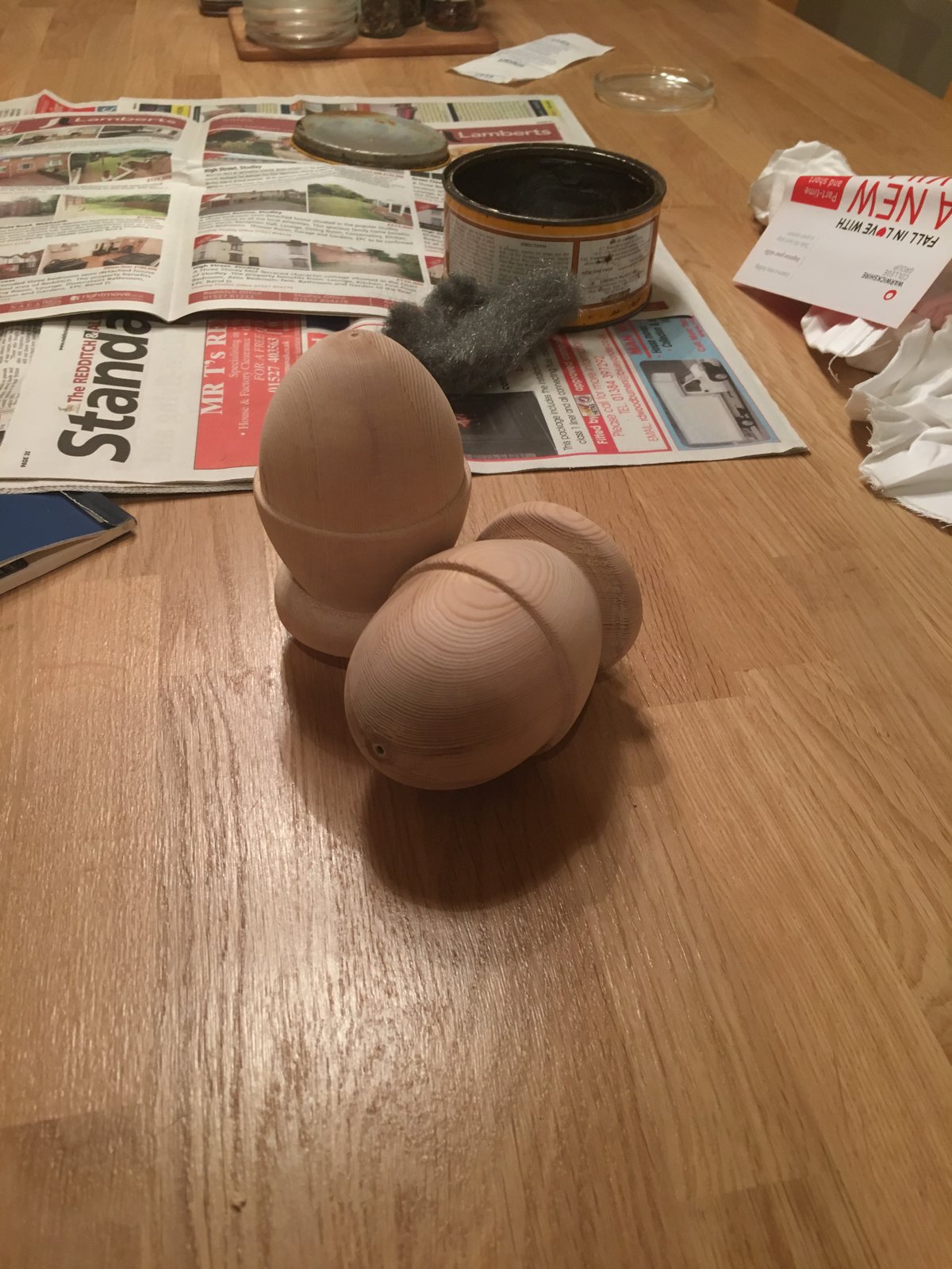

No you just need a decent furniture wax.
If you warm it enough to allow a brush to apply it to the metal it will seal the surface. 4 or 6 coats. buffing to remave excess between coats with give a hard wearing finish.
Then use the same hard wax on the wood, until you get the finish you want. Then buff all over.
It is not an easy application, but gives decent finish.
